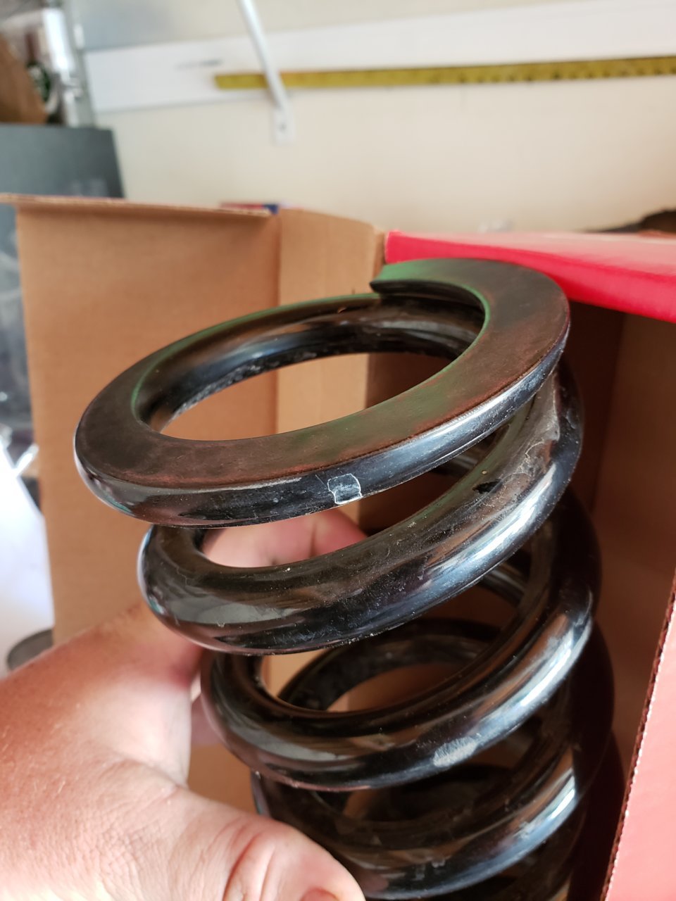

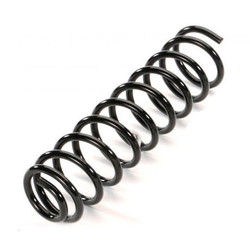

    Yeah, maybe with 5100s.
    OME springs are not recommended on 6112. 6112 coils are flat on each end. OME are round.

    Ok, lets clear this up a little. You can use virtually any 3" x 14" spring made for any other brand of coilovers (king, fox, icon, etc) that has a flat upper and lower perch rest surface. Bilstein makes a 650lsb spring, but to my knowledge nothing higher like a 700lb. OME springs WILL NOT WORK on 6112's. They will work on a 5100 though.
    Wheelers has springs manufactured for them and also carries others that will fit the 6112. See the link below. EDIT: FYI Eibach makes the majority of the industries springs and they just get coated a different color per the company they are being sold to.

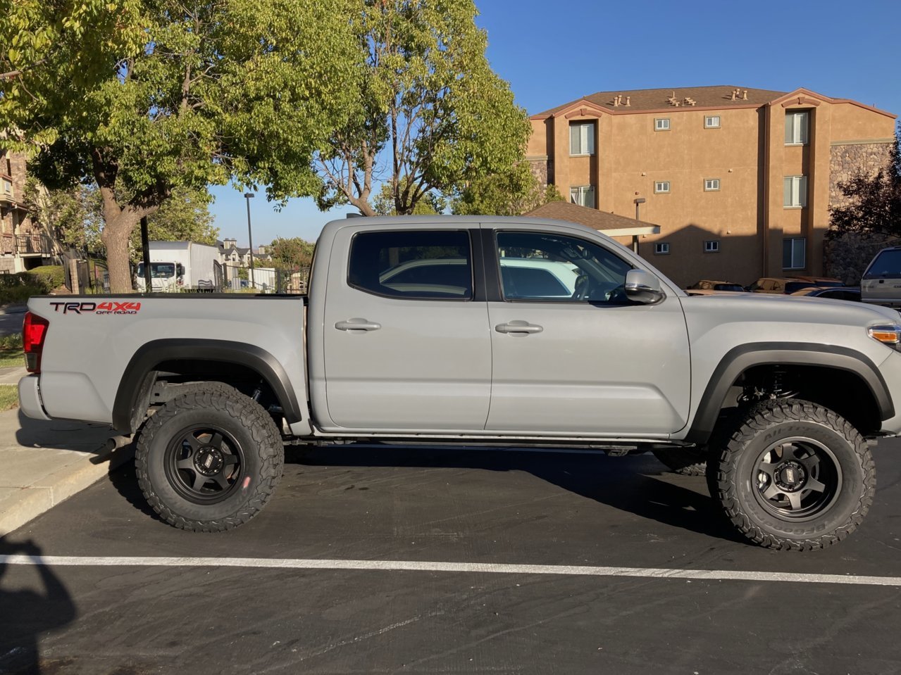

    Running Bilstien 6112 on the 6 notch both side with 1/4 inch spacer on both. 5160 w/icon 1.5 inch. Front is setting 2 inch higher than the rear. Thinking of lower the front to the 5th notch and keep 1/4 inch spacer on the driver only. What do you guys think.BBE81E38-E130-4833-8B84-1C2950504AA1.jpg

    I would follow Bilstein's instructions and set them at 6 driver and 5 passenger notch. NO spacer. Bilstein does not recommend spacers with the 6112.

    IF you ever intend to do anything where you'll be carrying weight, you'll want an upgraded leaf pack. I went through the same thing as you. Tried the AAL deal. Enjoyed the ride, hated the stance. Dakars fixed my rake and put it right where I wanted it.
    That being said, if you never intend to haul much weight around, just keep what you've got and drop the settings a bit like you're talking.
