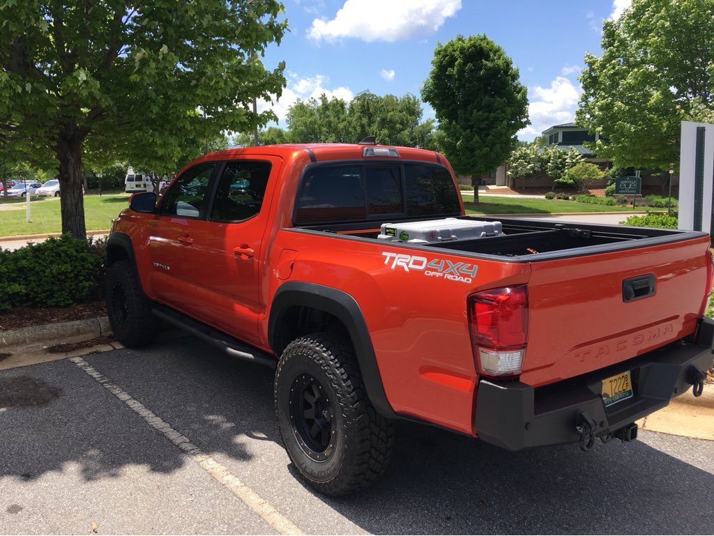

    I have had mine on for 10K miles on my gen3 offroad. Mine are set on third notch. Paired with 5100s and wheelers 3 leaf progressive aal (overload removed). Running cooper st maxx 255/85/16. I installed the first week I bought the truck. This setup gave me about 1.75" lift on front and 1.5" rear. Still had .75" rake. Both have settled over the 10K miles. I am now getting some rubbing, especially on drivers side while turning on incline/decline. Going to go up to 4th notch this week and see if that helps.

    Love it. Did about 20 consecutive miles on a washboard Forest Service road yesterday. Even my wife noticed how well it rode. Quick recovery time on the 6112s.
