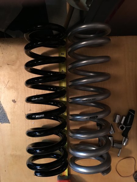

    IMG_1181.jpg IMG_1182.jpg Just for reference, the springs that come with 6112's are 14" long. Bilstein is black, Eibach 650 is silver.

    Looks Good. I have pretty much the same setup. Mine's level because I always have some stuff and tonneau on back.

    Nice. I was hoping the 650 spring was just a little longer, but its just beefier. I'd be willing to bet the standard spring is also mfg by Eibach. Just branded Bilstein?

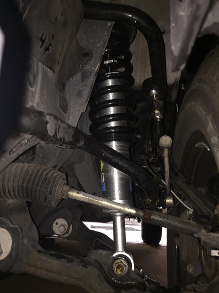

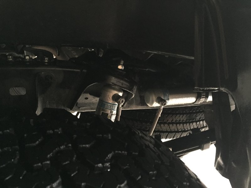

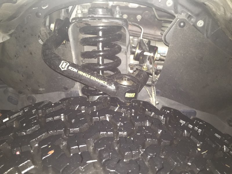

    Here's mine. I will get side shots later. 4th notch 5160, Icon UCA and Headstrong AAL.IMG_3342.jpgIMG_3343.jpgIMG_3344.jpgIMG_3345.jpg

    Im looking forward to seeing side shots of the truck. How's your rake? I bought the HS 3 Leaf AAL but decided not to install it for now. On the 4th notch I'm only slightly nose high. Sometimes dead level depending on the Surface I'm parked on. I love the ride as is and not sure I want it to be stiffer.
