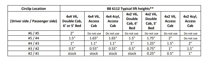

    You would be happy with 5/4. But also take into account the springs will settle a bit

    The lift was installed on July 15. Vary little settle, but was thinking the same thing.

    Does this help you with what you need to figure out? I clipped this straight from the 6112 install instructions. I have my truck set at 5&4 position and I got about 1.25in of lift over stock and the ride is still very nice! I also have Durobumps installed which do make a difference. Keep in mind tho my truck is as heavy as you can get right outta the factory with the double cab long box.

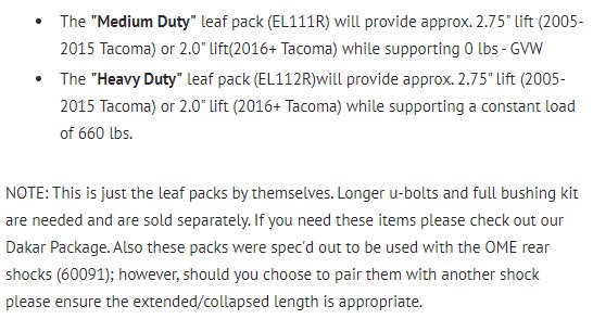

    The OME Dakar Leaf Packs are meant to be paired with the OME 60091 Nitro Charger shocks.
    From Headstrong Offroad:
    NOTE: This is just the leaf packs by themselves. Longer u-bolts and full bushing kit are needed and are sold separately. If you need these items please check out our Dakar Package. Also these packs were spec'd out to be used with the OME rear shocks (60091); however, should you choose to pair them with another shock please ensure the extended/collapsed length is appropriate.
    Shock Specifications:
    - Collapsed: 14.173"
    - Extended: 23.583"
    - Travel: 9.41"
    The Bilstein 5160 actually has 1/2" more travel than the OME 60091 Nitro Charger.
    Bilstein 5160
    - Collapsed = 14.22"
    - Extended = 24.06"
    - Travel 9.84"

    @CemenTRDgen is correct. The new 5160's are made to support the medium dakars being the same articulation numbers as the ome rear shocks made for the dakars.

    How long did it take yours to settle? I'm well above the 1in for 4/3 right now but I've only put 250 miles on it.

    The settling is going to play on a numer of factors, if you have an ac, a dcsb, or dclb, weight put in the truck and so forth. I have a dclb at the 4th setting but I have a 2nd gen and it took about 500 miles to settle in nicely.

    I am not sure the mile count but for me it was a good 4 to 6 weeks before they really settled in. That included wheeling trips and dd to work and back in SoCal. I did notice how much stiffer (although not bad) the front was before they really settled in. Now with less pre-load since they are not maxed out at top notches the ride is super smooth yet still stable. For the price I do not think the 6112's can be beat.
