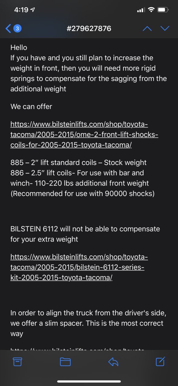

    Do you need the Taco lean spacer with the 6112's? or is setting the drivers side on a the next clip going to correct it in itself?
    Do you think i should get 650lb springs instead of 600's with the 80lbs low pro bumper+winch i have on my truck?
    Looking to stay at 2". Sorry if they are some noob questions.

    I called Bilstein a while back and they told me a spacer to correct the lean will void the warranty and that their 6112's were not designed to run with a spacer. Thus why one side is a notch higher then the other. With that being said I still experience a lean to the drivers side and setup my suspension the way Bilstein directed me to. It is not a big deal for me as I do not even notice it.
    If you are going to install an 80lb bumper and a winch that's maybe 65lb then yes you would want to run the 650 spring from Bilstein.

    Thanks for the info! I was curious because some vendors online im seeing will add the option to add the "lean spacer" to the kit (like Headstrong), and then other vendors do not give you that option at all, so that was throwing me off a little. Kinda figured it would be achieved from the clips but had to ask.
    I've had the bumper installed for almost a year now without the winch. But will be adding the winch eventually. Front OR suspension's starting to feel pretty clapped out @ 60K.

    Ya with the added weight up front and if you do take your truck on the dirt it sounds likes it's about time for new suspension.
    My plan originally was to keep both sides of the 6112 at the same snap ring setting and add the spacer on the drivers side to compensate. I called up Bilstein to see if this was a good idea and they told me NO! They said their suspension was not designed to be used with any kind of spacer and that the snap ring setting would compensate for the Taco Lean. I followed their directions and I am still getting about .5in lower on my drivers side. I do not notice it at all but if I take out the tape measure I can see the height difference. Bilstein also told me that if I chose to add a spacer any kind of warranty they offered would be voided.
    As far as the 650lb spring upgrade is concerned. With the current setup you have you would be right on the edge of needing to upgrade to the heavier spring. I had about 60lb on the front of my truck with the 6112 included 600lb spring and I did not notice any kind of sagging. Once you get the extra weight of the winch in there you'll be happy you got the 650lb spring. Keep in mind the 650lb spring does add .5in of lift height however that should be just enough to offset the extra weight you have up front. You might find you'll have to play around with the snap ring setting after all the frontal weight is added and the 650lb spring is installed.

    E-paz is a second gen unlike you. Second gen 6112's are to be set to the same snap ring setting on each side. Third gens can be staggered from side to side to compensate for lean.
    @E-Paz 732NJ I have your same bumper and a winch. 3rd setting on Bilstein 650 springs should get you to 2 inches.

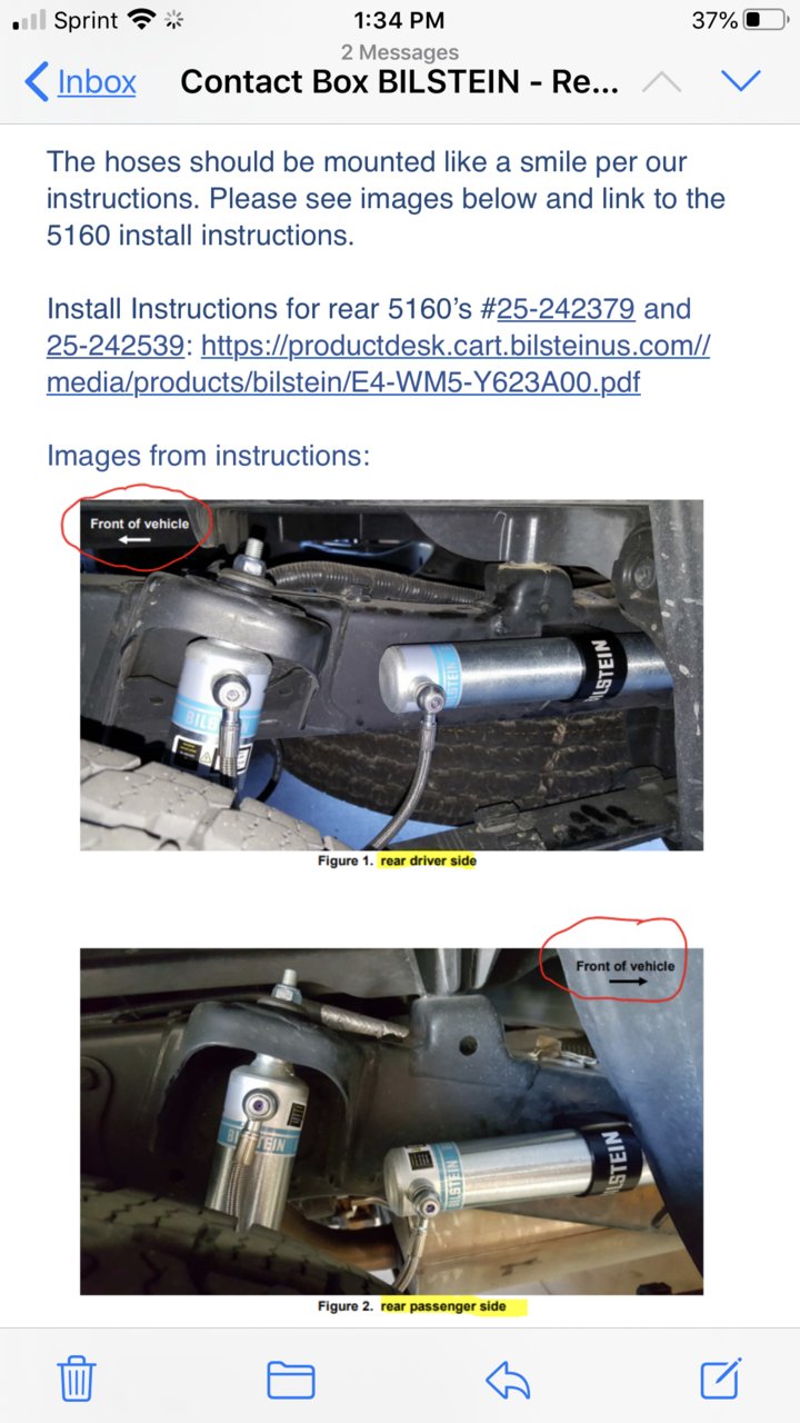

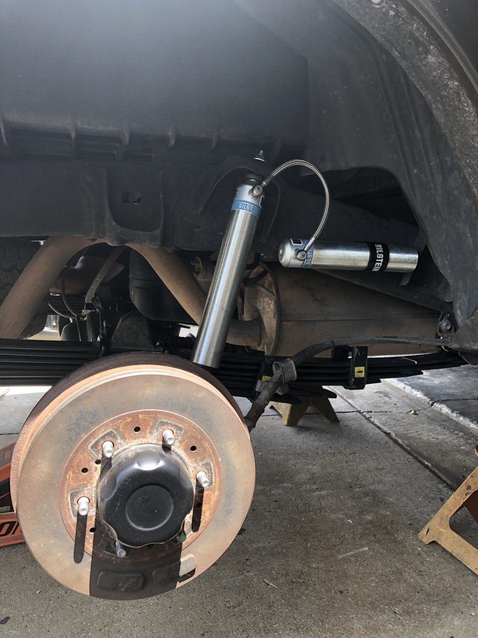

    Seen many pictures of the rear reservoir hose facing downwards making a smile just notcied that mine are facing upwards making a frown, does it matter what way they’re facing? Sorry for the newbie question. I tried looking at the install directions, unless I overlooked it I didn’t see it. Picture for reference FD6F035A-3725-44E9-8542-D5BDD43C3327.jpg

    It will not matter if the hose is facing up or down. The oil will flow back and forth due to pressure.

    Thanks for your response, I always like to get two opinions so I emailed Bilstein too. This is what I got: AFD11081-C535-4C40-80D3-97415A5B9CD4.jpg Is it as easy as unbolting the reservoir and just flipping the hose? Thanks!

    Yes.
    Do not unbolt the hose from either cylinder.
