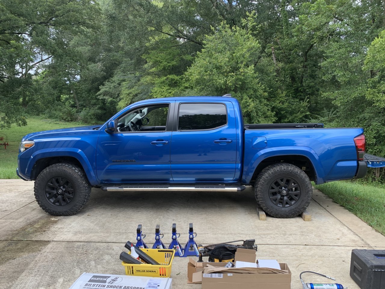

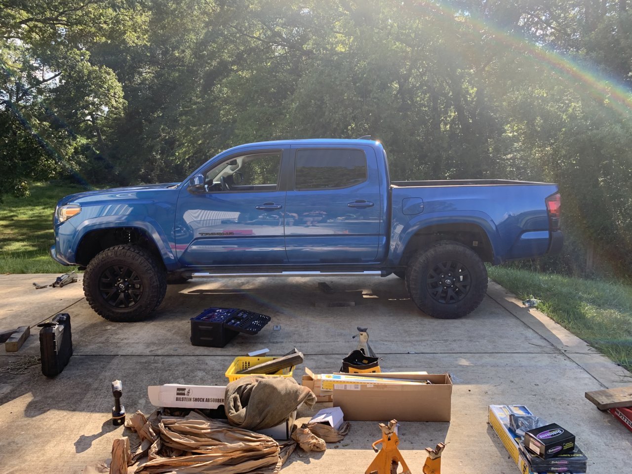

    6112s finally on. Set to the 6/5 setting. 5100s in the rear with an AAL

    I have my in the same setting 6/6. It was stiff at first but after it 2 week its felt a lot better. Also after week the height drop about an 1in lower. Mine have about an 1.5 inch bro lean. Front higher then rear.

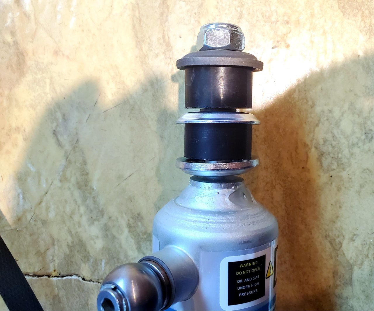

    Just tossing this in here to ask since most pair the 6112 with 5160.. I have the 6112's and going to install next weekend.
    But is this the right washer order for the 5160?

    No.
    What you want is:
    Nut
    Cupped washer, cup facing down
    Bushing
    Truck mount
    Bushing
    Cupped washer, cup facing up
    Shock
