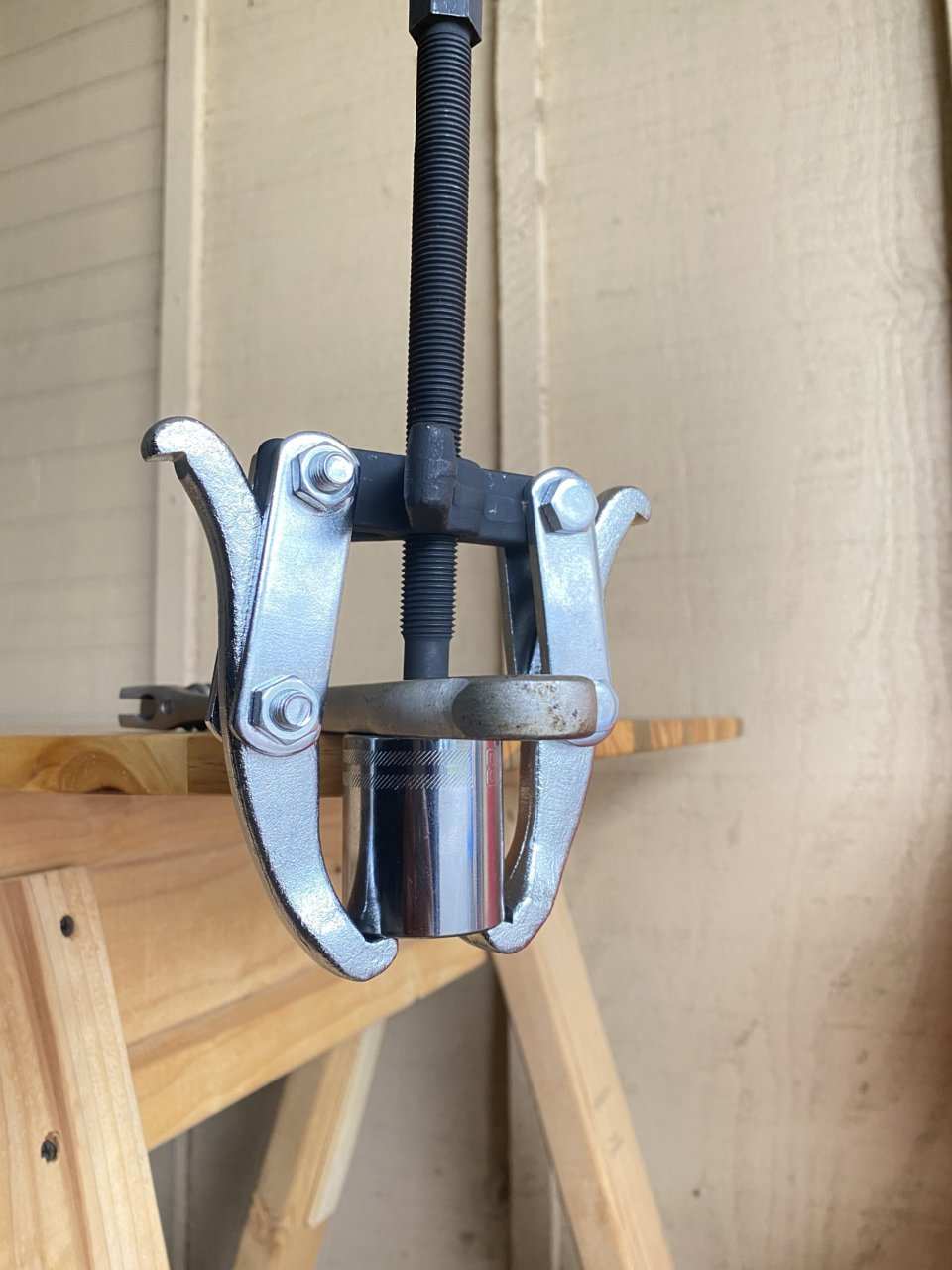

    It took a little patience to do. I used a Pulman gear puller with two teeth and a 1 1/8th socket to do the job. It fits near perfect over the bushings. I hat to use a large crescent wrench to fit over the open end of the socket to press it out. I’ll post a pic of what I’m talking about. But once i figured it out, yes, it was easy.

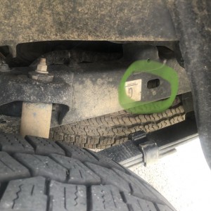

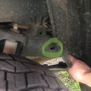

    Yeah. How are the mount's attached to the frame. The instructions show bolting it to the frame, but since there are no mount points, I'm assuming I'll have to drill the frame? Is that correct, & if so what type of bit do I want?
  12. Aug 19, 2020 at 5:44 AM
    #4072
    WZ00R2
    WZ00R2 Well-Known Member
    May 18, 2018
    #253814
    980
    TN
    2020 Cement OR
    6112/5160, Deaver U402, 255/80r17, SCS BR6
    The reservoir clamps mount to the frame using an existing hole. You simply used the supplied mounting hardware and attach them, no drilling necessary.
