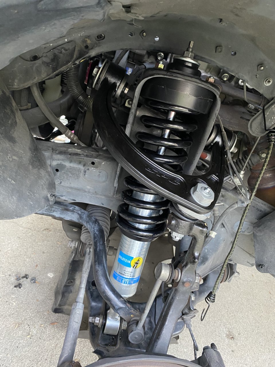

    What top hats are you running? they don't look like OEM height.

    Is that a spacer built into the spring perch/top hat? If so, and you're on highest lift setting, is that ok for the shocks when the wheel is unloaded? Seems like it would top out hard over bumps.

    Maybe some gen 3 people can chime in. I think @3/4 you'd need at least an AAL (3-leaf) in the rear without the overload leaf. Gen 2 4.0 access cab here. Based on Headstrong's site with tables comparing gen 2 to gen 3. I went with #2 both sides with spacer drivers side, chart said I'd get 1" lift in front, I got more like 1.5". It was barely level for a while then the rear sagged a bit (on new TSB leafs) looking nose high. Went with 3-leaf no overload and now have a F-R rake slightly more than stock but far better than w/o it. The chart for gen 3 says 3/4 gives you 1", I'm going to bet you'll be in the same boat.

    Not in 1000000 years. I really hope that's not what he has installed. It almost looks like some kind of weird top-hat that covers the top of the spring but that would be a first I've seen.

    It looks like the Ready Lift 6112s
