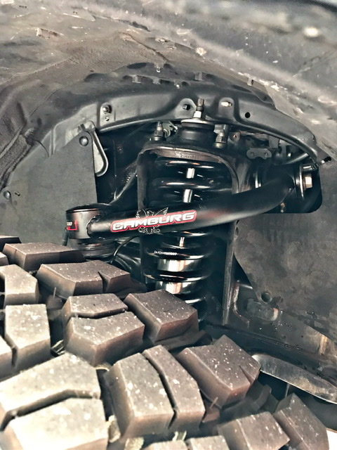

    You running the stock upper control arms?
  4. Sep 7, 2020 at 2:39 PM
    #4164
    Theclclass
    Theclclass Well-Known Member
    Jul 26, 2018
    #260632
    173
    CL
    SoCal
    2018 BLK TRD Sport 4x4 DCSB
    Camburg UCA
    edbritt15[QUOTED] and irayfz6 like this.
