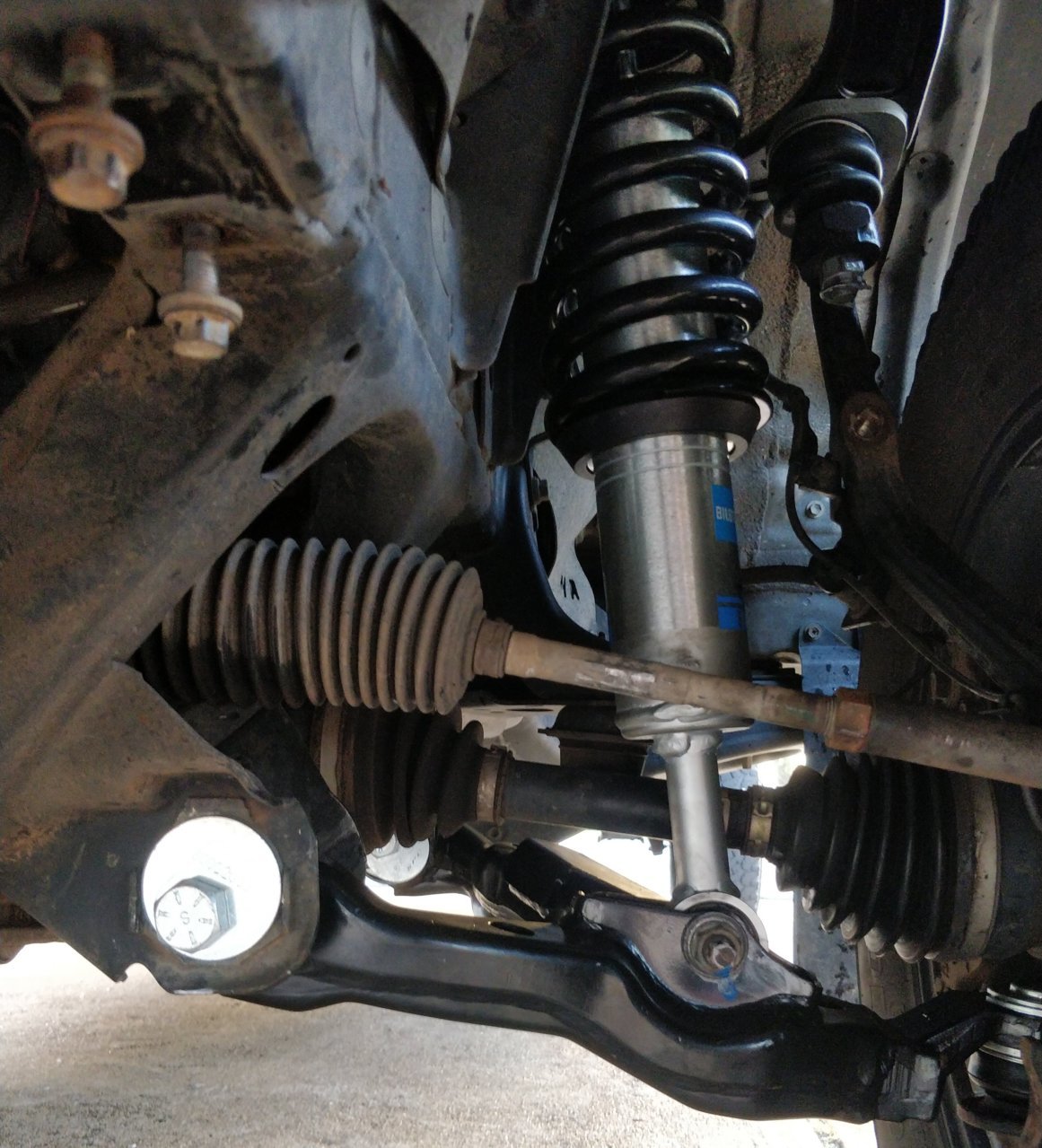

    Completely rebuilt my suspension the other week! Installed my 6112s on the 3rd notch with 650lb springs, SPC UCAs, & Precision LCAs in the front, 5160s & OMEs Medium duty Dakar leaf pack in the rear. Ended up getting ~2 3/4" lift all the way around. If you're using my post for reference, remember I have an access cab! They tend to get a lil more lift than DCSB or DCLB. Ride feels & looks great. Really happy with how it came out! Now just need some bigger tires...
    Just started my build thread if you're interested: Uncle Al's 2020 Apocalypse Taco
    Quick link if you just wanna see the suspension install in more detail: First Upgrade: Suspension
    Before & After:

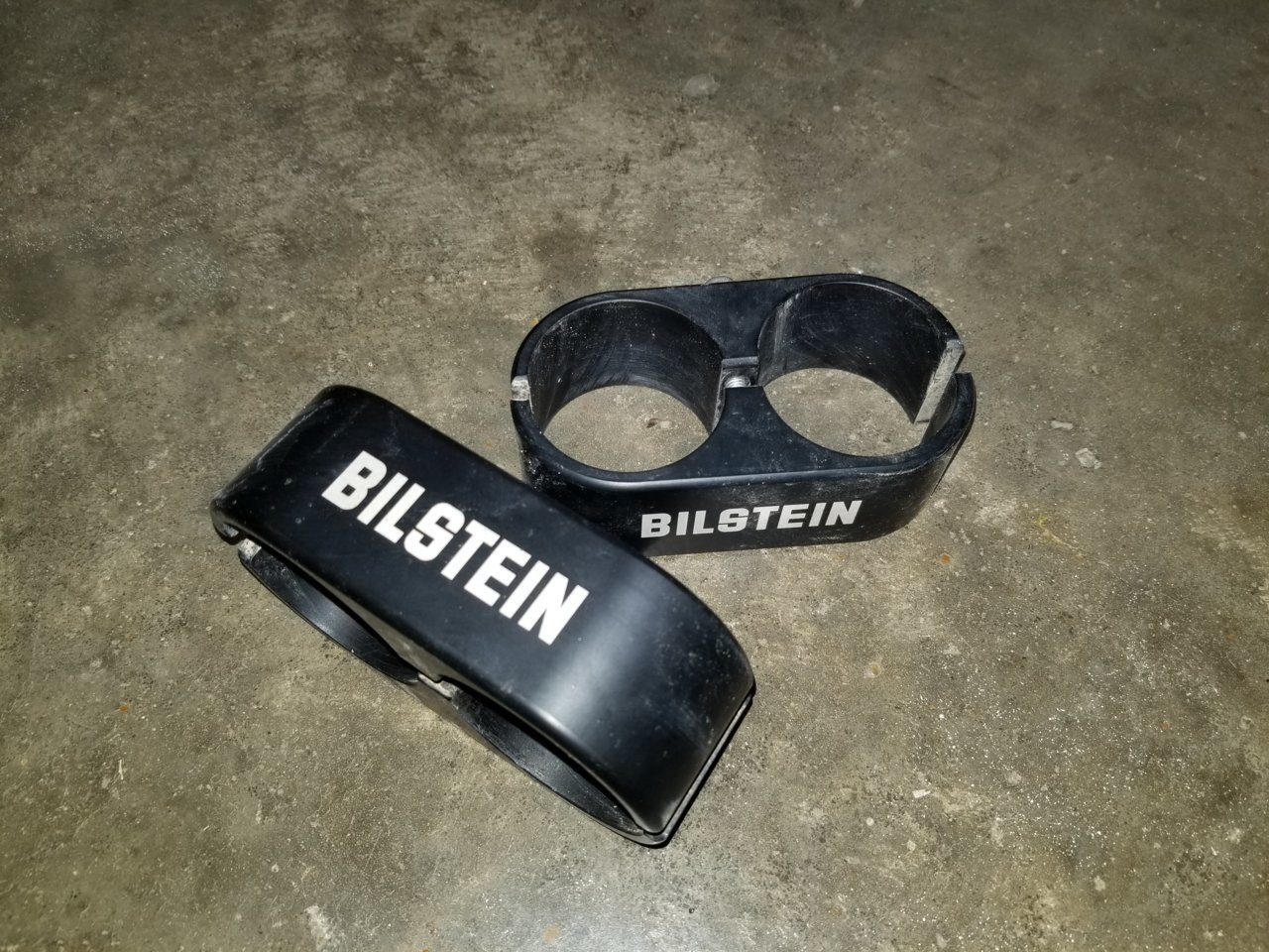

    I have a pair of the billet reservoir clamps for the rear 5160 that I can make someone a deal on...
    (They go for $42 each new.) I used them a few months on my 4Runner. 20190314_200337.jpg

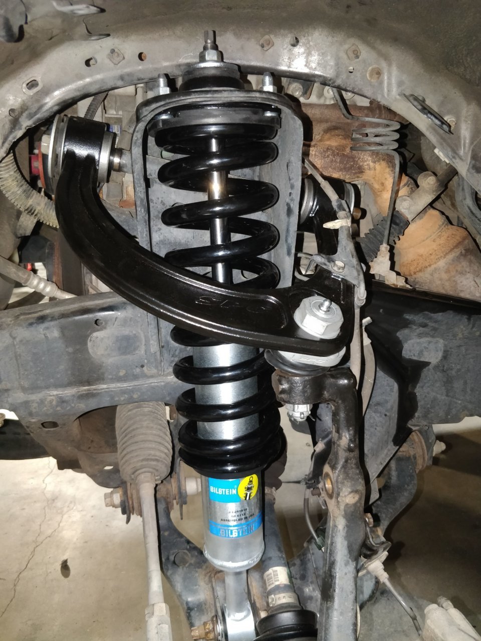

    I think I’m about to pull the trigger on these for my 2018 DCSB Off-road. I also have a Wheelers 3 leaf progressive leaf pack. If I want to keep a factory looking rake, what setting you guys recommend? 3/4 or 4/5?
    I also plan to run an SPC UCA. I have SCS 17x8.5 w/ -10 offset. Will run my 265/70s through winter and move up to a 285/70 in spring. Hoping to get away without too much trimming but know it will be necessary.
