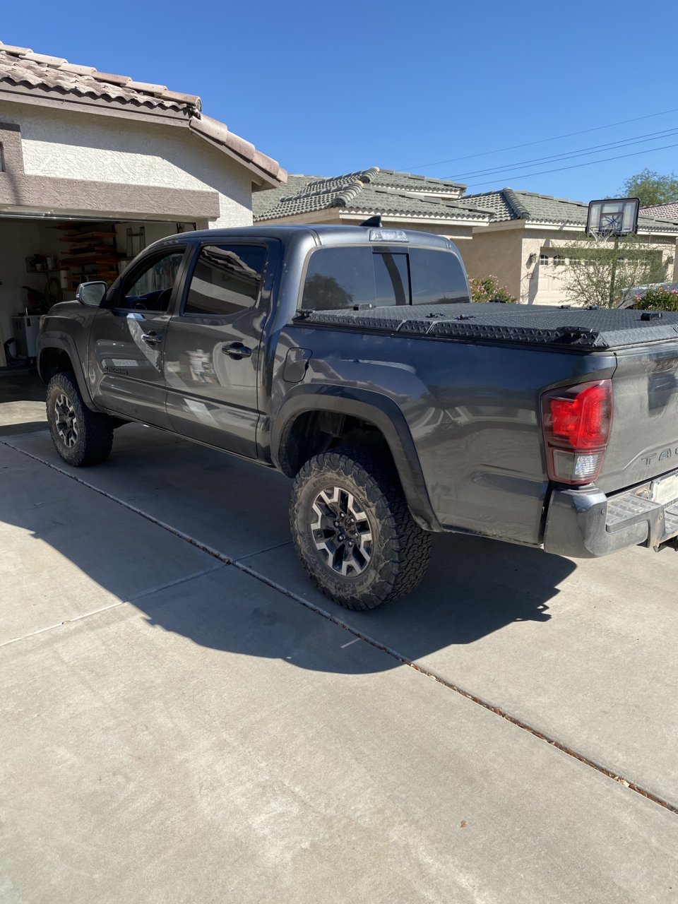

  6. Nov 1, 2020 at 3:42 PM
    #4306
    Johnny—utahco
    Johnny—utahco Well-Known Member
    Nov 17, 2018
    #273030
    107
    2018 Tacoma Trd Off-road
    Nothing yet
    Those are 275/70/16’s. 31’s if I remember correctly. They’re pretty low on tread with only about 4mm left. Probably gonna see about getting 33s on there if they’ll fit and if not I’ll go with 32s
  7. Nov 1, 2020 at 3:57 PM
    #4307
    csayno
    csayno Well-Known Member
    Jun 22, 2014
    #132418
    261
    Tulsa, OK
    2020 Cement TRD Off-Road
    Appreciate you. Doing the same size tire. Glad I have a picture to refer to. Thanks!

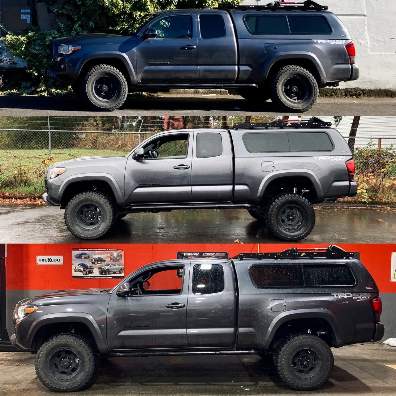

    Got my 6112/5160’s installed this week - set at 5/4 on 650lb coils. So far so good, need to hit some dirt this weekend.
    Before, middle, end:
  9. Nov 4, 2020 at 12:10 PM
    #4309
    Zippo138
    Zippo138 Member
    Jul 9, 2020
    #333899
    8
    Lee
    Did you swap the UCAs or did you stick with the stock ones?
    TIA!
  10. Nov 4, 2020 at 1:40 PM
    #4310
    Taconator_
    Taconator_ IG: ohv_tacotruck
    Jun 16, 2017
    #221655
    1,974
    Eric
    SoCal
    18' DCSB TRD OR 4x4
    How does it ride with the 650 coils? I don’t have my swaybar so I’m considering the 650lbs.
  11. Nov 4, 2020 at 2:24 PM
    #4311
    FashTaco
    FashTaco Jungle Asian
    Jun 20, 2019
    #296926
    362
    Oregon
    2022 TRD OR 6MT DCSB <- 2018 TRD SPORT 6MT ACLB
    Rides great! No trails yet though and I’m coming from Sport suspension - everything feels less harsh than stock to me, even with the extra beef. It corners just as well on pavement as stock Sport (which I liked) but damping is much better and with less nose dive. I added SPC UCA’s too, hoping they compensate a little for any loss in travel performance from the stiffer coils. Planning to add a bumper+winch anyways but wouldn’t be too worried if I didn’t.
    Hope that helps.
    David210 and Taconator_[QUOTED] like this.
