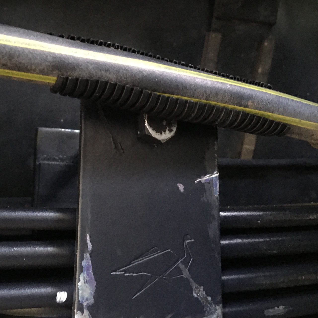

    This is my redneck engineering solution I used. I zip-tied the ends after this photo was taken to keep it from moving or falling off.
