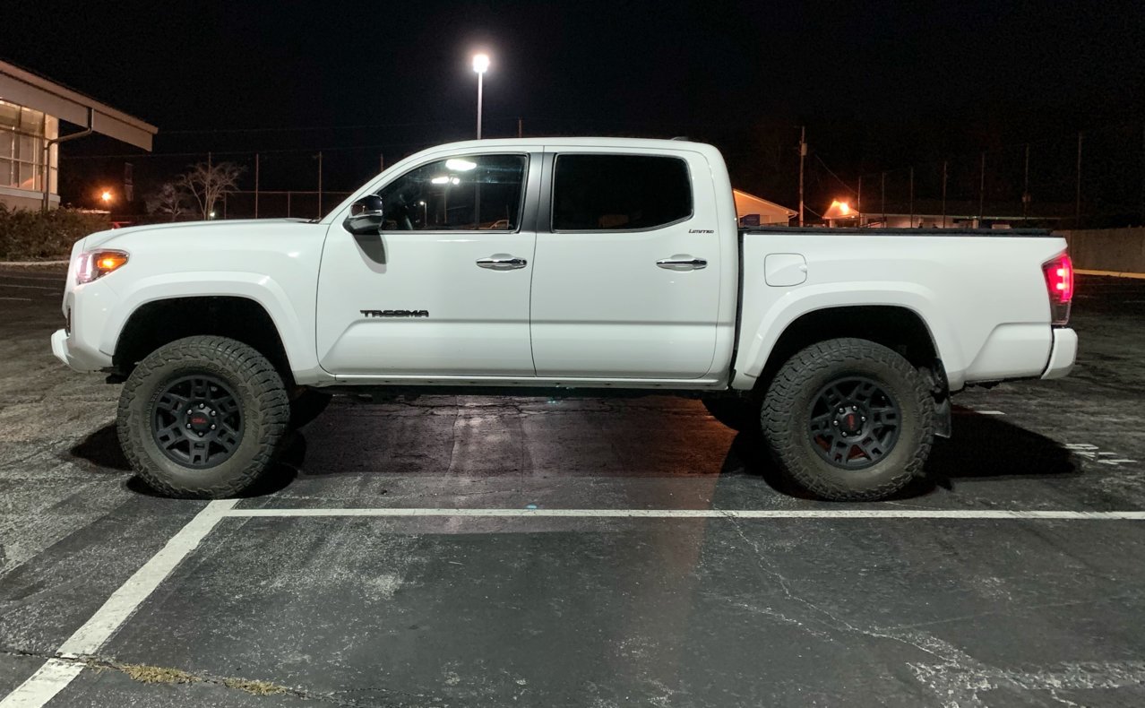

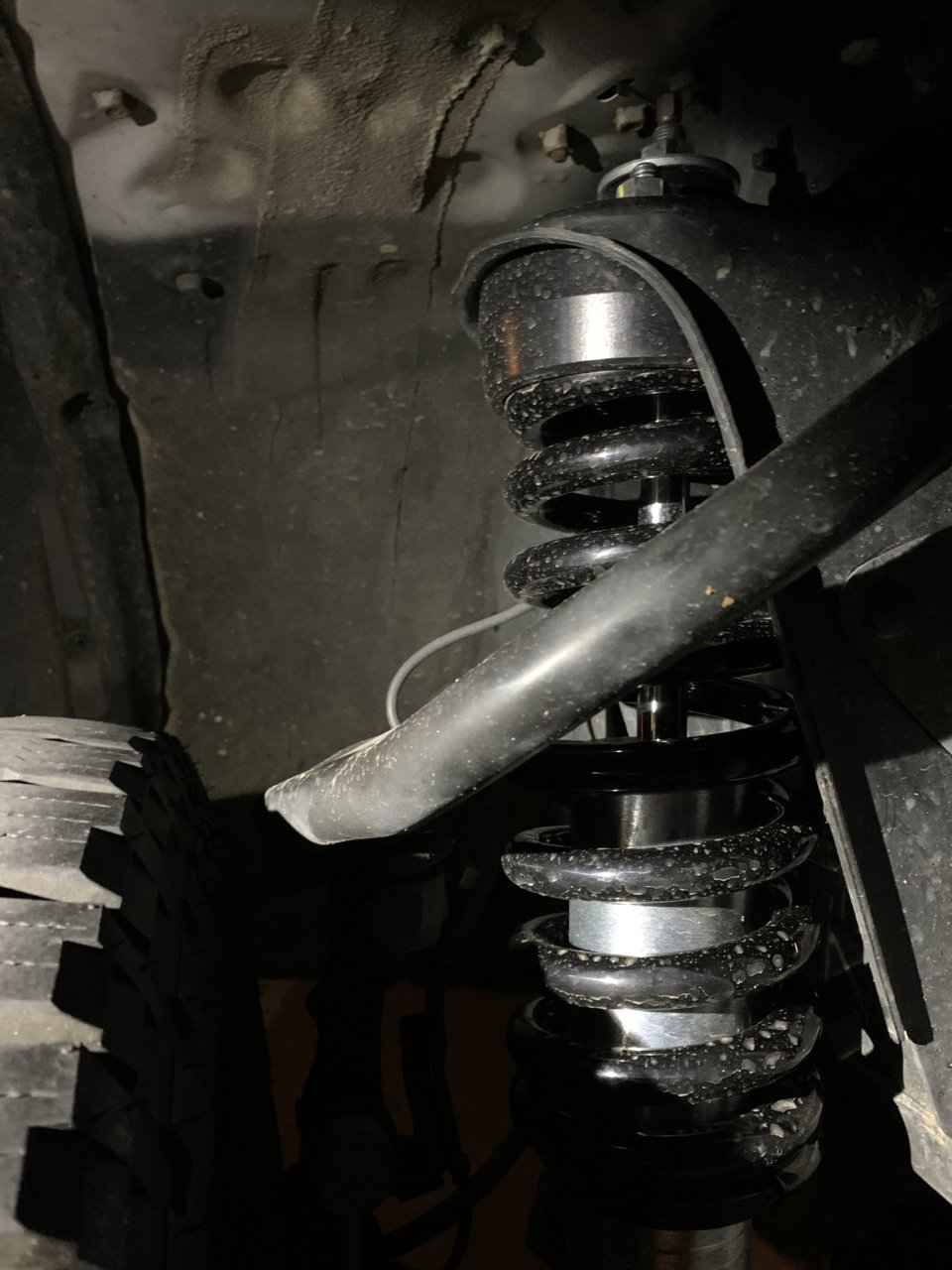

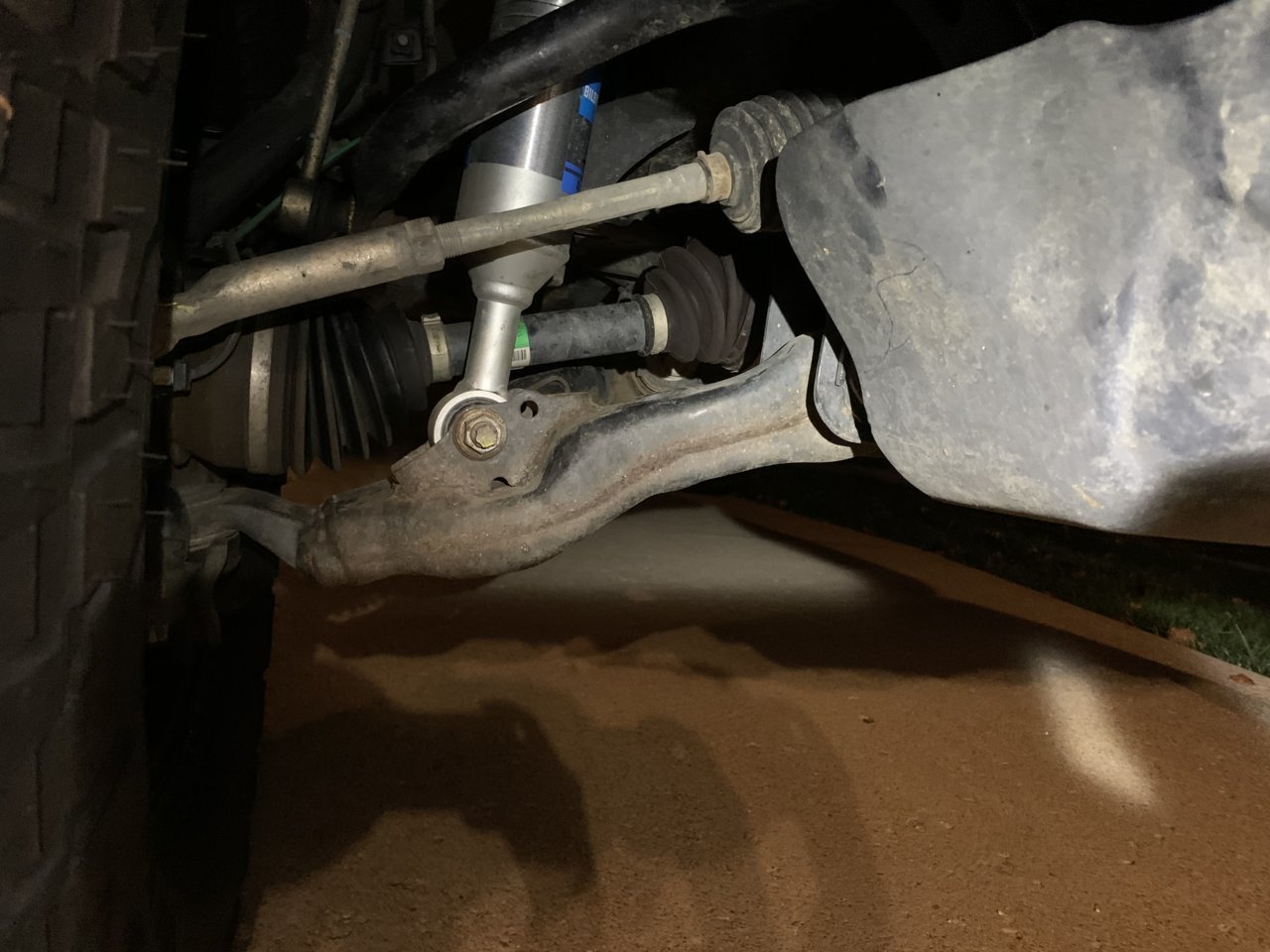

    Just added 6112s (5100s rear) at what I believe is the top notch. My opinion is that it’s way too high up front and I’m concerned with the UCA angle. This is on the road and it looks like the UCA is pegged as far as it will go with little room for down travel. Sitting on 285/70/17.
    Is this angle ok? Do I need to drop to 4th notch and add new UCAs or am I overthinking this? Will This improve angles and still clear w/out CMC / major trimming?
    Appreciate the help!

    If you just installed them, they will settle "a little" over the next couple of weeks, but it does have a very high UCA and CV angle right now. At the very least, if you are going to stay that high, I would put some JBA UCA's on there.

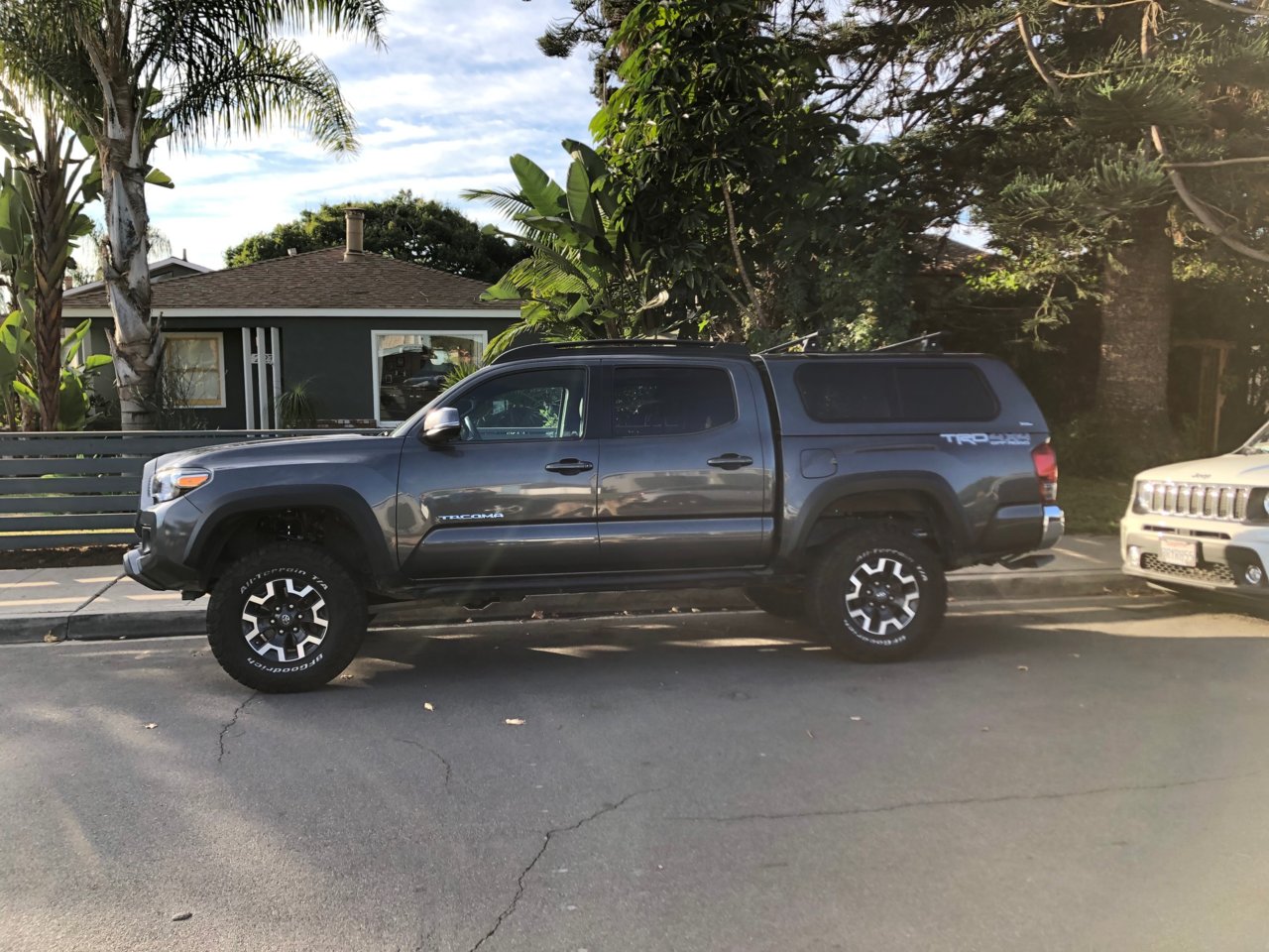

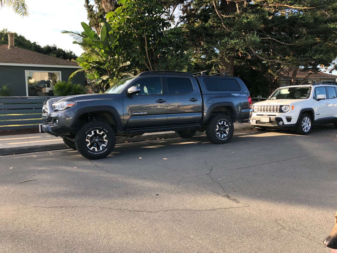

    Looks like you have a spacer installed? Did you get that kit from ready lift?

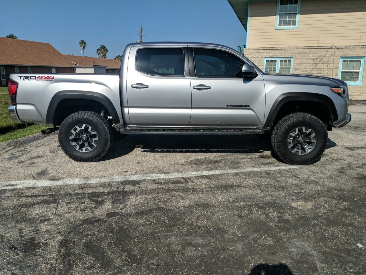

    I had my 6112s/5160s installed alittle over a month ago and after driving with them around town and doing a little wheeling this past weekend I can say I really like them. I wish there was alittle rake, but it ended up level which I am fine with, it looks like it has alittle bro lean in the pics due to the angle I was parked, but in a flat parking lot it is level. I went with SCP UCAs, set the fronts at 5/6 and went with an Icon AAL with the overload left in. The went with the setup because I have a camper shell (200-250lbs), RCI sliders (~125lbs), and full aluminum skids (~70lbs). I noticed when I was camping and had the back loaded up that I was sagged out and figured with all the weight that leaving the overload in would make sense.
    I prefer the ride over stock because it is firmer in a way I prefer; way less brake dive, less boaty feel when turning, and less bouncy. It still soaks up bumps well and feels more composed over a rough road or a washboard road. I did the Oriflamme Canyon trail this past weekend for those in SoCal and I could feel a difference for sure.
    Tires are 265/75/16
