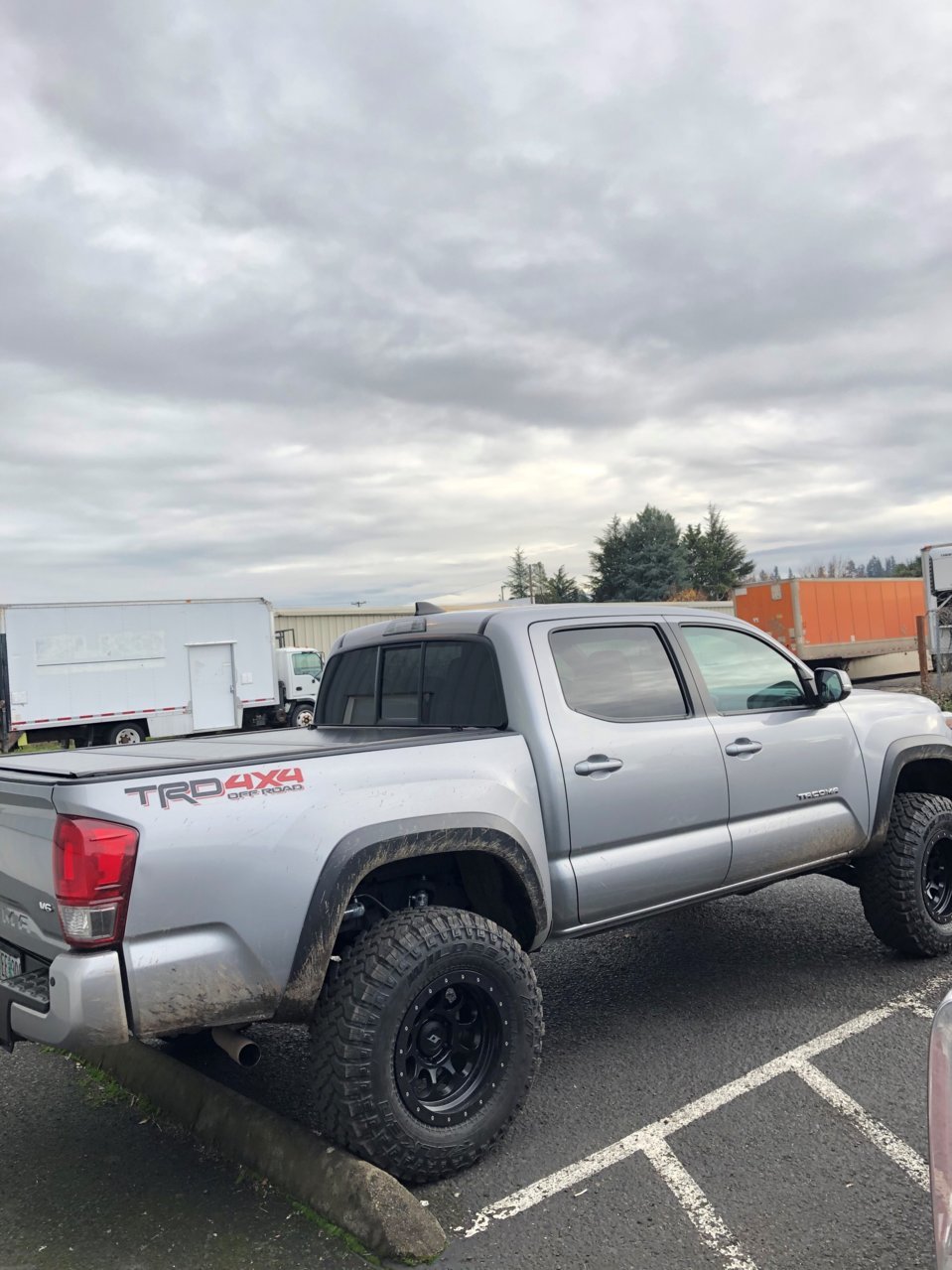

    Hey Guys! New to TW, but been following this thread for awhile now. Got the 6112's/5160's, +3 AP leaf pack and SCS -38's put on this weekend!3 (2).jpg

    Looks good, with that stance and the -38s I'd get flaps, PPF or something, your rockers and rear quarters are gonna take a beating.

    I'm willing to bet about 100% chance 5/6 or highest setting, with that offset.

    @Wheeler's Off-Road Inc assembled and preset them at 6/6 for me. Rides stiffer than stock but i like it so far!

    Huh that's odd, usually its 5/6 to account for the "taco lean". They'll soften a bit / settle.

    I isntalled a 3/8" poly spacer to account for the lean, she sits almost exactly level front to back. If there is rake, you have to look closely for it :thumbsup:
