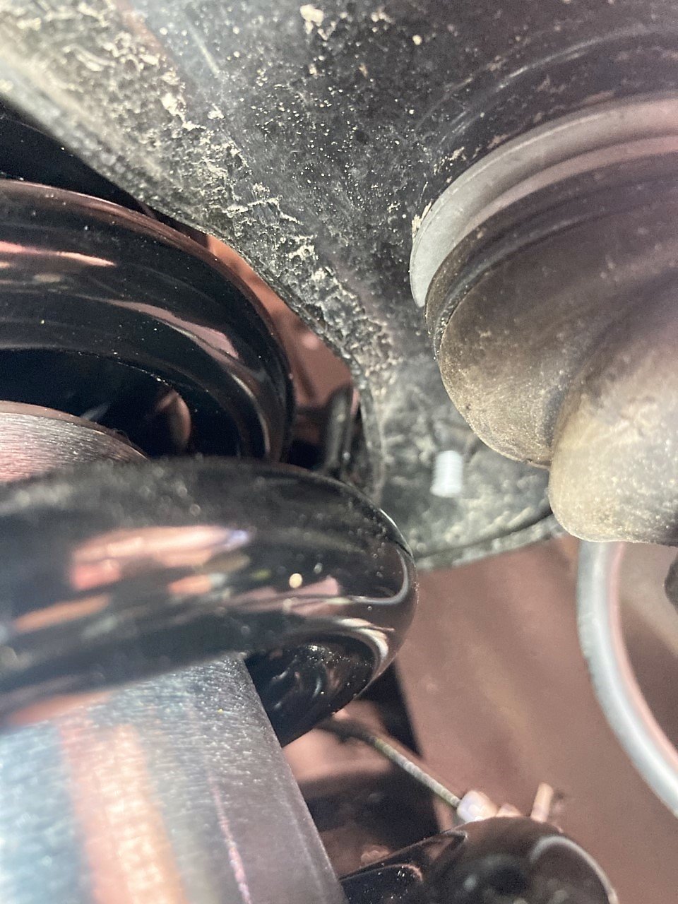

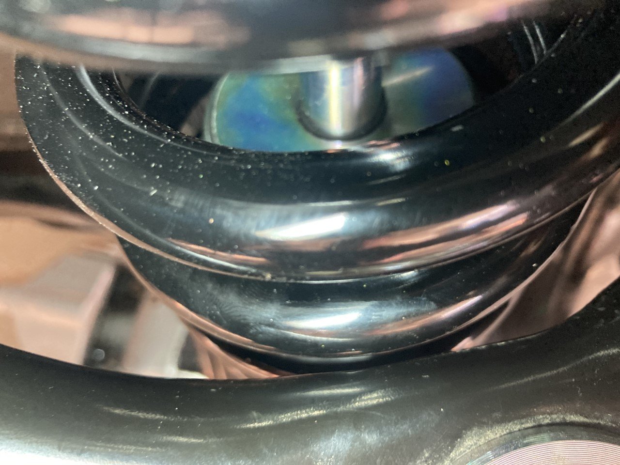

    Agree with this and wonder if it would be better to set the Bilstein at #2 or #3 setting to retain some down travel then use a 1/2” spacer to get to a 2” total lift?
  11. Dec 17, 2020 at 8:45 PM
    #4411
    Fast1
    Fast1 Well-Known Member
    Jun 24, 2009
    #18875
    1,132
    Minneapolis, MN
    2021 TRD Off-Road Access Cab
    possibly, but that may increase the max extension length of the coilover to the point of requiring an aftermarket UCA to mitigate coil/UCA contact from extended droop.
    Here are the pics of my Bilstein 6112 on 4th/5th clip for a Access cab, which is max lift per Bilstein specs at full droop. I currently measure ~ 1.75" height at 22.75 (hub to fender). The coil comes close to the UCA but does not make contact. IMO if the coilover assembly is made another 1/2" longer with a spacer you may need a UCA to mitigate interference.
    Just went out in the garage and measured my coilover ride height #3 from my previous post. (21 1/8")
    #1 is 22 3/8"
    Difference 1 1/4" or 2 1/2" of down travel.
    Wonder how this compares to stock TRD OR down travel?

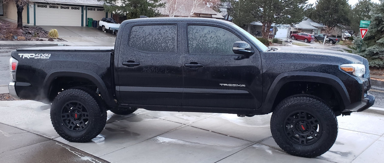

    I finally got my lift done. 2020 ORDCSB with 6112 with 600 lb. spring, set at 6/5 and 5160, SPC UCAs, along with the Icon AAL. Overload removed. Been one whole day, but rides so much better than stock. Stiffer in a good way. No more nose dive at stops, less body roll on corners. I'm almost dead level as of right now, I assume the front will settle a little. Not great pics, but it's what I have atm.
    Before:
    After:
