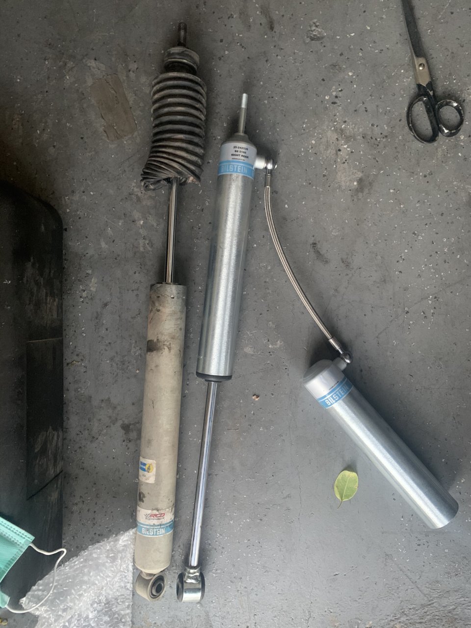

    Looks like you had extended 5100's. I had them (5125). More travel than a 5160.

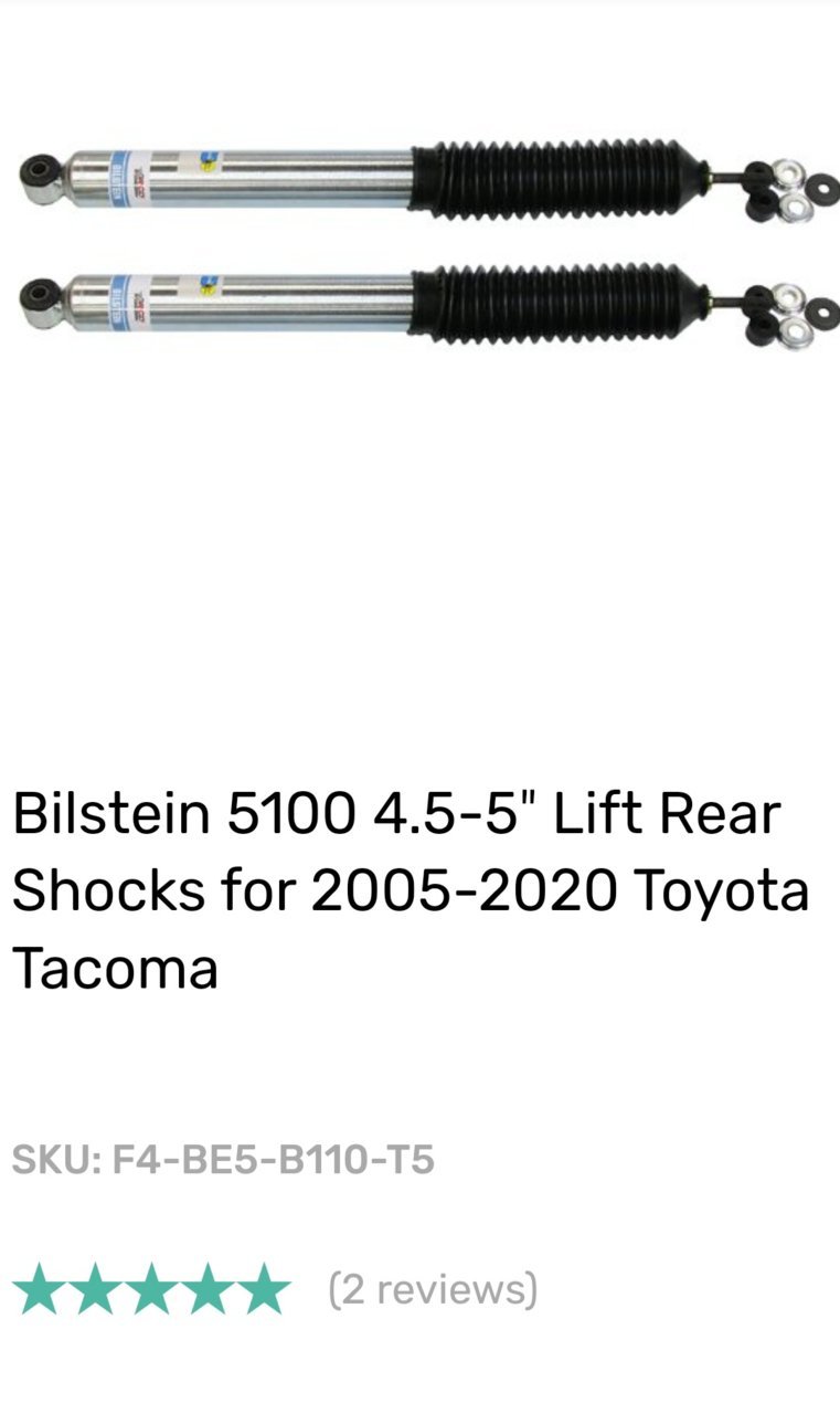

    Interesting.. I had bought my 5100a as a kit from headstrong.
    I had read that the 5160s had a little more length to them which is why I bought them.. guess there’s a pair of 5160s for sale (brand new) If anyone wants them lol.

    I see you have an RCD sticker on your 5100's. RCD makes a 4-5" lift rear shock. That's a really long shock.

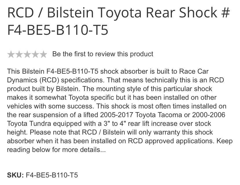

    I Believe the part number on my 5100s is
    F4-BE5-B110-T5 it could be, there’s easily 3 inches of length compared to the 5160s... hmm. This has been an interesting day.
    Edit: lift is definitely not 4-5” I just have the 5100s and Dakar medium duty. I would say 2” due to my Dakar’s sagging a bit.

    Right from the Bilstein website (below). If you have more than 1.5" of rear lift you might want a different shock absorber.

    Have you compared the collapsed length? That is probably just as important as the max extended length.

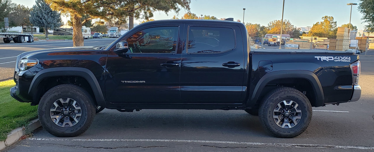

    No spacers, in fact I did try spacers after the initial install, and they caused rubbing on the outside of the fender. Without spacers and with max caster on SPC UCAs, no rubbing.

    What size tires are those?
  17. Dec 29, 2020 at 1:50 PM
    #4437
    StealYourFace
    StealYourFace Well-Known Member
    Jan 2, 2020
    #314921
    189
    Reno/Sparks
    2020 ORDC MBM
    255/80/17 Falken Wildpeak AT3W. They are skinny 33s. Not everyone's cup of tea, but for me, it was a perfect marriage of form and function.
