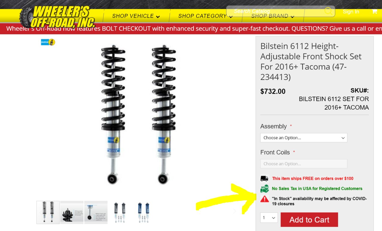

    Icon Rebounds 17x8.5 Toyo 35/12.5/17 JBA UCA, Bilstein 6112/5160, KDMax
    I ordered from Wheelers 12/19. They do not have them in stock. And no accurate eta.

    2024 Silver Tacoma TRD OFF Road
    It was at 4wp ordering directly from Bilstein. This was in Oct. At the time Bilstein owed them almost 200 6112s and close to that with 5160s.

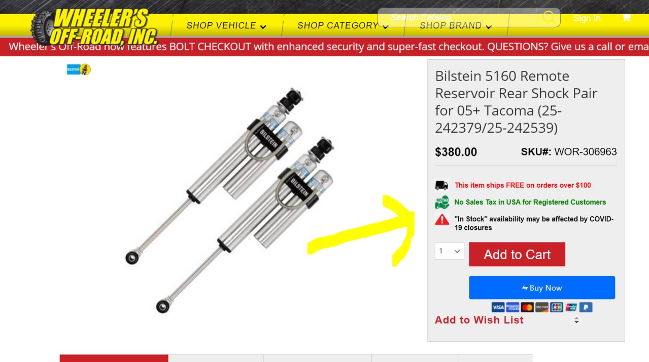

    Odd, I received the 5160 rear shocks on 12/15 and they had just got a shipment in.
    When they shipped the 6112 fronts to me in early December they had 32 pair on the shelf. I had asked before I ordered them because I wanted to ensure they were in stock and would ship right away.

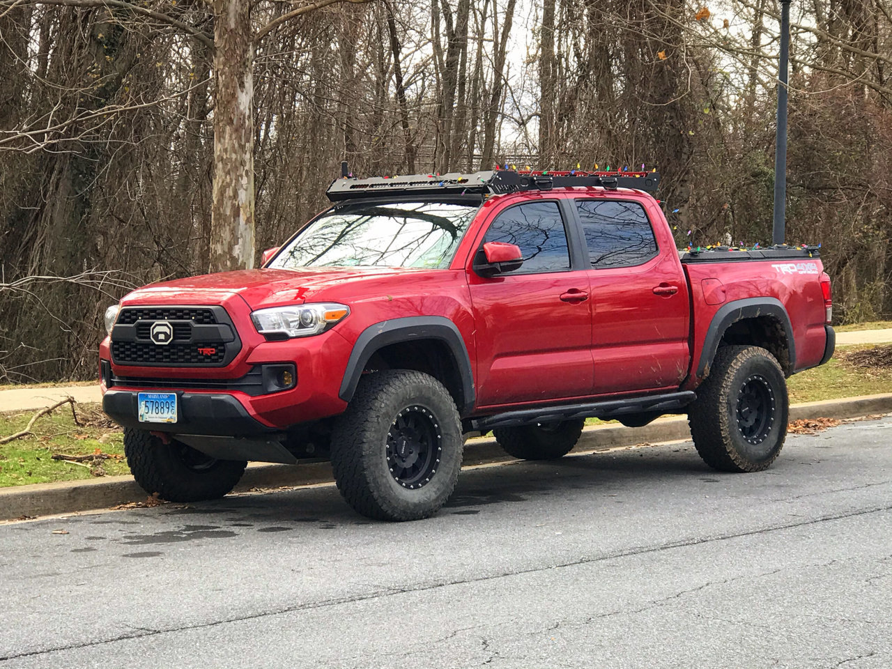

    '16 Barcelona Red OR
    Mobtown Sliders, Aluminum Skids Bilstein 6112/Extended 5100’s Iron Man constant load leafs JBA High Caster UCA’s Diamond Back Tonneau 285/75/r16 Cooper STT Pros Method 702’s Uptop Overland Alpha Roof Rack
    I have the clips on the 5th setting with a 1/4” spacer on the driver side with the 1.5” 3 add a leaf and have a very small rake. Sometimes if I park up hill it looks like the front is higher and if I park downhill it looks like I have more of a rake (makes sense) so I’m assuming it’s almost level.
    StealYourFace likes this.
