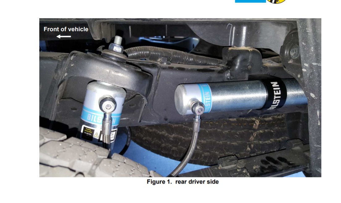

    Just got the Bilstein 6112/5160 set up put on today, with Camburg UCA’s and OME Dakar HD’s.

    You may want to check the directions for the rear shock and reservoir mounting. The line connecting the two should be down per the install instructions. upload_2021-1-8_18-18-6.jpg
