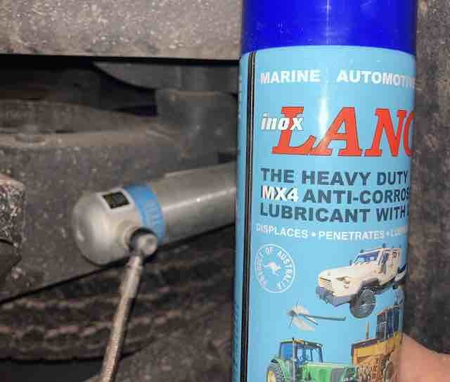

    This is a huge thread... anyone have had any corrosion issues on their 6112 6160's? I live in Utah with a lot of snow and salt...

    I have seen some that look pretty bad after a year. Definitely want to try to protect them.

    cool thanks. Just spray them down often after driving? Or is there anything you can do proactively on that?

    I’ve seen online fox makes some shields for the rear that can help. Bilstein also recommends no boot because they trap moisture.

    Clean the shock body and banjo lines, then coat all surfaces with this:

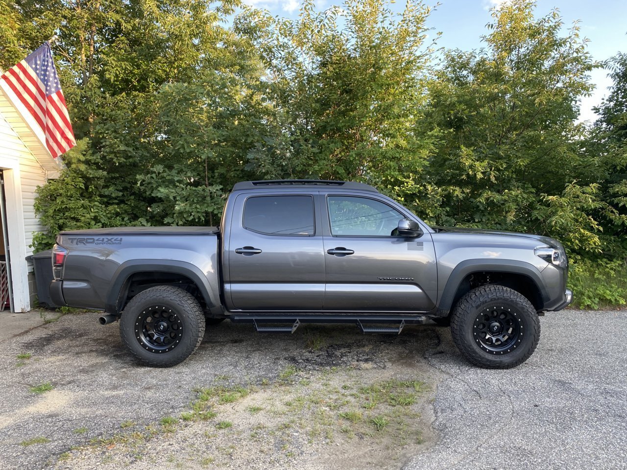

    Here's mine with settings at 3/4 and no rear lift. truck.jpg

    how is the ride?
    Also, what size tires are those?

    265/17/70 I have no complaints about the ride. It's more firm than stock but I'm happy with the way it turned out.

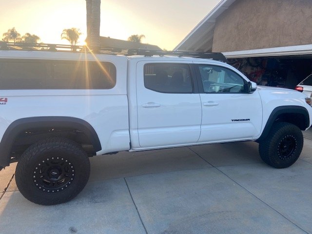

    Go 5/4 if you don't want the nose higher. I'm set at 6/5 with an 1 1/2" AAL. I have a shell and a RTT and it sits almost level with the weight in the rear. Maybe slight nose high.

    That is what I have been leaning towards... but the Icon RXT pack option two is 1.75 with a 200 pound load. I have roughly 300 constant with a GoFastCamper and then for trips, a little more with my gear. So I'd assume it would be 1.5 in the rear when everything is settled. Your truck looks great. Is the long bed vs short bed a different factory rake?

    Thanks. I got almost 2" out of the AAL, it has settled some. I think the rake should be the same regardless of the bed size. I am loading every thing up right now to head out camping. I'll measure to see where I sit fully loaded. With the canopy, roof rack and RTT I was just about level. Without the RTT I was still just under 1/2 inch higher in the rear.
