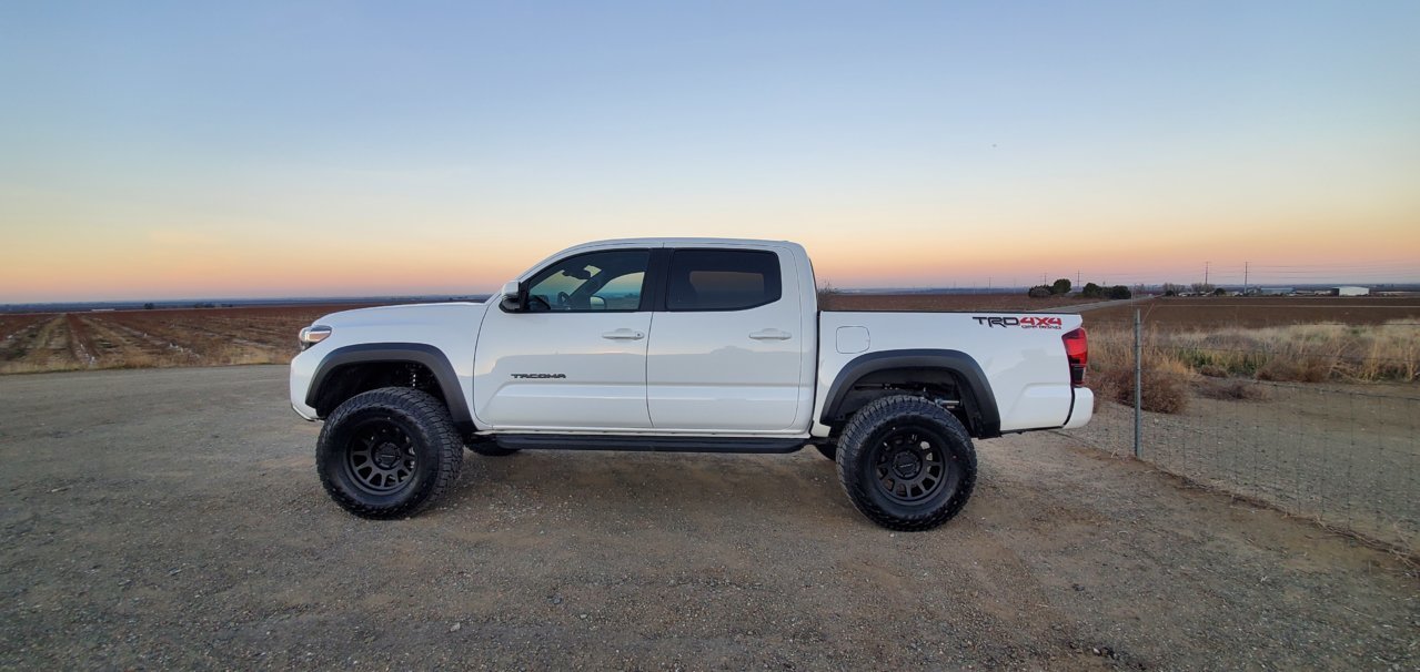

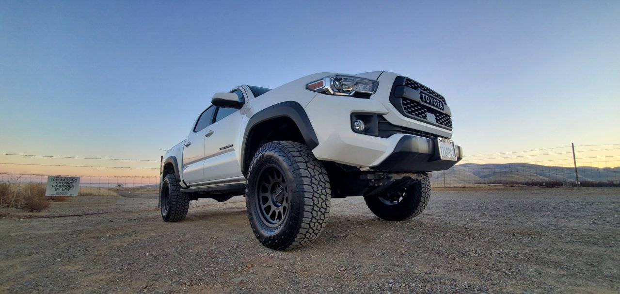

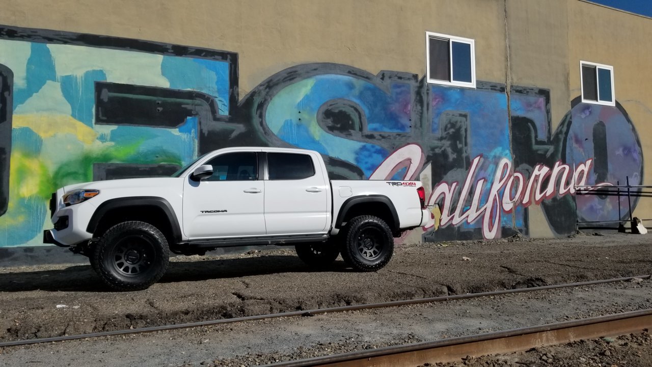

    Here's my 2018 Tacoma Trd Offroad
    Bilstein 6112 at 5/6 setting currently sitting high at 3"
    Bilstein 5160
    All Pro AAL 1.5"
    stock UCA
    285/70r17 Falken Wildpeak AT3W SL
    Method 703 17x8.5 0 offset
    If your interested I have a video of it too: https://youtu.be/ps3ZE_v78ZQ

    Looks great :thumbsup:

    Thank you, Idk if you saw my alignment thread update but i went back to Firestone and I think i got a better alignment this time. As he maxed out the caster it kept increasing positive camber so we called it quits. UCAs are in my future for better alignment.
