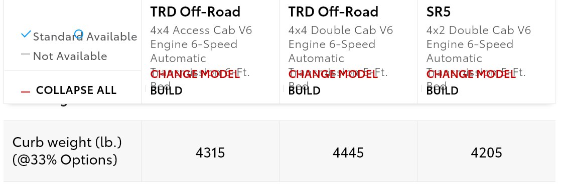

    Here are the spec weights from Toyota for the vehicles in question. 5' bed on double cabs

    Hmm interesting. I know it won’t be much but I’ll take what I can get to help with rubbing. Weight wise up front I’m only running steel skid trio and sliders. Also on 33’s, I wasn’t too bad with 0 offset wheels but new ones are -6 and definite more noticeable. Maybe it’s the weight of the sport skewp :rofl:

    I'm thinking that if you get more than 2" of lift with the clip placement, besides compromising the front axle boot angles you risk the shock being near "topped out" condition where you don't have any down travel. I can't think of any other issues besides these two for Bilstein to limit the clip position for a lighter weight Tacoma.
