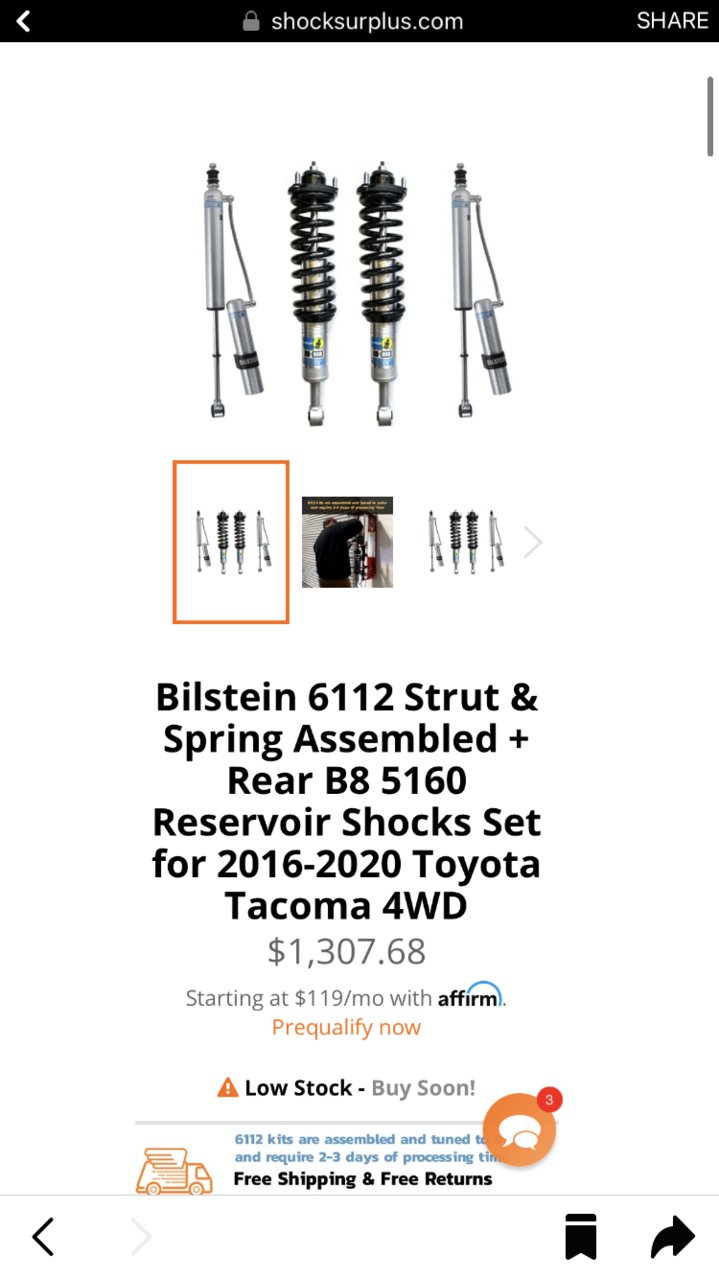

    I tried ordering before with Shocksurrplus, when it processes thru, only the 5160 is ordered b/c the 6112 is not available.
    Got my 6112/5160 from Wheelers yesterday. $1,057 with taxes included and assembled also. There's a 10% coupon.

    When you visit their website it asks you if you want to register an email for a first time purchase of 10% off.
    I believe they mostly have the 5160s in stock and the delay is with the 6112. I think their 5160 is cheapest i see online for $380. Their 6112 might show in stock, but mostly it isnt. I would call them first.

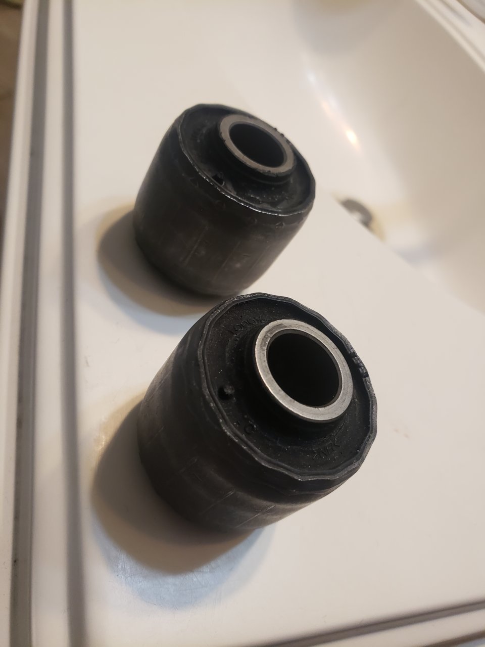

    Someone posted in this thread replacement lower shock bushings. I think it was for the TRD pro shocks which are basically the same. Without going back through 100 pages can someone repost pn's? Also are they the same as for the 5100's? those are available on wheelers and others.

    I thought they used an OEM lower bushing which I think is the same on all models. Should be able to just ask the part department at the dealer. I could be wrong though.

    Toytec, 6112, OEM all use the same.
    Toyota part # 90389-A0001

    Awesome. Thank You! now about getting them swapped?? maybe just take them to a shop with a press?

    Yes. Critical they don't press on the center metal sleeve. They need to press the outer sleeve. I had a hard time finding something the perfect size for that.
    Oh and I can do that job if needed. I'm in Lakewood.
