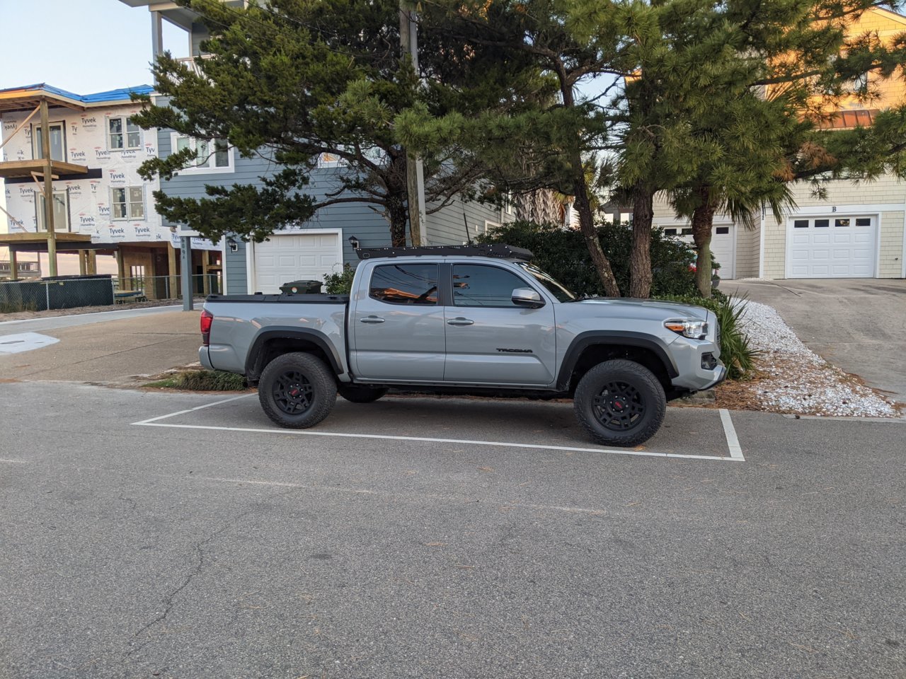

    It's really hard to see in pictures but I'm satisfied with adding the block. This picture was before the block.

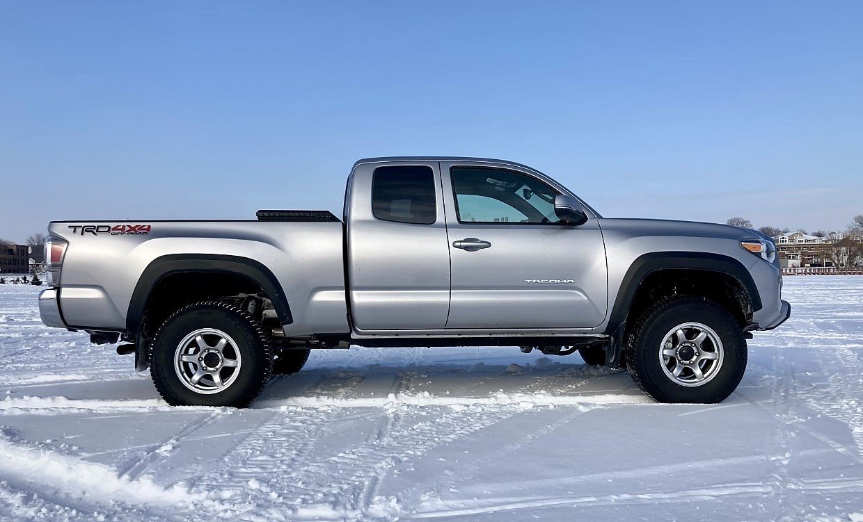

    Access Cab Clip 4/5 with 1.25" tapered block, 265/75-16 tires,

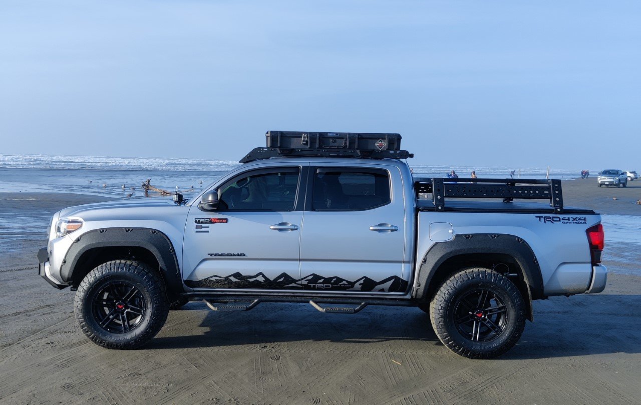

    100% worth the upgrade over factory OR suspension. My offroading is mostly limited to beach driving. I found the factory suspension to be too soft and bouncy. I'd nearly have to come to a complete stop at times to avoid bottoming out going over some deep wash board at minimal speed. With the 6112s there's initial downward travel but they recover nicely and there's no more "pogo stick" effect.
    If I had to guess, your AAL may provide more lift than you may want if you stay at 4/3. I did get more than the advertised amount but adding another .5in would definitely give me a more pronounced rake. Is you get the advertised amount of lift that might be too much. This picture is after the block.

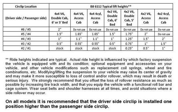

    This is from the headstrong website for the 2016+ 6112's for ride height
