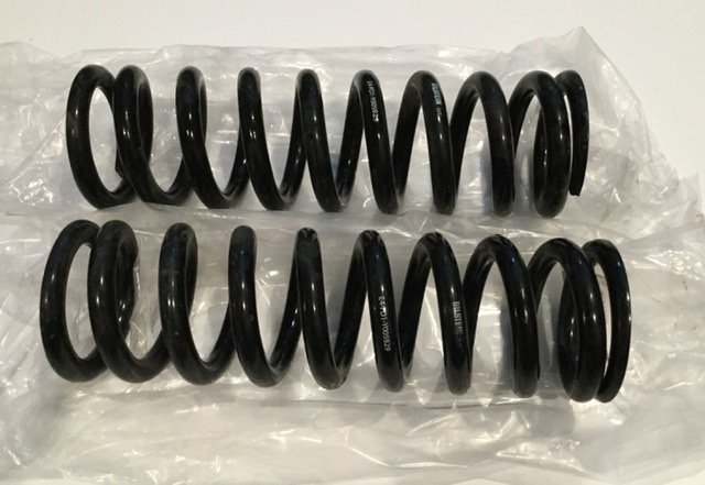

    Are there anything on the springs to indicate how many lbs they are? I'm supposed to be standard 600lb but seems like my lift is very high.

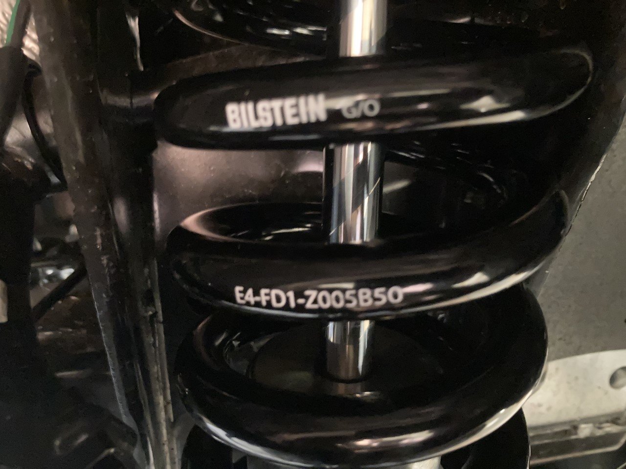

    2021 TRD Off-Road Access Cab
    This was on my 600lb springs
