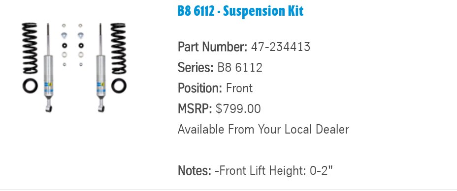

    part number listed on the link you provided is not for 3rd gen
    from the link you provided Part Number:46-206084 (this part number is not even for the 2nd gen Tacoma) it is for the Tundra
    part number for 3rd gen

    right on, just wanted to let him know they do have the parts, but for sure make sure you’re getting the correct ones
