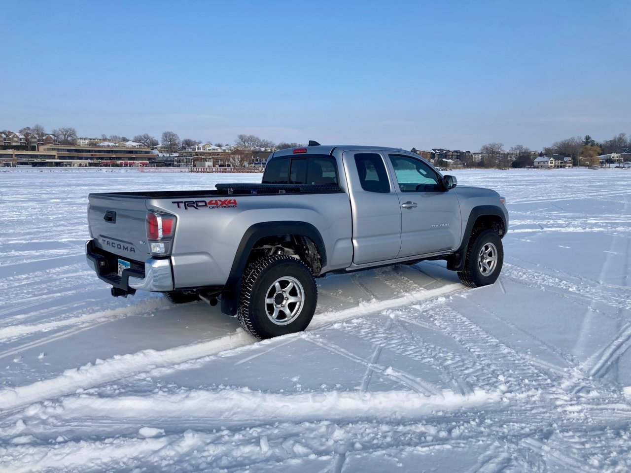

    I'm exactly where Bilstein indicated in their chart with clip 4/5 AC cab 4x4 (basically 1.75" increase in the front)
    22.75" F
    23.75" B
    1" rake for the Leer 180 shell I have on order. Based on tests with weight in the bed I expect about 3/8"-1/2" sag with the shell.
    265/765-16 tires on 16x8 zero offset wheels.

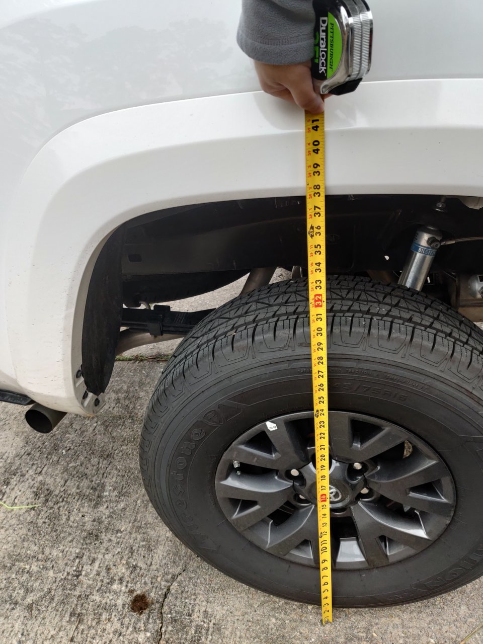

    This morning. 38 7/8f, 37 7/8r.
    Still roughly 25"f,24"r center hub to fender.
    Full tank. 3 weeks since front lift. 6/5, 1/4" top plates on both sides
    I ran thus curb about 7x. Then reverse back. Maybe 4-5mph. Did not run the rear thru.

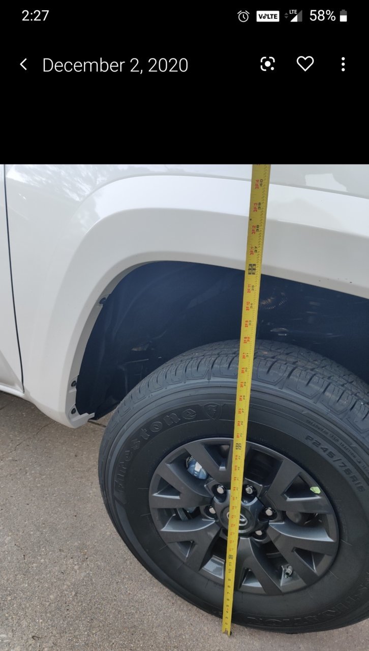

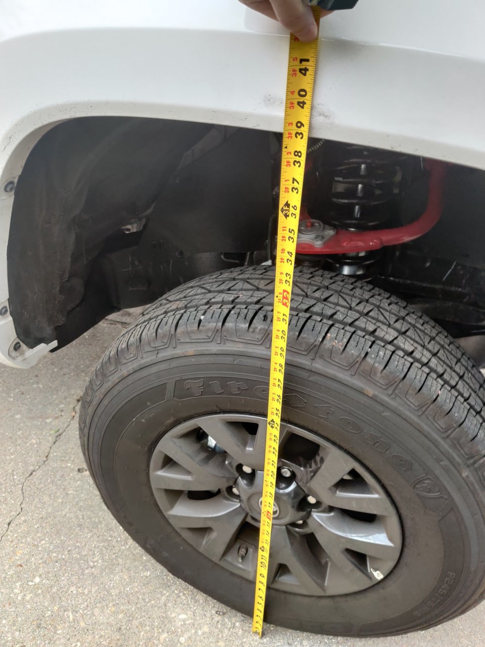

    Here are pics pre-lift from December. Stock my truck still sat way higher than the 4wd despite some saying all gen-3 tacos measure the same.
    Passenger stock 35 7/8"f , 36.5"r.
    Post-lift 38 7/8"f, 38"r
    A little stiffer than stock but does not ride bad.
    I'll just add a 2.5" rear block to level it. Will research more first.

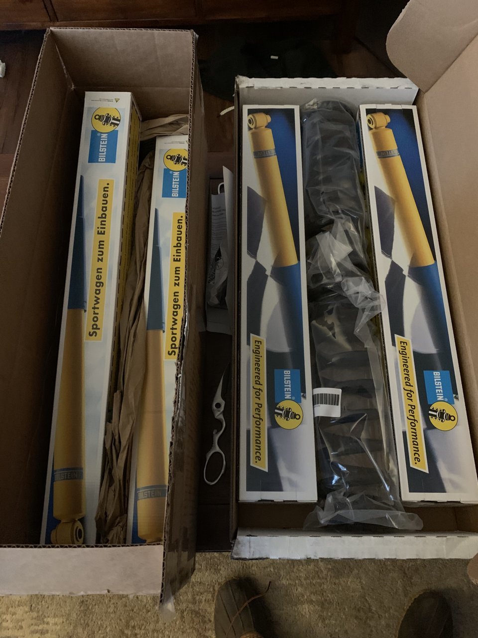

    FC9F3899-8F38-4F9A-8380-223BD057FB8D.jpg Came home from camping to some presents on the porch
