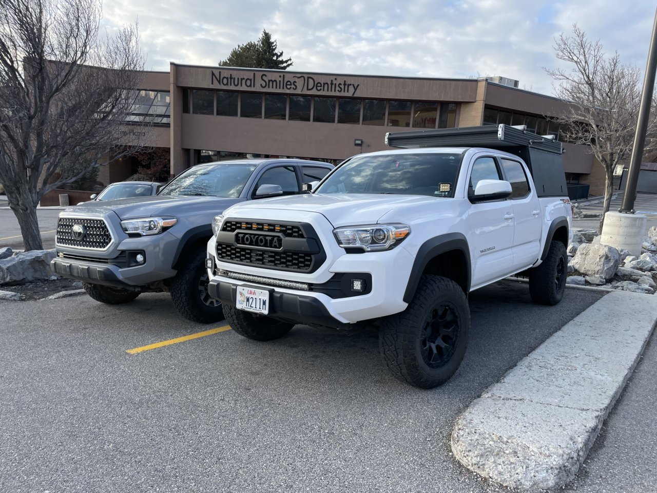

    So, I didn’t mind the option 3 but I did decide to lower it a little bit so I went down to 2 last week. I like option 2, and might lower the front later depending on how much sag there is after I have a full load. I mainly just have the GFC which is 300~ pounds then when I camp I have normal gear and tow a drift boat which isn’t too heavy. Here is a pic of option 2 on 5/6 with 265-70-17

    2020 Quicksand MT OR
    Great this helps thanks. Looks like I’ll try it out at stage 2 & 5/6 as well!

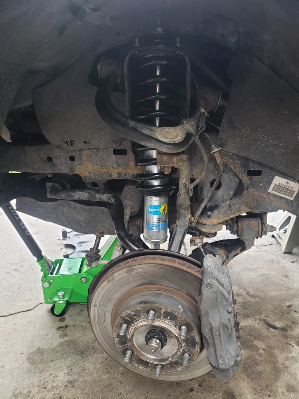

    Installing 6112/5160 for a TW member. It's a shame they are not readily in stock.

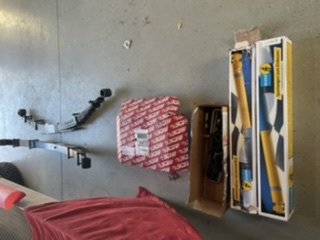

    Same here man, got the leafs in last night and doing the fronts today
