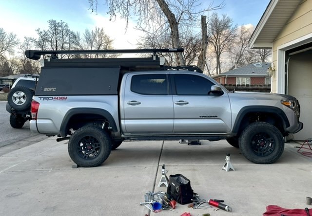

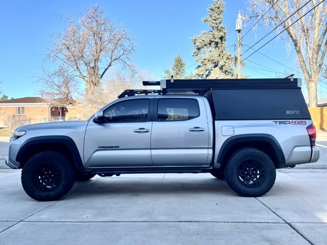

    Well, I was pretty damn surprised when the jack was released for the last time. I measured the front at just under 35 1/2 inches wheel well to ground before install. The back was right at 35.
    After the 6112/5160 combo with Deaver stage 2s I’m at 40 in the front and 41 in the back.
    Of course, they’re going to settle some. My tail end was also squatted before b/c of the GFC and worn out stock setup.
    10 hours total with a fair amount of bullshitting in between. New tires and alignment are this coming Tuesday.

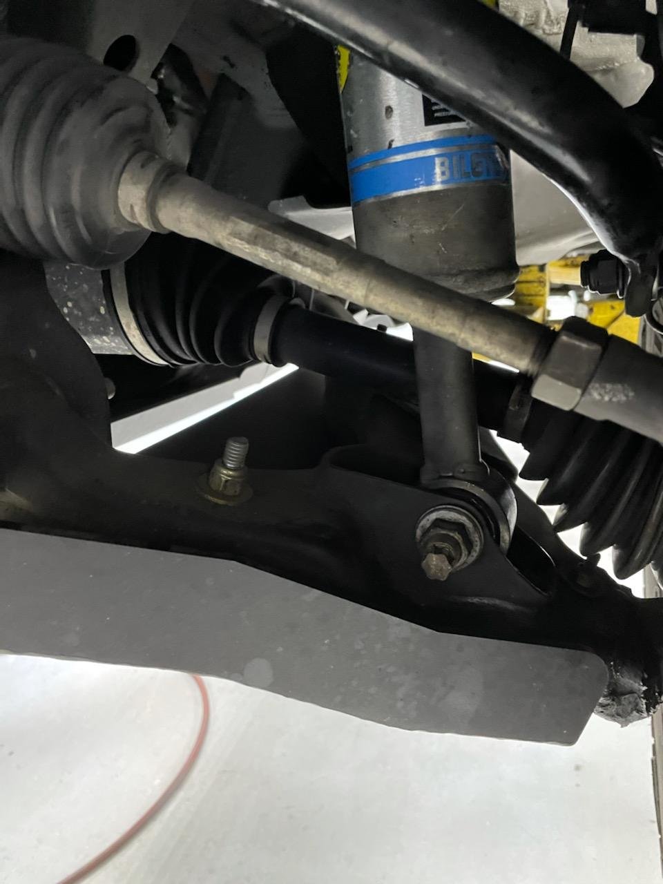

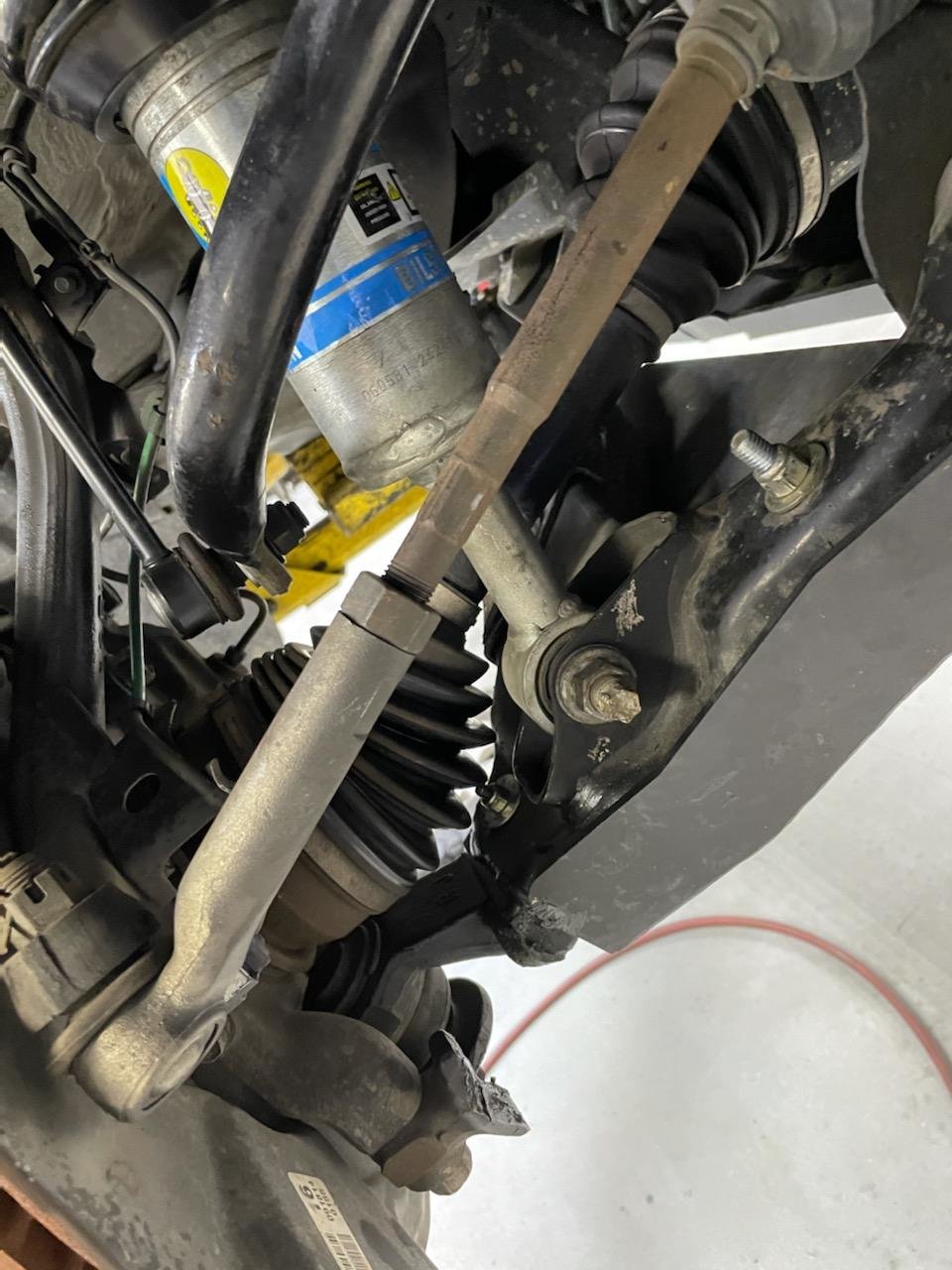

    No I have stock UCA, but interestingly after looking at my suspension a little more clearly the inner tie rods are different from left to right. You see I had an accident a while back and I think that the shop replaced the passenger side inner tie rod with an incorrect part. After some research it appears they replaced the tie rod with a 2x4 tie rod instead of a 4x4 tie rod, maybe that's what is causing the problem.
    First pic driver, second pic passenger ( I had the accident on passenger side, and that's the side they are having the problem aligning)
