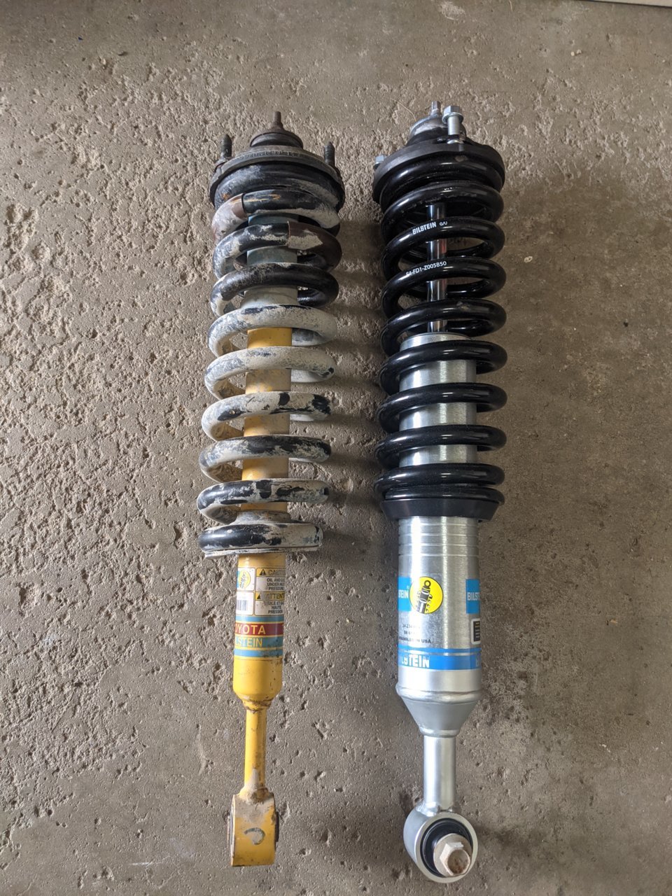

    A5774257-887C-428C-94A8-AB8D9F35CAAD.jpg 098DFC27-7C35-4656-B882-0F8565389D7A.jpg Finally have it all together. 6112s on 5/4 with extended 5100s in the rear and the icon rxt pack on option 2. Was able to track down the clunking noise thanks to endless information in Tacomaworld. I still think the back sits a little high but hoping it settles. Just need to install77E9BFF9-97AA-4796-A55E-BE858D1DF2FB.jpg the extended brake lines before I take it on the dirt

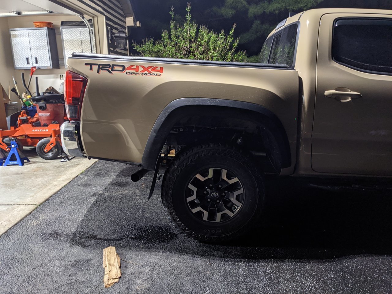

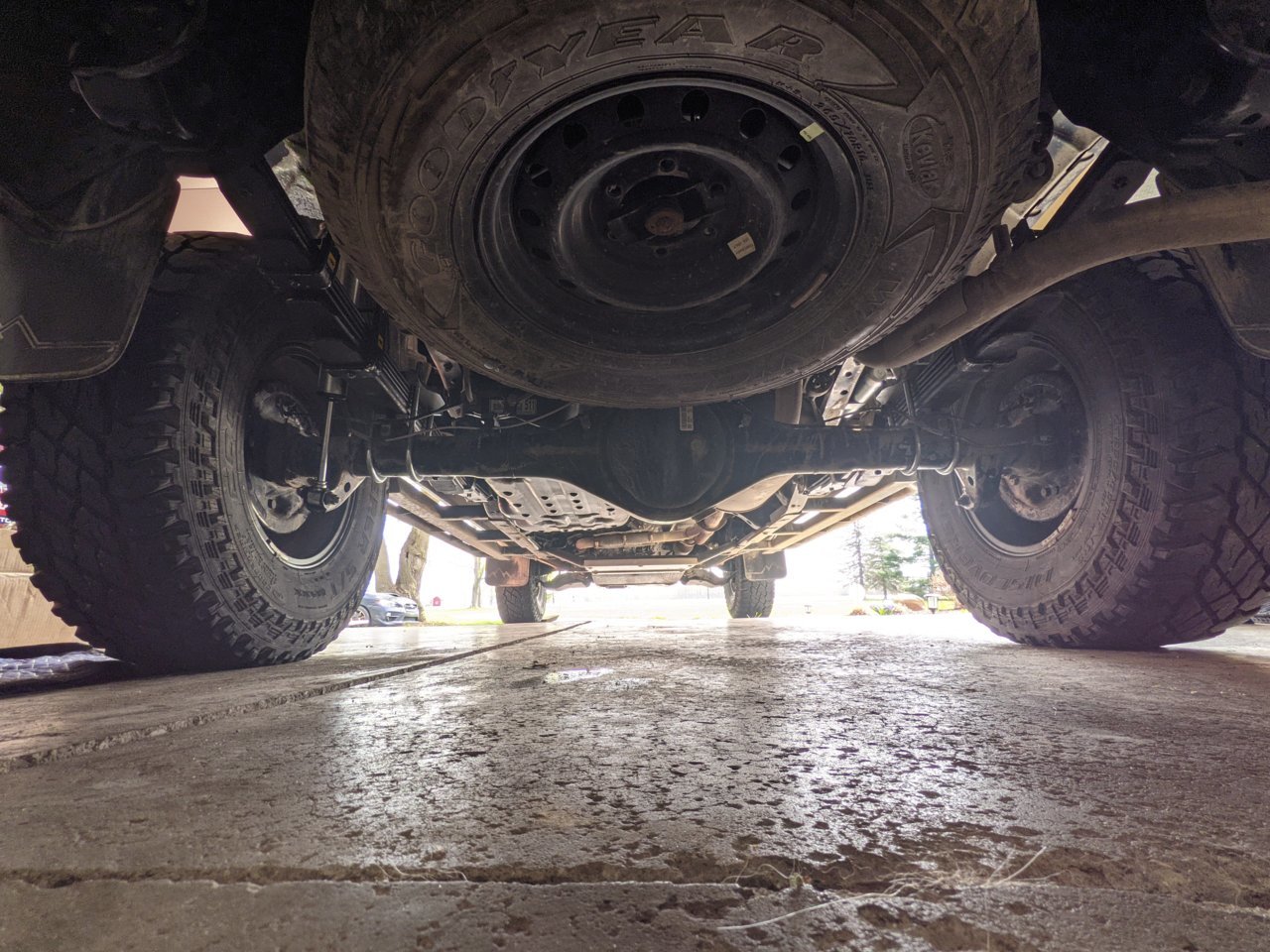

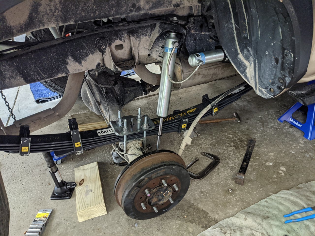

    I only had an hour or so to work last night, but I’ve made some progress anyways.. I purchased the medium dakars and have been on the fence about lift height, in a perfect world I’d like 1.5-2”. The below pictures are with one medium overload leaf removed. I’m debating putting it back in tonight before I move along any further though! Decisions decisions!
    Edit: I'm putting the overload back in tonight and letting things settle as designed before I make any drastic decisions down the road.

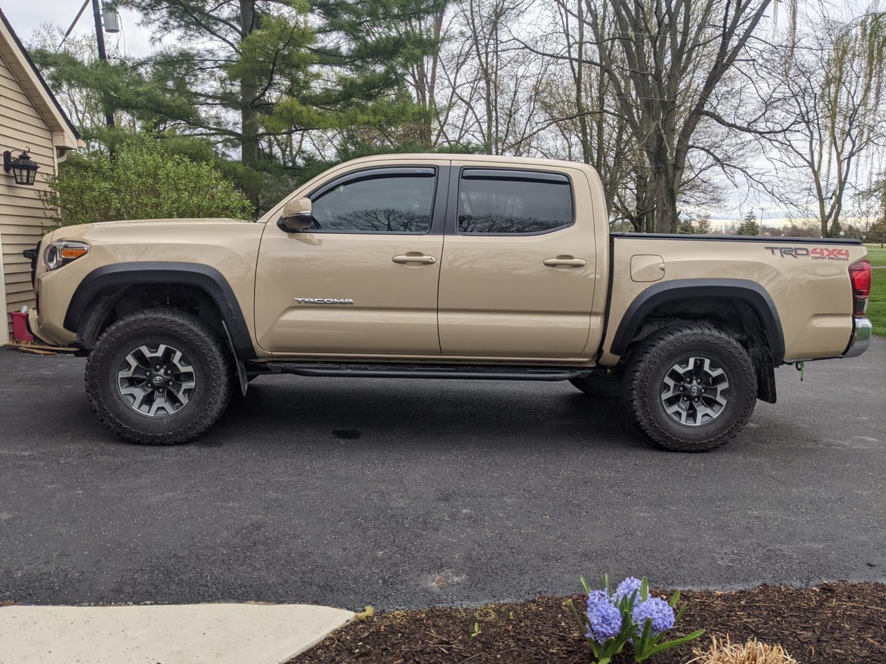

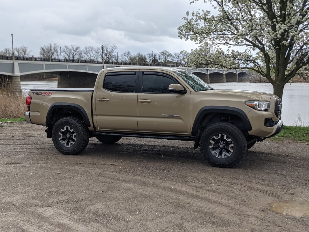

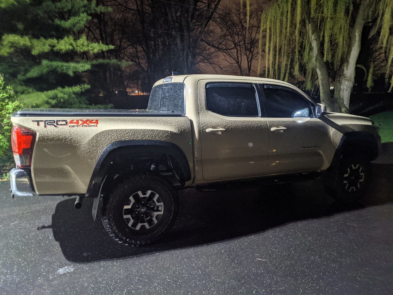

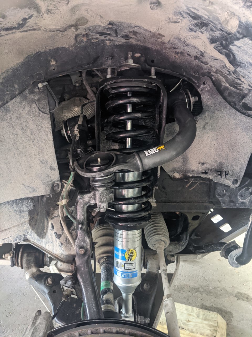

    I can't get a good photo at night so I'll update tomorrow, but I'm finally finished with the lift! Just went for a quick drive and I'm happy to report no vibrations, shakes or stutters! Looking forward to verifying torque tomorrow and alignment Monday.
    -6112/5160 on 5/6 setting
    -ome upper control arms
    -medium dakars
    -wheeler ubolt flip and bumps
    -3 deg axle shims
    Want2Believe and 71tattooguy like this.

    Measurements are from center of hub to fender.
    FR - 22 7/8"
    FL - 22 3/4"
    RR - 23 3/4"
    RL - 24"
    The tires are 255/85/16 Cooper ST Maxx

    Surprisingly under 2" for a fresh install unless your stock was slightly lower than the 21"f/22"r norm.

    I didn't want to go too tall to begin with, so the less than 2" is fantastic. However, the results seem atypical to what everyone else reported.
    Surely aluminum skids, sliders, and the oem bedmat isn't enough weight to drop the lift 1/2".

    I wouldn't think so, but ya never know. I lost almost a full inch in front with my sliders and front/mid steel skids. But, that was with stock OR suspension which is a lower spring rate than your setup.
