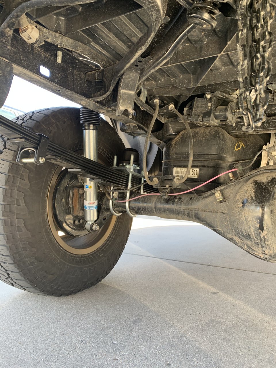

    You may want to cut off an inch or so from the inverted U-bolts at your rear axle to leaf spring connections. Looks like they might interfere with the bump stop at their current length.

    yeah it’s got a lot of overlap, I knew I had a little time before I had to worry about hitting them, but just found a coupon for a harbor freight grinder so I guess I’ll take care of that this weekend

    I cut mine then put a little black cap on bolt ends

    How much do you cut, leave about .5” of thread showing?
