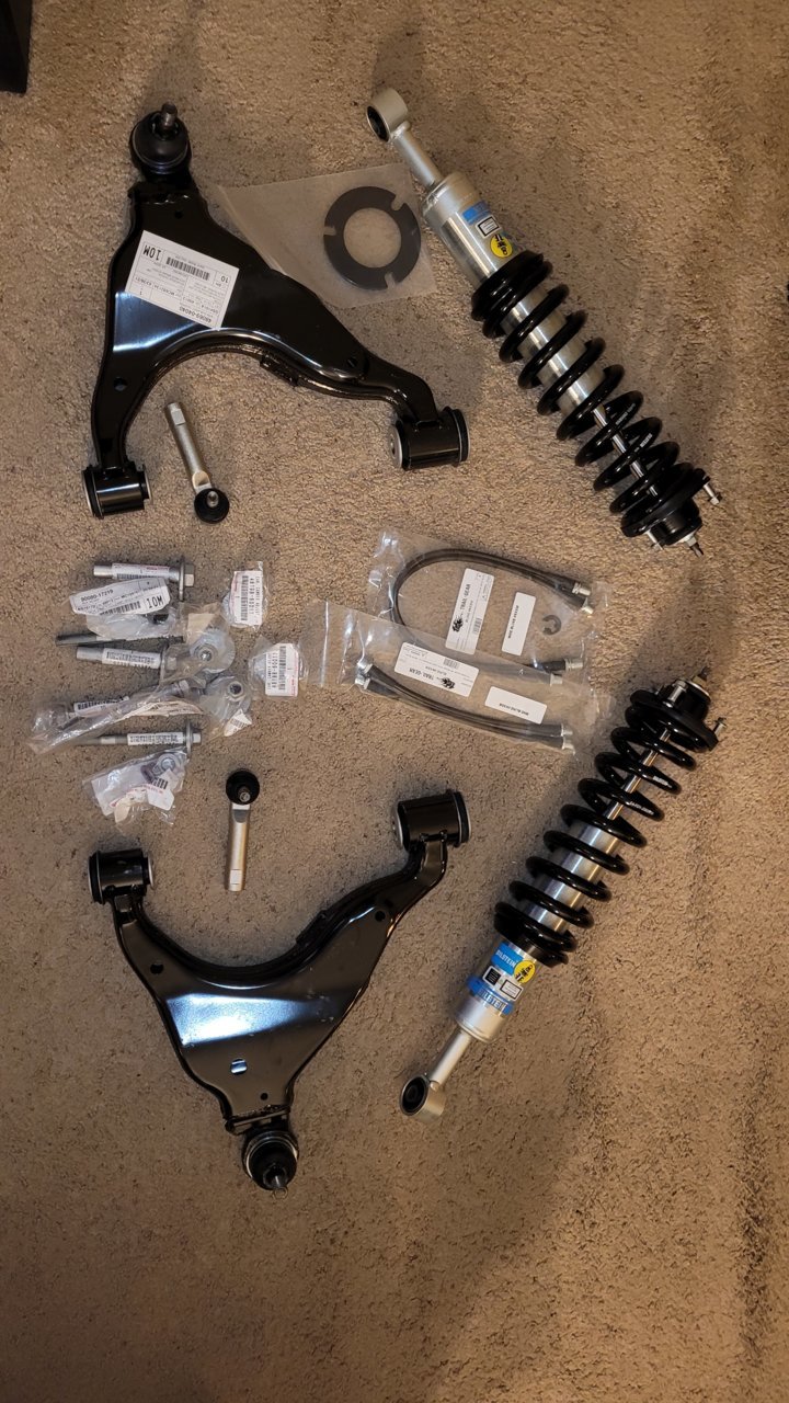

    She is going up on the lift and under the wrench tomorrow for an upgrade/overhaul of the front end. 130k miles. New 6112 Bilstein's (1st clip, no huge lift), Taco lean spacer, Stainless steel brake lines, OEM LCA, Camber bolts/hardware , outer tie rod ends, All of the OEM nuts and bolts to put it all back together again.

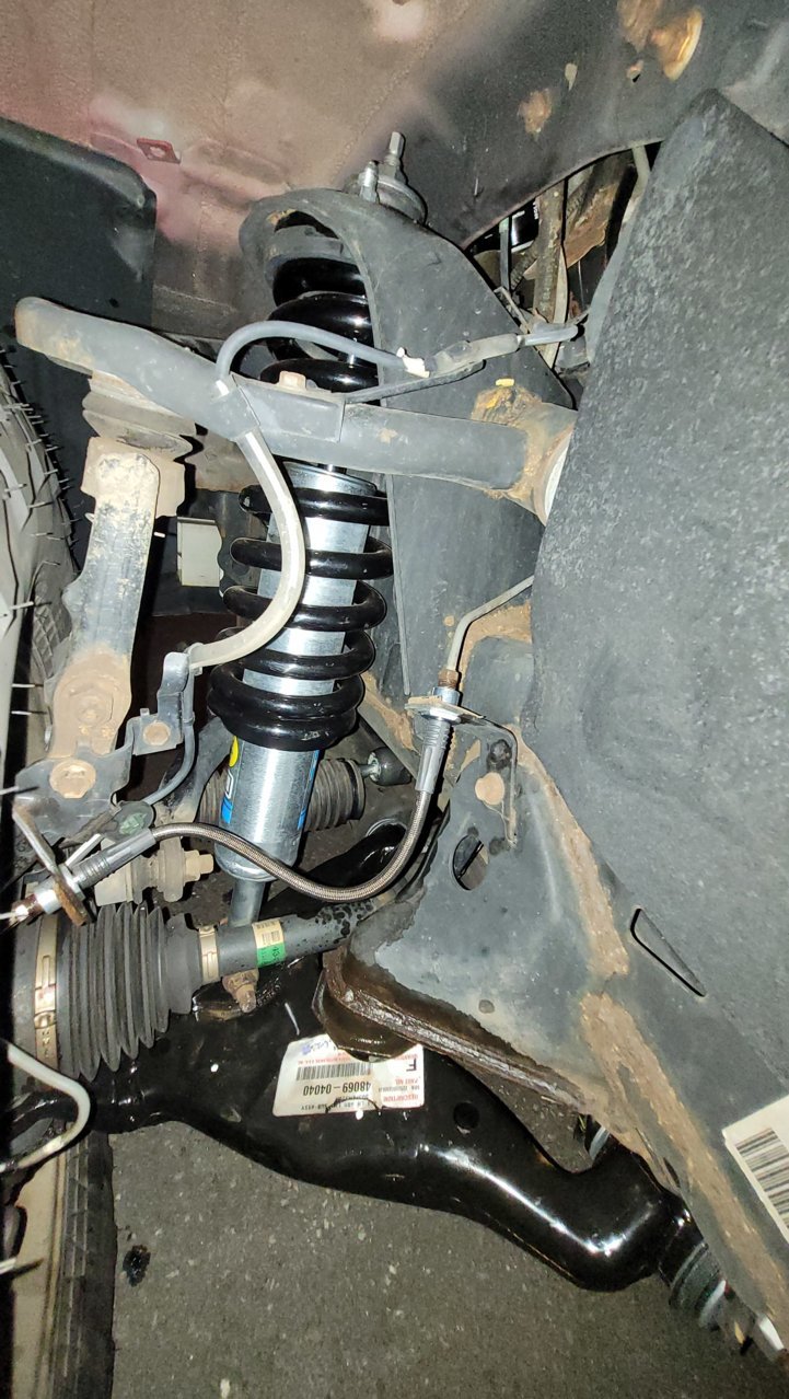

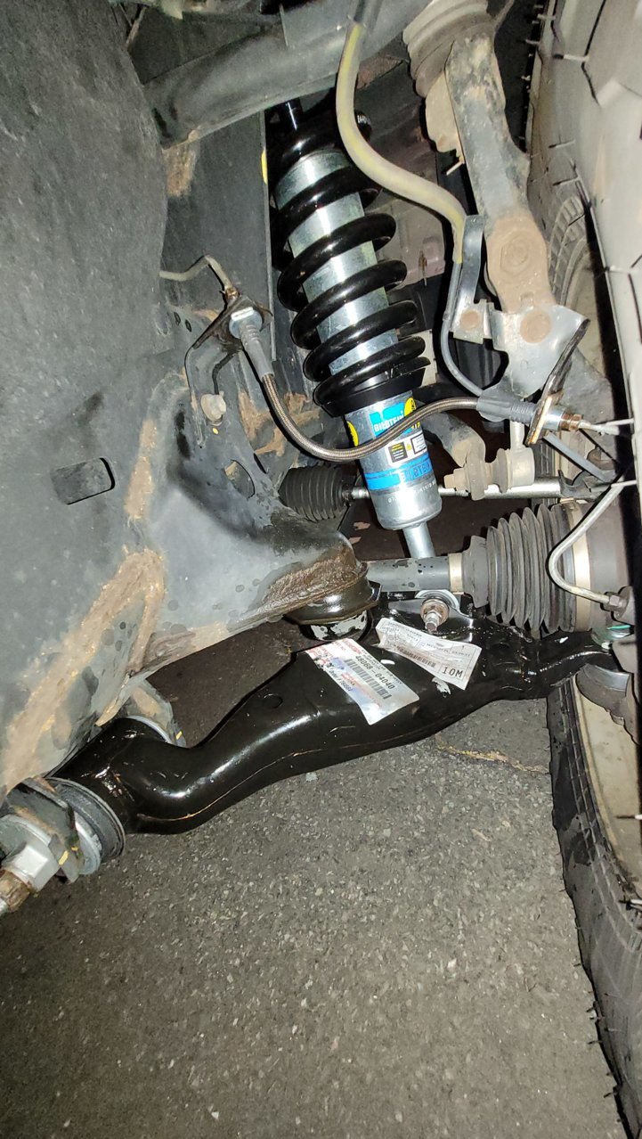

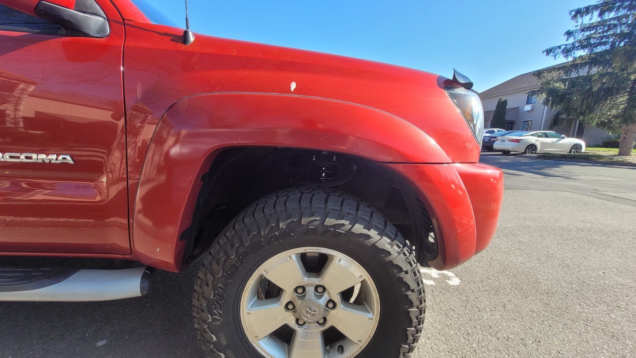

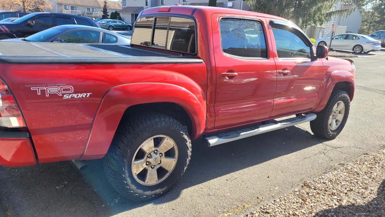

    130k miles and a happy "congrats" to my taco. New 6112 Bilstein's (1st clip), Taco lean spacer, Stainless steel brake lines, OEM LCA, Camber bolts/hardware , Inner/outer tie rod ends, and all of the OEM nuts and bolts to put it all back together again.
    I got the work done by my local shop who has been working on the truck for a while
    I also ended up needing Inner tie rods, those were pretty bad on the truck. They aren't on here, $136.89 each side from the same parts store. https://toyotaparts.mcgeorgetoyota.com
    I picked up the truck today. Holy Hell the difference is AMAZING!!! The front end feels completely different from all of the new hardware. Planted and responsive, no extra movement when pulling into parking lots and going over speedbumps. The shocks still needs to settle some and soften up but the initial stiffness is not terrible at all.
    Currently sitting at 1.5" lift with it sitting level front and back. I was expecting at least .75" increase in height from the longer shocks and taco lean spacer. I set the shocks on the 1st clip. Once the shock settle I will remeasure.
    Before suspension install.
    1/2 tank of gas from center hub to fender
    FL-19.75"
    RL-21.25"
    FR-20"
    RR-21.5"
    =1.5" rake
    4/23/2021-picked up truck from shop
    FL- 21.5"
    RL- 21.5"
    FR- 21.5"
    RR- 21.5"
    Level truck front and rear w/ 1.5" increase in front height.
    Changing all of the front components at once instead of a bushing hear and there made a drastic difference in feel. Adding the stainless steel break lines are a change that are worth while if you have old rubber lines already. I've only had the truck for a little while and it is great. The shiny new bolts and white stickers don't look to bad either.

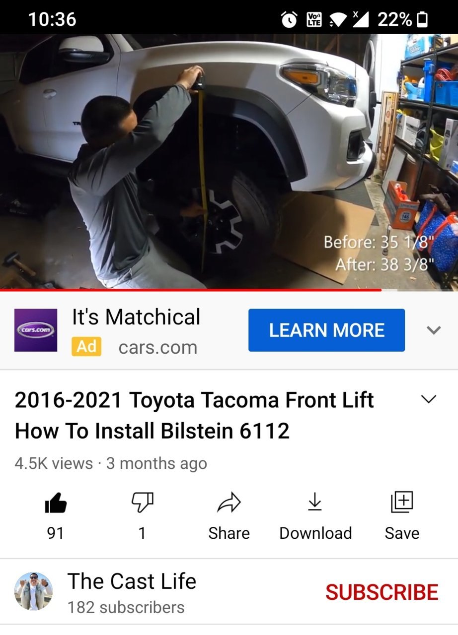

    Install for me Monday. Upgrade from 5100’s. Going with 6/5 with 600 lb springs. No weight planned. What measurements you guys have with this setting? Just curious vs height I’m at now with 5100’s. Thanks again super stoked.
  18. Apr 28, 2021 at 6:40 AM
    #4798
    Sig Taco
    Sig Taco Well-Known Member
    Dec 3, 2020
    #348594
    639
    2021 Taco DCSB
    Icon Rebounds 17x8.5 Toyo 35/12.5/17 JBA UCA, Bilstein 6112/5160, KDMax
    I bet 2.25"++
