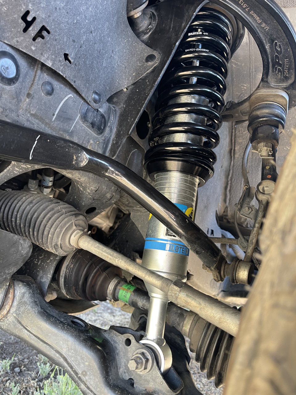

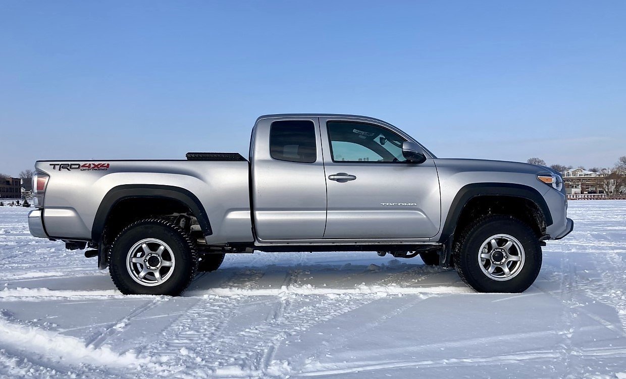

    you are right.. mine settled lower from right after install after using the truck off road on some rough stuff (ran over a few 7" inch curbs a few times to help) in comparison to just pounding along on smooth pavement
    last photos I took

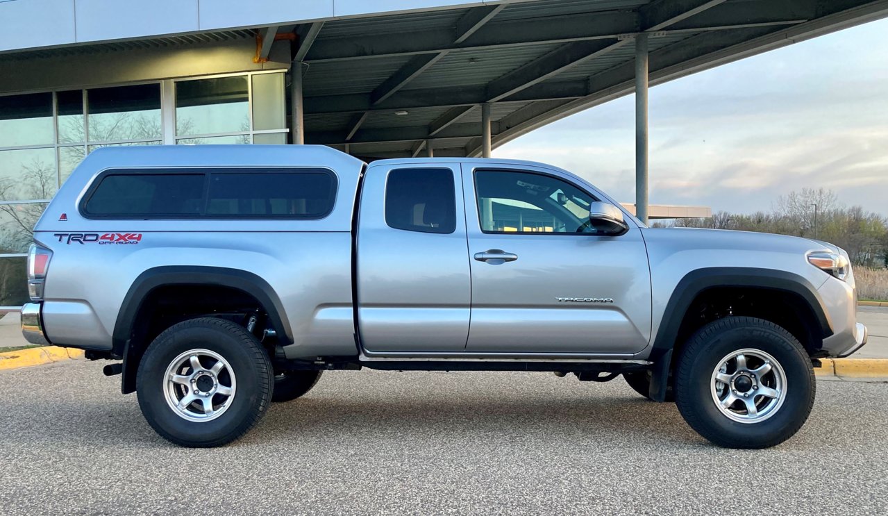

    Minneapolis, MN
    2021 TRD Off-Road Access Cab
    If I were you I'd expect very close to what Bilstein has on their site for the type of Tacoma you have and the clip position used. My AC on 5/4 clip postion was almost exactly what they speced within a 1/8" after the springs settled from some hard impacts.
