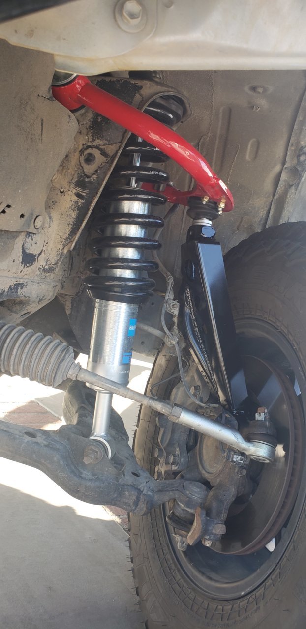

    20210505_172750.jpgrunning 6112 on 3rd setting on both sides with coils that come with the shocks(i think they are 600lb). sitting around 2.5ish lift with a 55lb tubular front bumper. kyb strut mount and spacer for taco lean, no sway bar with spindle gusset. jba uca with 2 spacers that dont fill the gap completely so they rattle... need to get a bigger spacer or just live with it.

    Love it! Installing the same this weekend. Question.. why no brake dust covers? Is it due to clearance with the gusseted spindles? I just got V8 4Runner dust covers for my big brake rotors to clear. Be funny and frustrating if they are spare parts already.

    took them off just to see how they look tbh. Maybe better rotor cooling? I've only had them off for a couple of days so I can't really say yet. I Will probably put them back on bc I think they are a little exposed to small rocks that kick up when offroading
