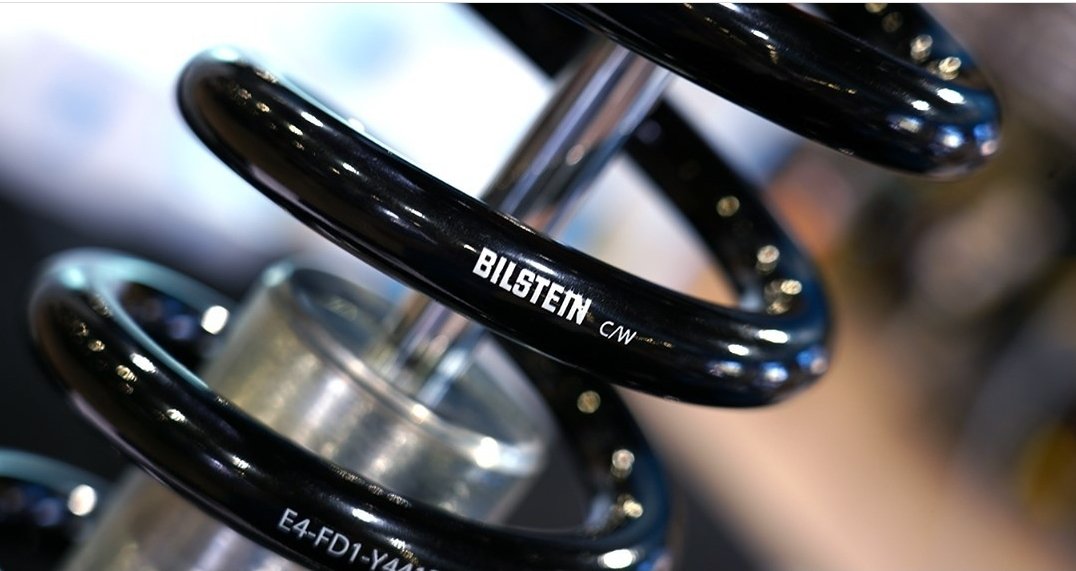

    Somewhere on the spring it should look like this....if it doesn't......they might have put eibach brand springs in there. If they did, bilstein will not validate the warranty. Are the springs completely black?

    My Eibach springs have their part number on them.

    Eibach is the manufacturer of springs for Bilstein.

    I completely agree with you, the only problem is, is that when I spoke to Bilstein directly when I switched over from 600 pounds springs to 650 pounds springs, they told me that they get the springs from eibach, test them, and then recoat them and brand them with their label and number to make sure that it was tested to be the right poundage. This is why Bilstein is so picky about what springs go on their shocks. I guess they are fickle lol.

    I did not realize they were that particular. I wonder if it is for real, or just for marketing?
    I suppose I shouldn't tell them I'm running Eibach 700 lb springs....

    that is actually a very big no no lol. in speaking with one of the managers over there, they had stated to me that if anyone chose to put a 700 pound spring in the 6112's it would not only void the overall warranty, but also could potentially be dangerous because the shock itself was only made to fit up to a 650 pound spring and there is a possibility that it might break through the top hat of the shock. I know that a lot of people run the 700 pound spring recognizing that it fits and even some dealers sell 700 pounds springs with the 6112's but Bilstein themselves state that it is highly discouraged and not recommended for safety. Just passing along the information.
