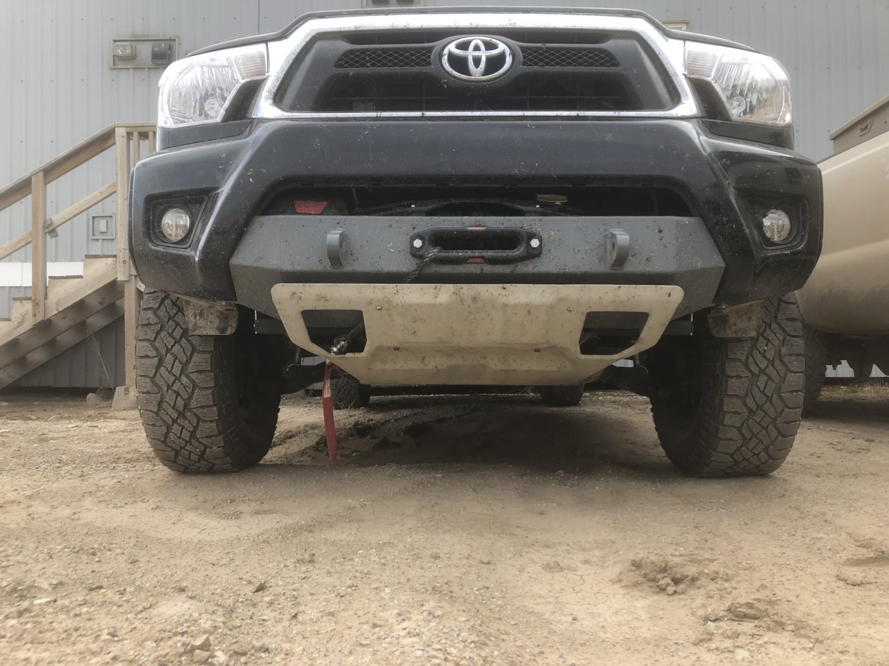

    Oh he thiccc…
    to summarize then,
    my US Offroad slim steel bumper and inboard warn-8s winch on a stock 4.0 AC 4x4, using 3x13 650lb springs at 75% preload (clip 4 of 5) got me 1.75” of lift on the driver side.
    and your
    full steel bumper, steel engine skid, steel sliders, dual (three???) battery, fridge??, topper, 4.0 AC 4x4, using 3x14 700lb springs at 75% preload got you ~2.75 - 3.00" @TacoEspecial
    If that’s true then I think that gives a good representation of what spring to pick based on ones setup and expectations. And let’s not forget 2-2.5” is the max lift this shock should do…

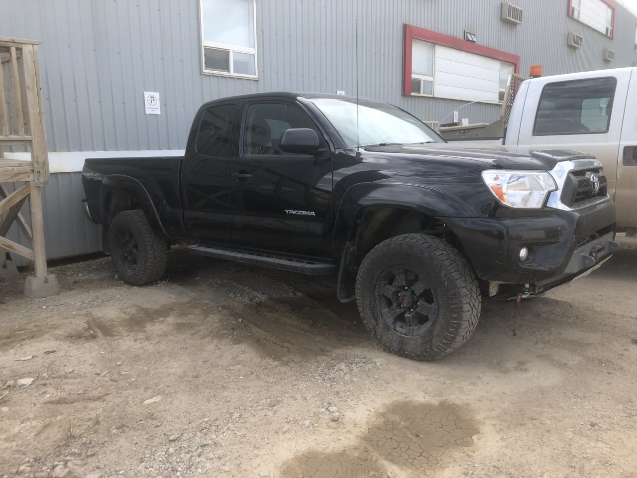

    work it... work it! okay now one from the front-wanna see dat gap!

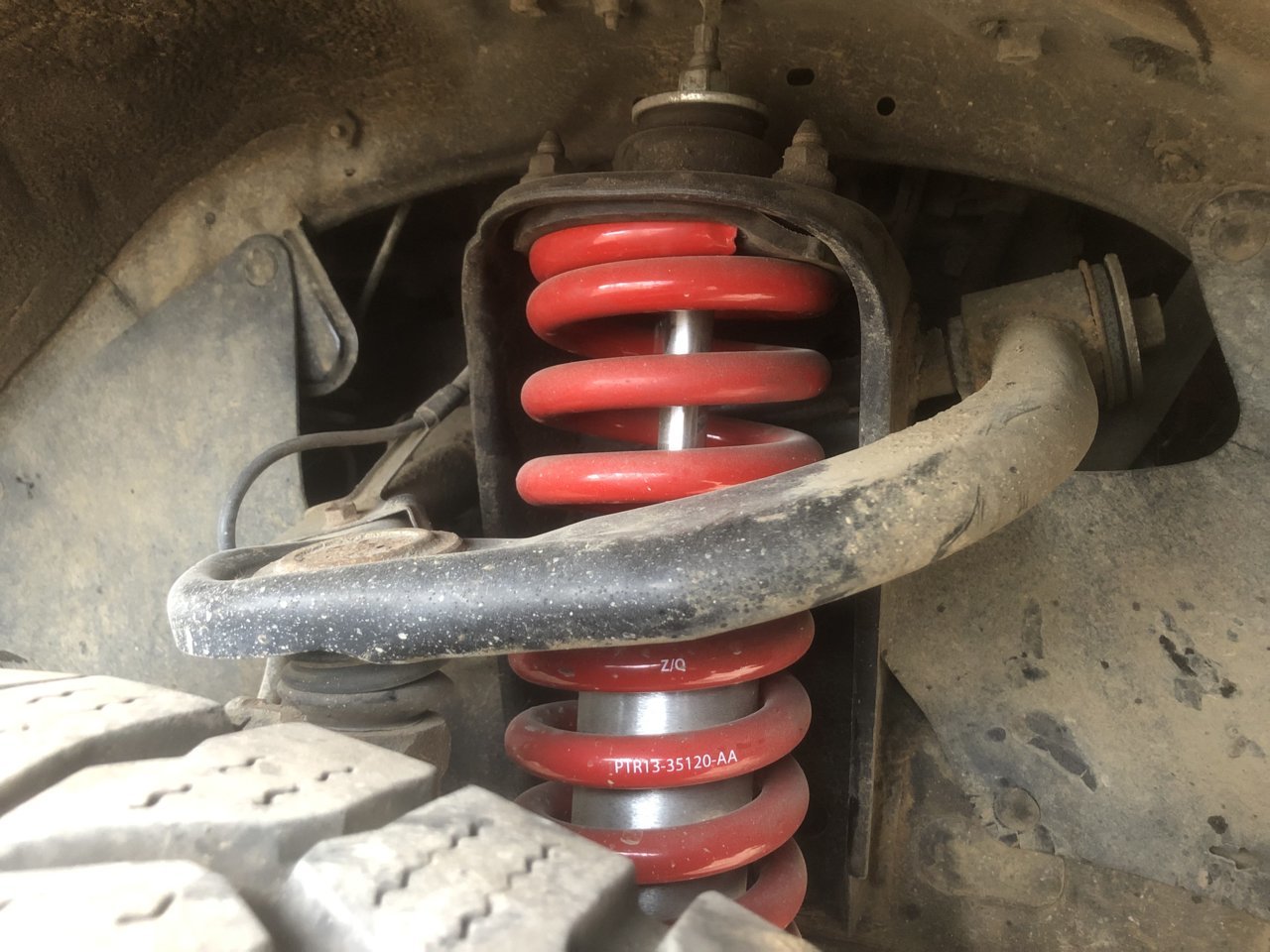

    TRD BAJA Coils
    PTR13-35120-AA
    650# 3x13
    75% preload
    Bumper and winch only, no other mods.
    1.75” D/S, 2.00” P/S

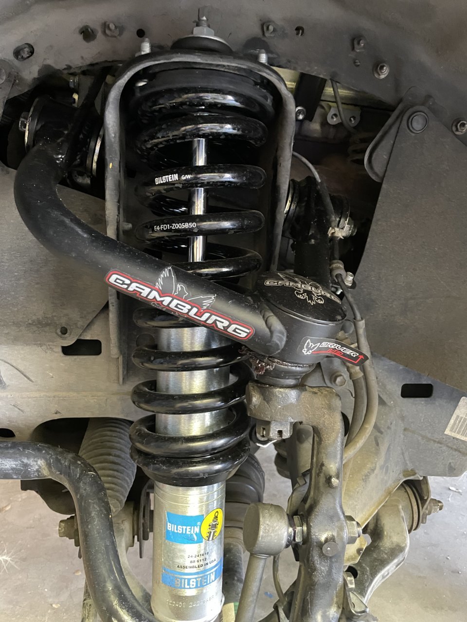

    Oh yeah, I added a Camburg UCA.
    Think that's giving the extra up travel.
    I'm getting it realigned today.
    71tattooguy likes this.

    The springs that came off my 6112s are 14" not 13".
    Here's a pic with their part#.
    crashngiggles likes this.

    Interesting I’ll have to measure mine too I guess. Mine have the same P/N. The only thing I did was stand them up beside my TRD BAJA springs and noted they were the same height, then installed the BAJA’s

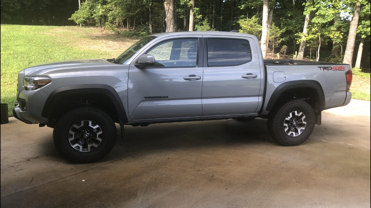

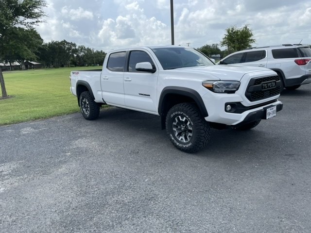

    Just installed with 4/3 front and 1” block in rear. 265/75r16 Goodyear Duratrac’s.
    62276F72-3BE3-463E-9236-7BFE668E6015.jpg A460D5E6-BD4F-4E14-A42B-1F028AB3B432.jpg
