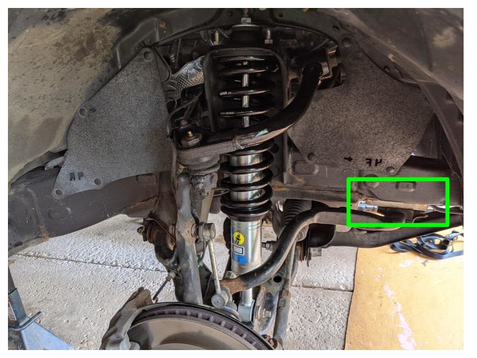

    I'm in the process of installing 6112/5160 Bilsteins on my 3rd gen. I disconnected the sway bar to install the front, and can't seem to find a way to reattach it. Preload is at 4/3. Any tips?

    I just put 6112s in this morning. What's the issue you're having? Can't line up the linkage on the sway bar? Did you try putting a floor jack under the LCA to push everything up? That's what I had to do on both sides.

    I can't seem to get the linkage and sway bar bracket to attach at the same time. Currently have the linkage installed, but the sway bar bracket is over an inch below where it should be. Tried it the other way and couldn't get the linkage attached. Jacking up the lca didn't seem to help.
    I've only done one side, should the sway bar install wait until both sides are done?

    Do you have a sway bar drop kit? You may need one. (Example link below pic.)

    Also, yes, the sway bar should be one of the last things you do - so both sides should be done before you try to re-connect.

    No sway bar drop kit. I'll do the other side, the imbalanced ride height of just one new coil-over could be interpreted as sway, causing tension.

    Sway bar should go on pretty easily and is the usually first thing to come off and the last thing to go on. Snap a photo of the orientation.

    Sway bar went on no problem after both sides were completed. Duh!
