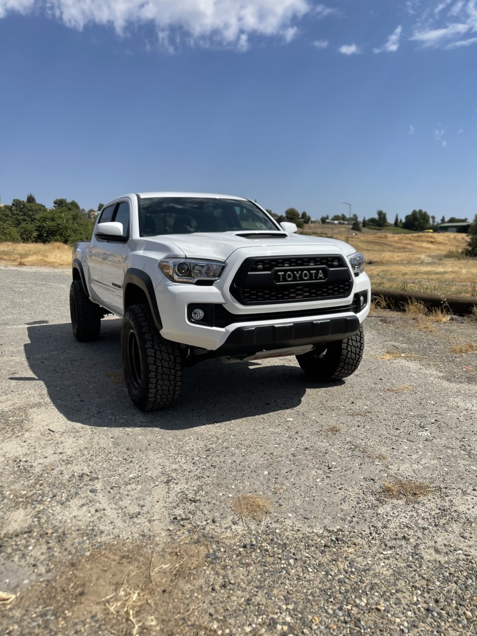

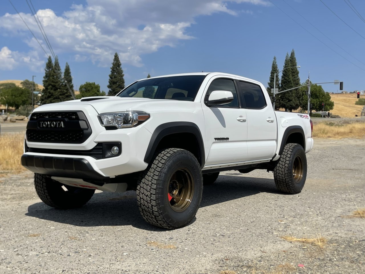

    No problem. I think the 1/4 inch spacer made a big difference in the front....went from 38.5 inches ground to fender to 39 inches...I know it don't sound like alot but you'll notice it once it's on.

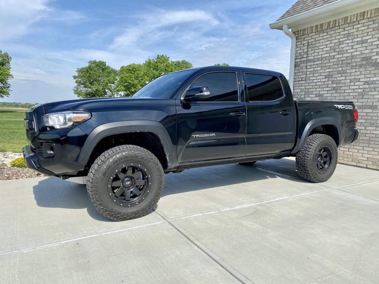

    3/4 will put you pretty much dead level. May want to go 4/5 with the AAL if your wanting some rake. Here is mine on 3/4:

    Thanks! That's exactly the stance and height I want. I'm putting on 265/70/17 tires so I don't want the truck sitting too high making the tires look small. How is the ride quality with the 4/3 setting?

    Indy
    2018 Black DCSB TRD Off Road 4x4
    I really enjoy the ride, much better for me than the stock Off-Road set up. Firmer than stock but really soaks up the larger stuff nicely. No more bouncy feeling and eliminated the nose dive when braking. I would just go with the 3/4 set up and not even worry about the AAL if you like that stance and going to run 265s. I am on 265/70/17s and the stance is very nice IMO. With that being said, I can’t leave well enough alone. I have some new wheels sitting in my garage that have a -25 offset and I plan to put a 285 on them. I will need to bump up the fronts a little and will install the 3 leaf AAL I have had sitting in my garage over a year now. I just hope it doesn’t kill my ride quality, since I really like the ride on 3/4.

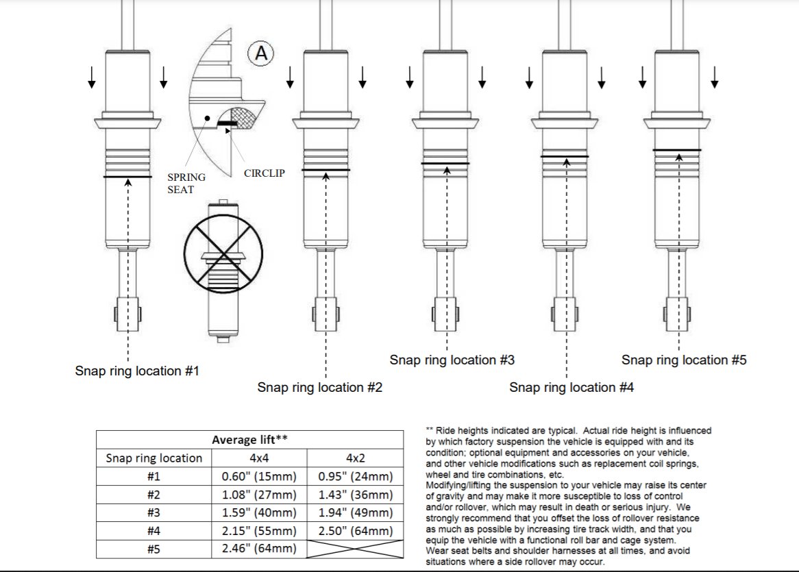

    Specs with the 600# spring give you 0", .95", 1.43", 1.94" and 2.5" for the prerunner.
    Go for it :thumbsup:

    For a 2006 Tacoma (install instructions)
    https://productdeskapi.cart.bilsteinus.com/media/products/bilstein/E4-WM5-Y463A00_1.pdf
    contrary to what is posted above there is no setting for 0" of lift per Bilstein for a 06 prerunner.
    In addition, Bilstein does not recommend clip position 5 for the 2006 pre-runner.

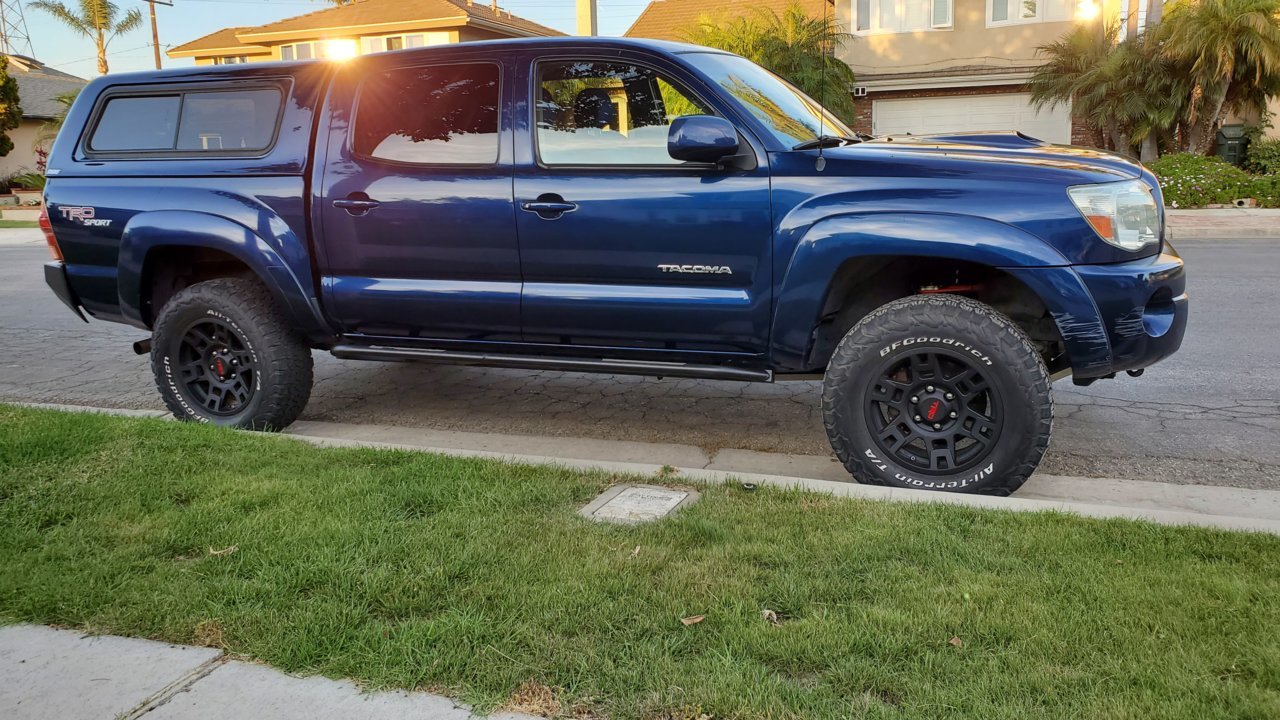

    3rd notch on the 6112's.
    In the rear I pulled the top overload (0.6 inches) to achieve limit lift to 2-ish inches and level truck.
    Tires are 265/70-17

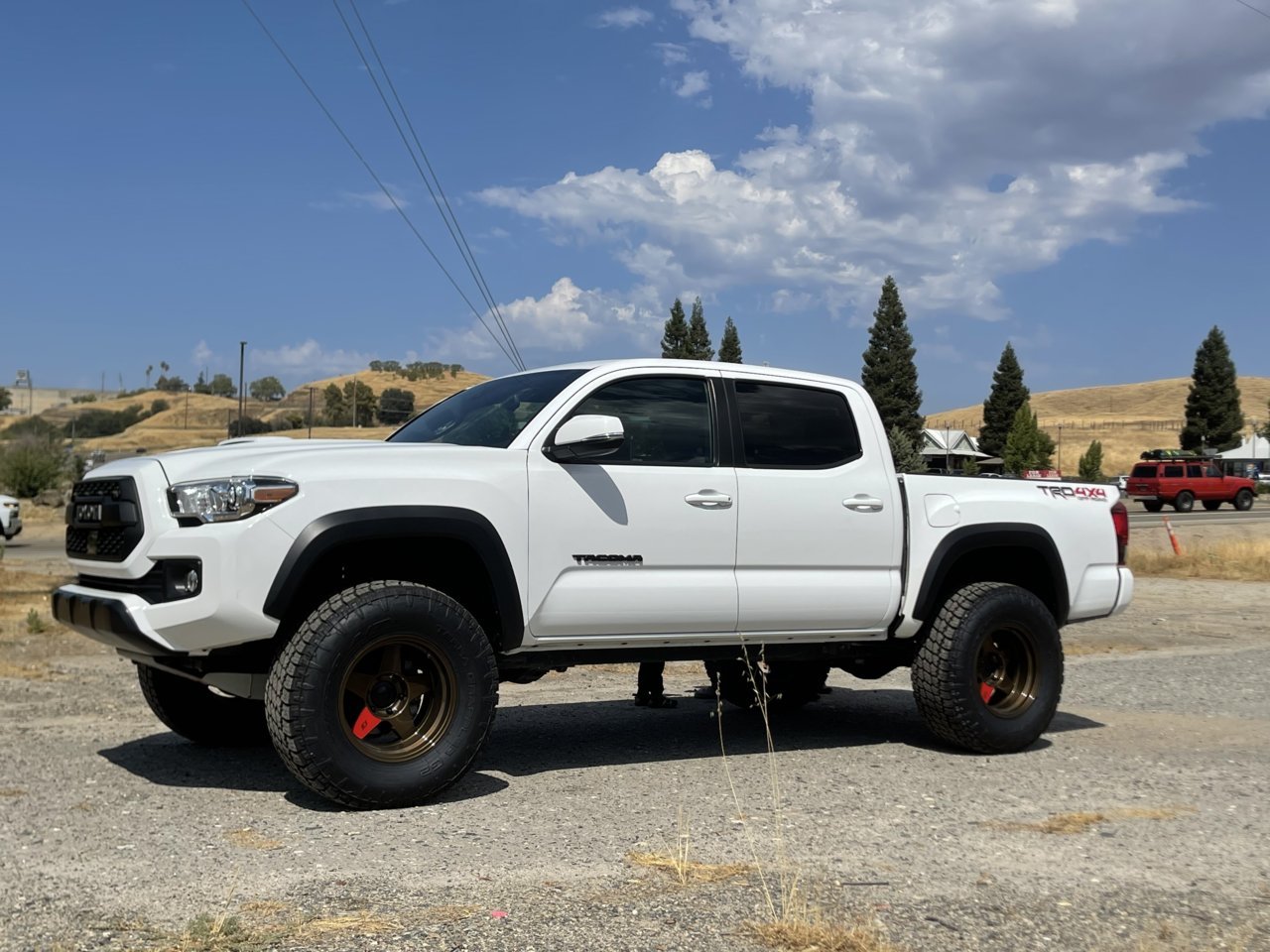

    151
    Love the truck! Im looking to buy 6112's now.. The chart says 3 notch gives you 1/2" of lift in the front? Is that all that truck has of lift? it looks more
