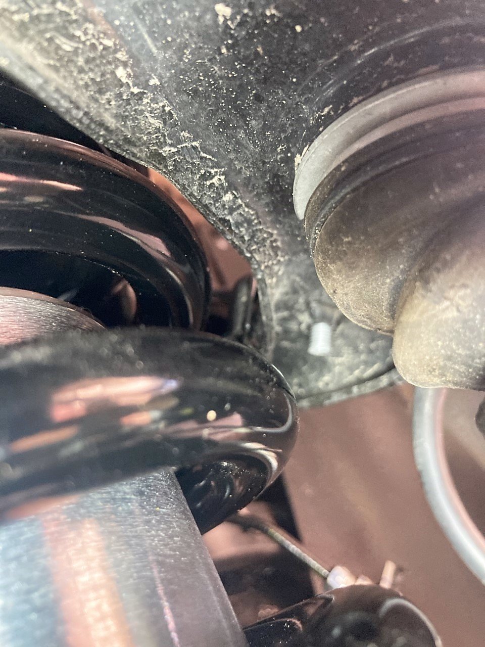

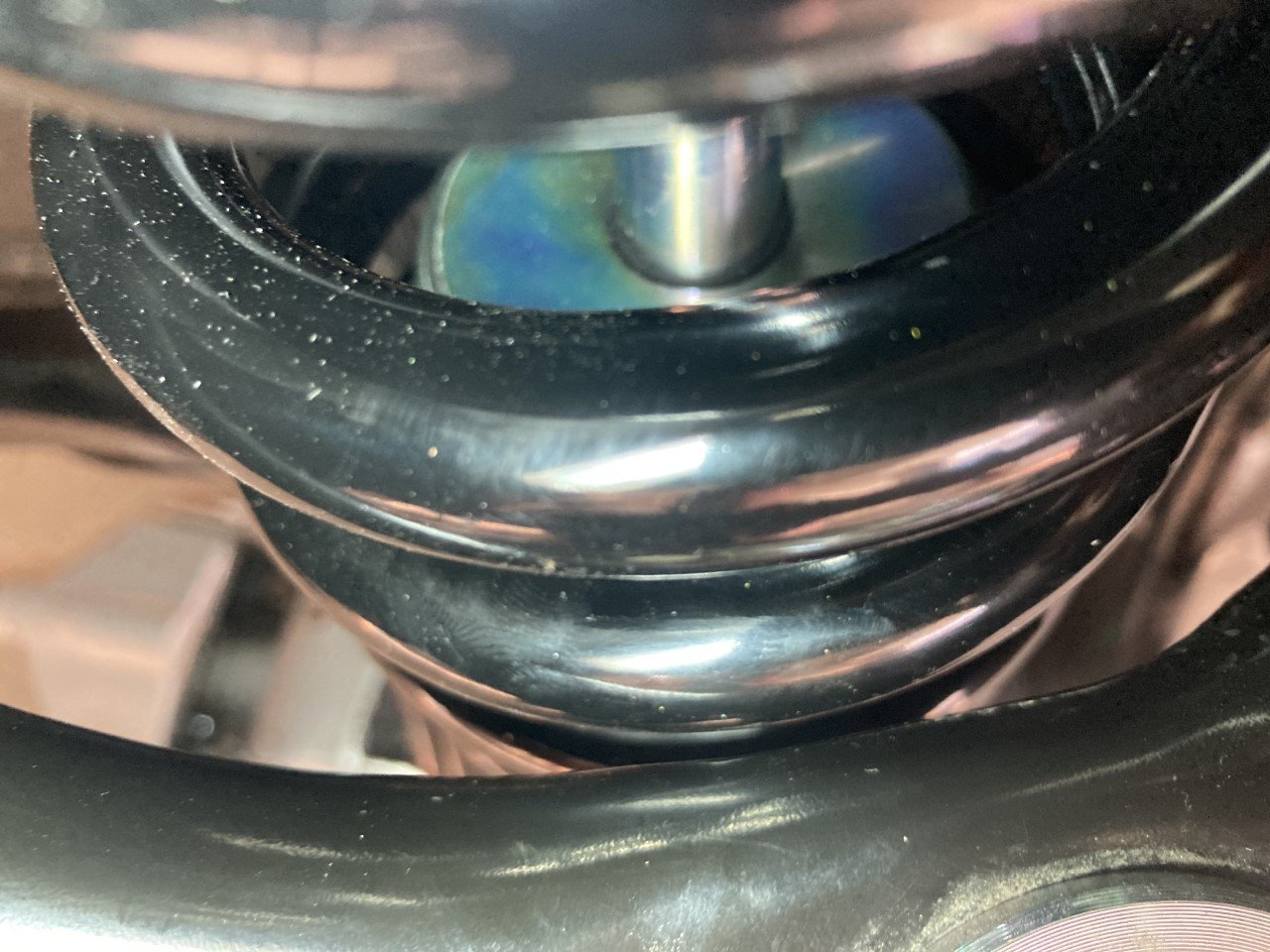

    Again, if you go spacer on top of assembly make sure you get full droop and ensure that the spring does not contact the UCA. Also make sure on full compression that your dampener is not the travel limiter and that your bump stop is.

    This is where you have to check for interference with spring and UCA if you add a spacer.
    I do not have a spacer in these photos but there is very little clearance at full droop.
    When you add a spacer it allows more droop and the control arms will go down further. When the UCA drops down more it gets closer to the coil spring or hits the coil spring.
