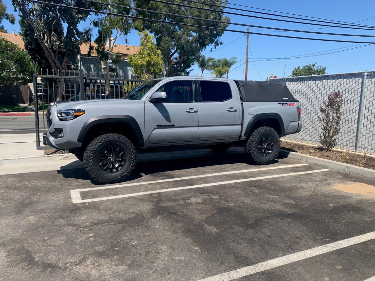

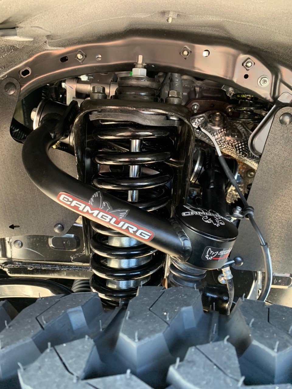

    Purchased, then threw all these parts on two days later. Loving the setup. 6112 on top level, 1/4 plate drivers side, Camburg UCAs, icon 3 leaf AAL and 5160s in the rear. Really looking at upgrading the leaf packs as i didn't get as much lift as I thought in the rear, or may add the overload spring back in.

    It may take a bit for the front to settle especially if you have not used the truck offroad on rough terrain. I'd give it some time before changing the rear suspension any further.

    hows it ride clicked all the way up?

    Will do, going out to Anza Borrego this weekend to play around with it. It's only been two weeks on this setup.

    It's really not bad, the front feels like it soaks bumps up really well. Rough at first but after a few weeks it seems to have softened up considerably. The rear leaves a little to be desired, possible leaf pack change in the future i think.

    did you have to trim much to get your tires to fit?

    I had to trim the back corner of the fender, not much but I will need a cab mount chop, rubbing on that. These tires are a little larger than my same size BFG KO2s that i had.

    makes sense, BFG's run a bit small imo.
    285/70x17? or 295/70x17?

    My Geolanders now are 285/75/16, stock wheels

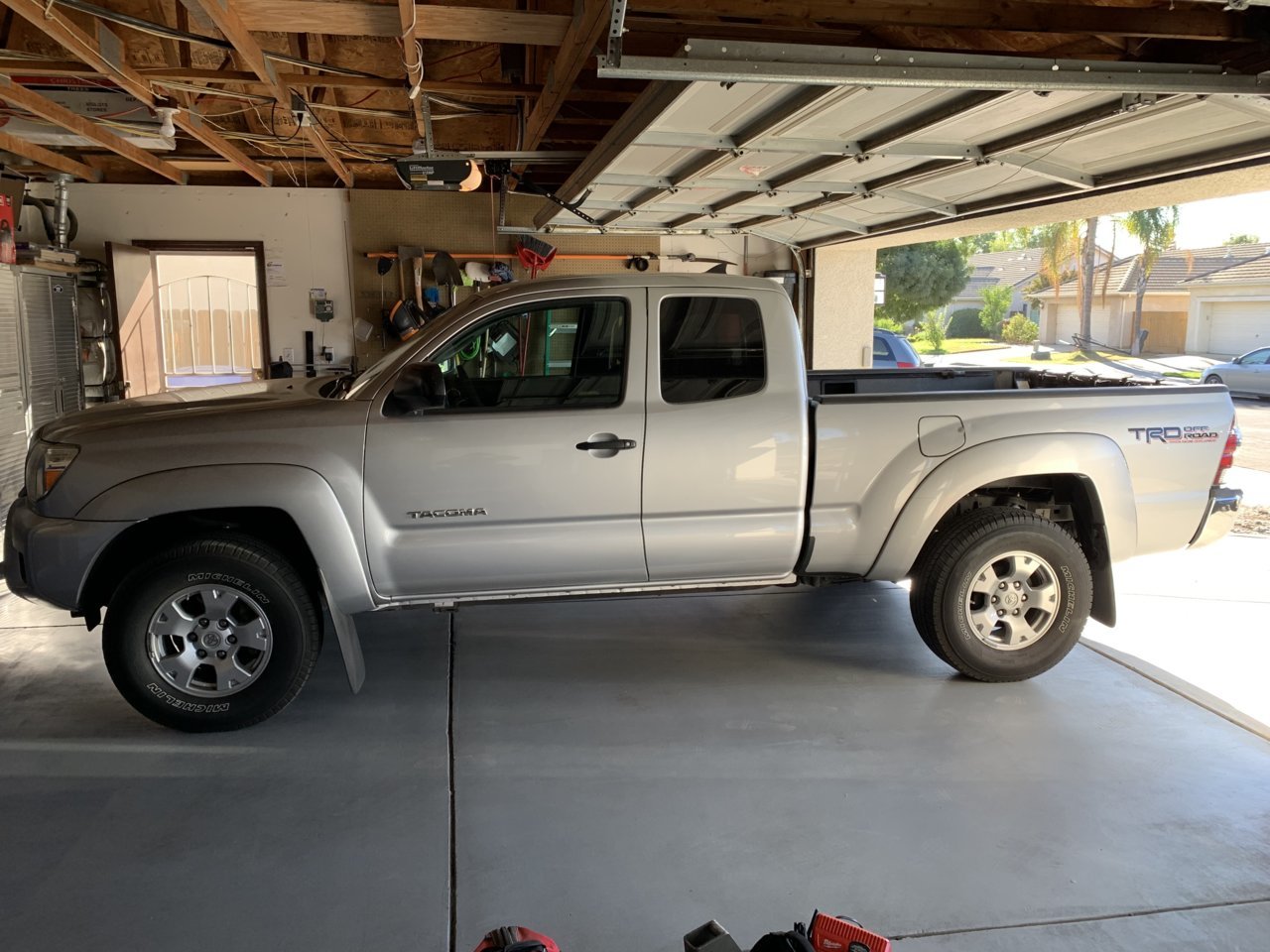

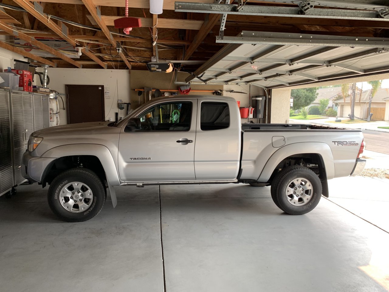

    Bilstein 6112’s (4th snap location) HeadStrong OffRoad 1/4” taco lean spacer Icon Sway Bar Relocation Kit SPC LR UCA’s Bilstein 5160’s w/ reservoirs Icon 1.5” AAL 17x8.5 Method MR305 NV’s in matte black LT285/70/17 Falken Wildpeak At3w - C load GoRhino Dominator nerf bars Fox Overland Tailgate Bike Pad All Pro Off-Road Low Profile Front Bumper w/ hoop Cab Mount Chopped + Fender Liner trimmed TechDeck RAM Mount
    Bilstein 6112's on the 4th snap location + 1/4" taco lean spacer on driver side. SPC LR UCA's set to neutral - D position. Bilstein 5160's w/ reservoir + Icon 1.5" AAL in the rears.
    Got about 4" of lift right after installing, but settled down to about 2 1/4" after a few days.
    After an alignment: 2 degrees caster, 0 camber, and 0 toe.
    Drives excellent, 0 vibrations. Way better than stock.
