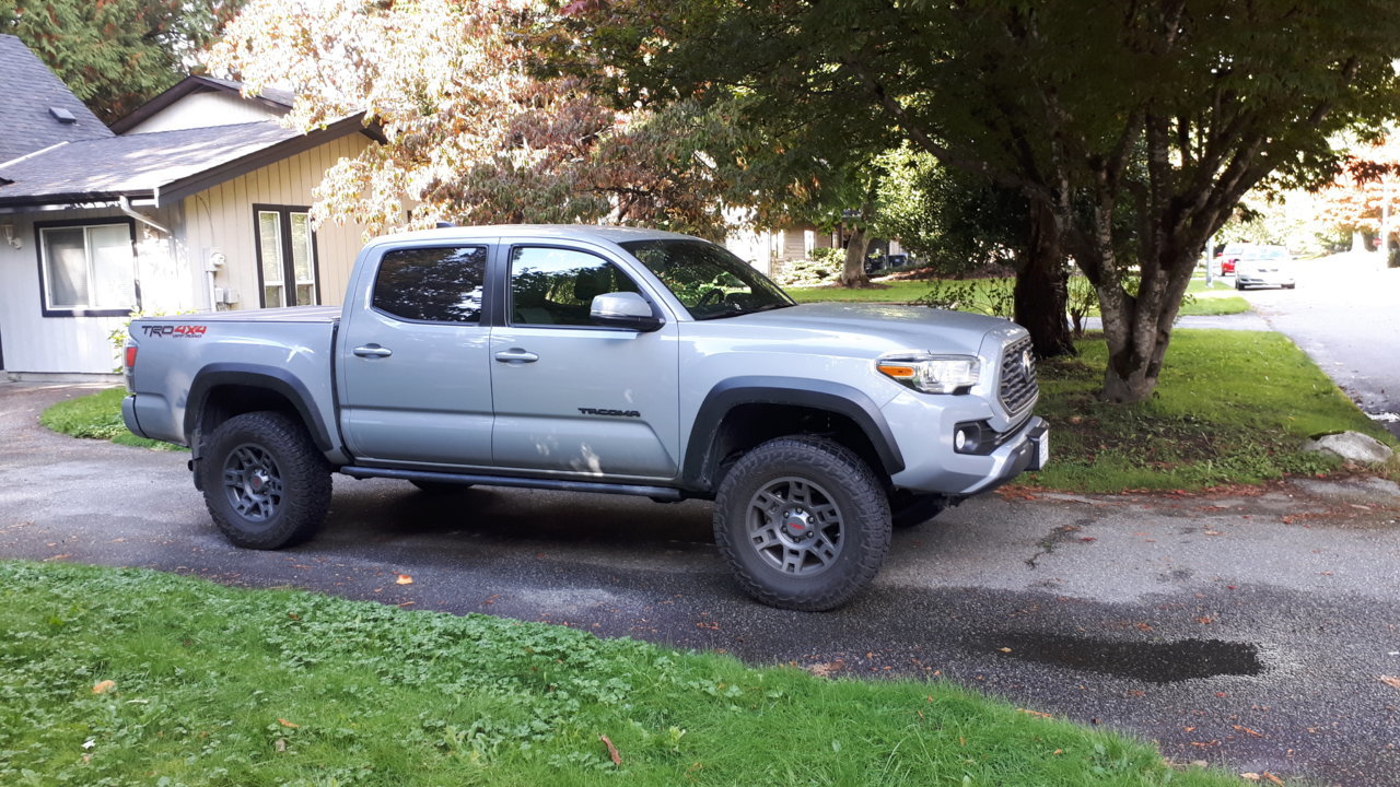

    I'll be crawling under the truck in the next couple of days to make sure all the hardware for the skid plates and sliders is nice and tight. I'll have a look at the sway bar while I'm there. Thx.
    No huge bodies.

    Tightened the skids and sliders up and still have the thump noise on passenger front. Sway bar ends don't appear to be touching anything. Next I'll start by taking the skids off and continue the process of elimination.
    Meanwhile here's some 6112/5160 on 6/5 clips with rear aal

    So I'm running the same setup up front as you, but I'm an access cab (so can only run 5/4 up front I believe) and instead of full steel RCI skids I have the aluminum RCI skids, and I don't have sliders...I lost a fair amount of height just installing the alu skids on my 600lb springs so I got some 650lb to put on but haven't yet (I'm also going to be adding a SSO full plate bumper). I can imagine with your setup you may have lost a bit of height too since you are even heavier than I am. I was having some weird clunks also and it was my sway bar endlinks, I replaced them since one was torn open and that noise went away. I added front superbumps and that has helped, but it looks like you added durobumps as well. I did notice I have some scratches on the coil and UCA so that might have been causing noises as well. I thought maybe I was topping out when I first installed them, I'd notice a thump sometimes going over speedbumps but that has gone away since it has settled quite a lot. It's a pain tracking down the noises on these things sometimes!

    Much appreciate the feedback. I took the skids off this weekend and that did not solve the issue.
    I talked to a local off road shop today and I'm going to take the truck in for a diagnosis Probably get the SPC ucs's and the ecgs bushing installed as I have a small vibration and my steering is pulling a bit to one side.
