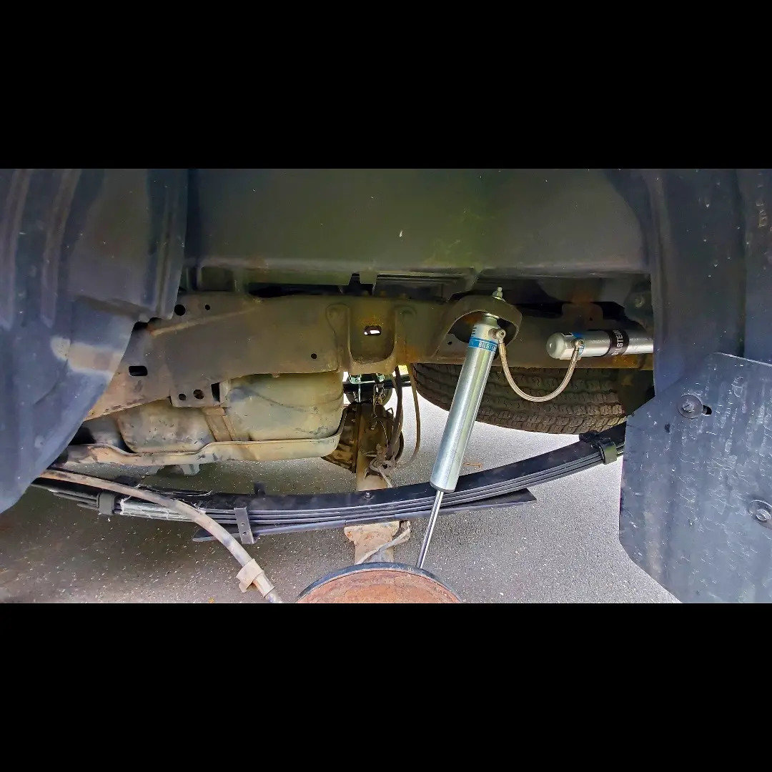

    Yes

    Which leafs are those?

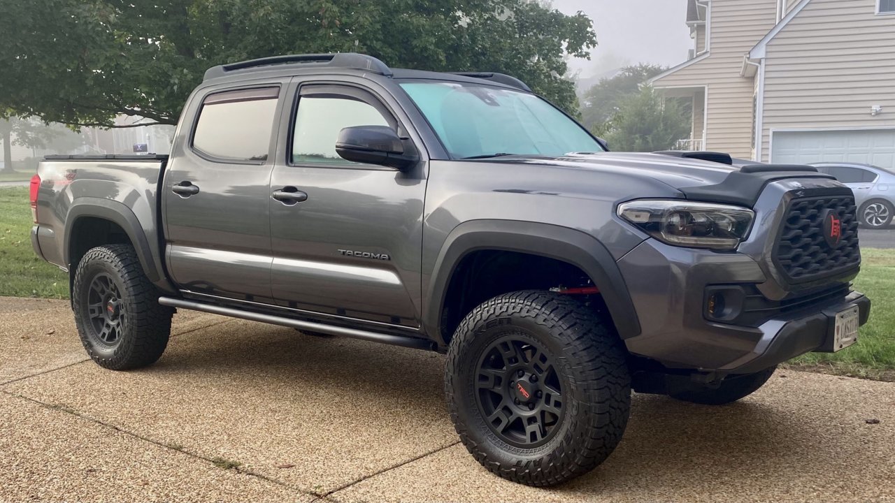

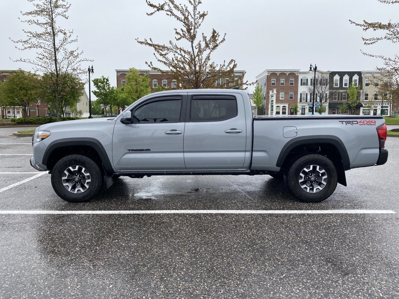

    Bilstein 6112s front (5/6 clip setting) / 5160s rear, JBA UCAs, and Icon RXT Stage 1 leaf pack. Love it!

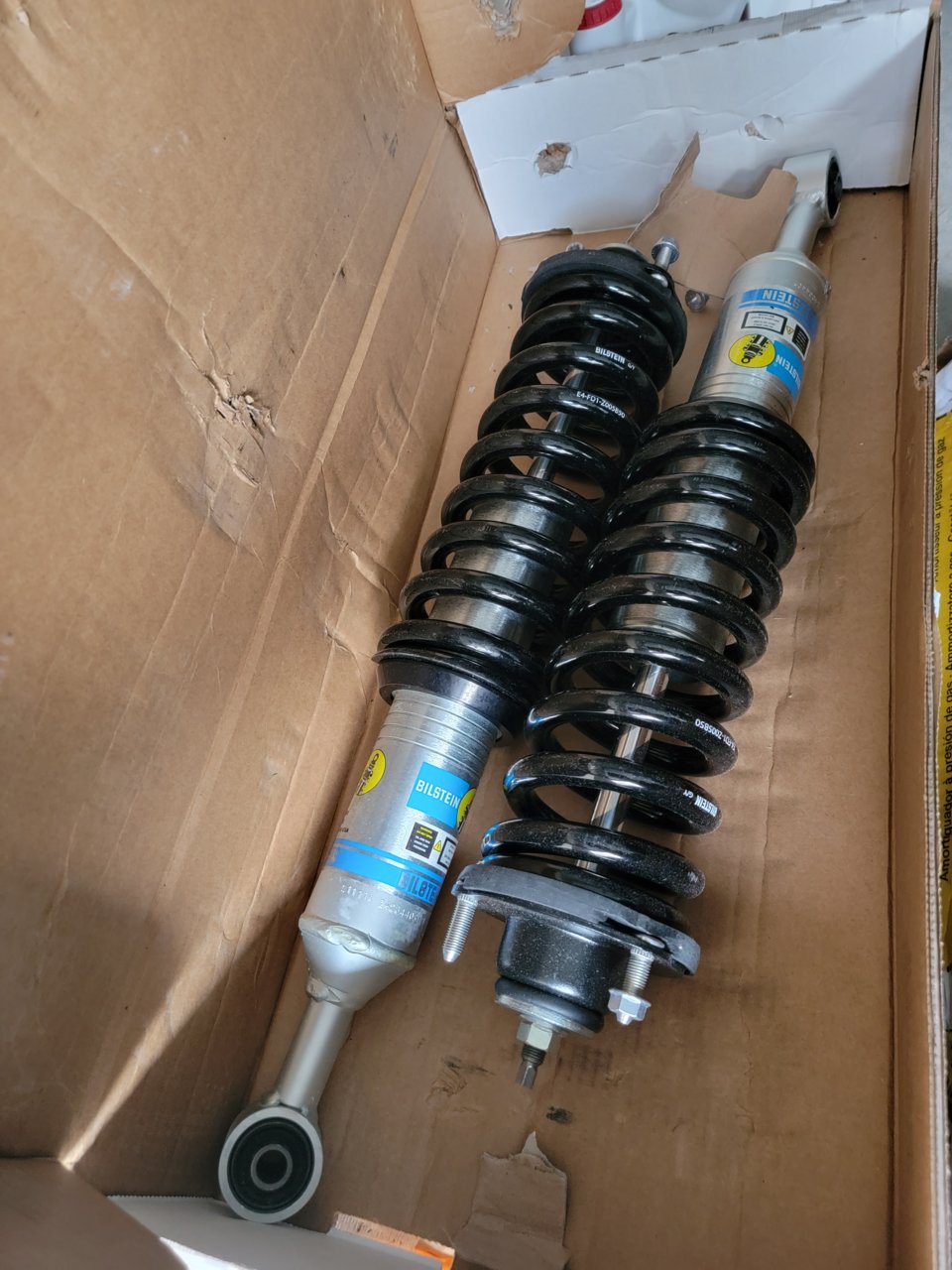

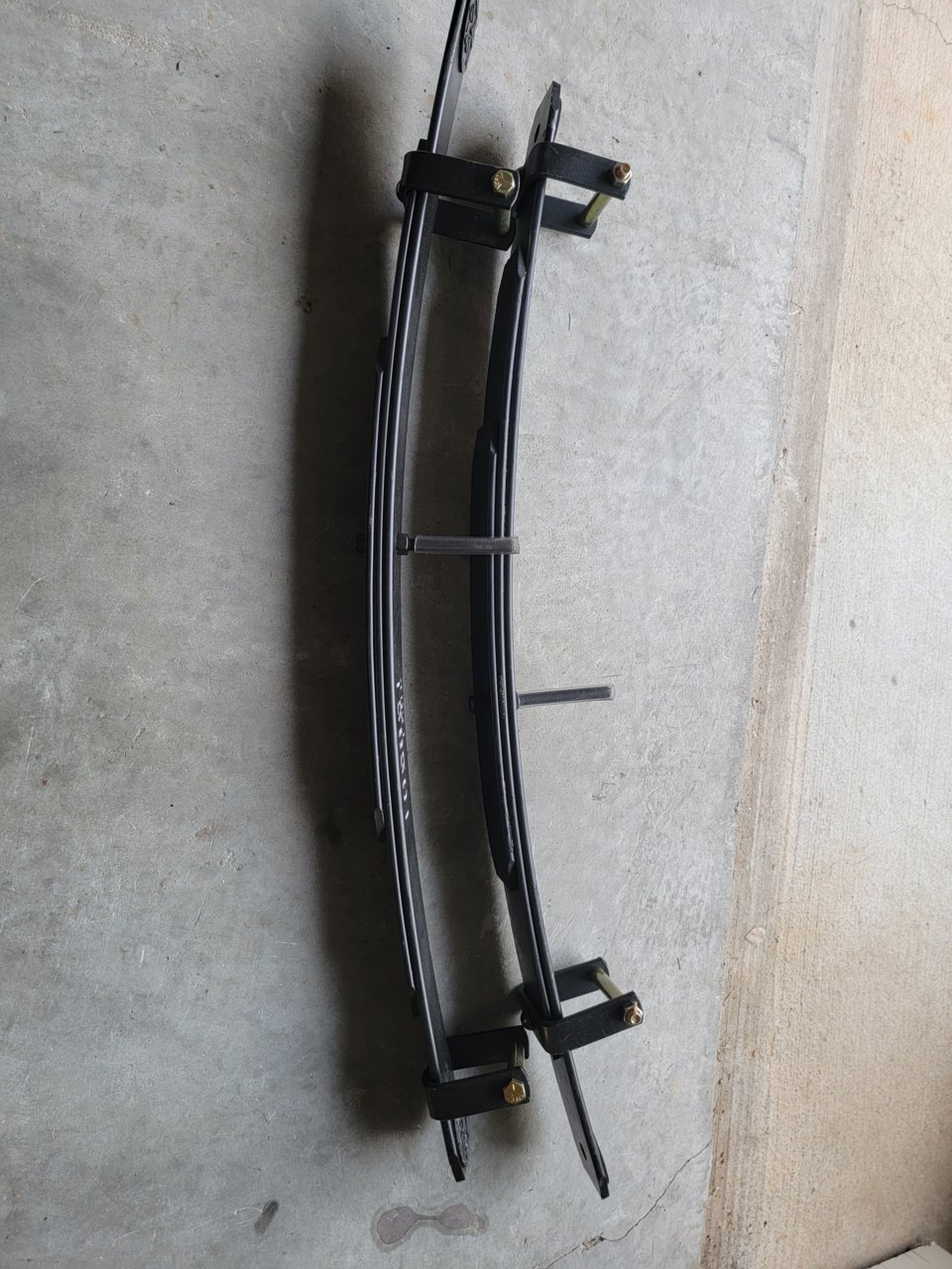

    Put in 6112/5160s on 5/4 with 650# coils, brand new ATS HD leaf pack, and a u-bolt flip 2 weeks ago. Broke it in last week, no crazy vibes, no drama, no idea how much lift but I was expecting 2 all around and got at least as much. Very happy camper here :D

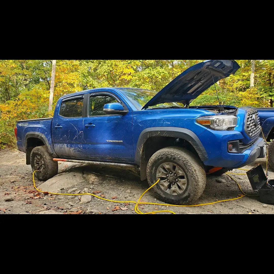

    Just an update for those who tried to help solve this or followed along.
    I took the vehicle into a local off road shop today for diagnosis. It looks like the noise culprit is the body of the truck hitting the ctoss member of the sliders. I did have this on my list of potential places but wouldnt have known without removing them.
    If you look closely you can see there is barely a gap between the slider and body. I am going to have the shop trim the body so there will be enough room for ample clearence of the sliders.

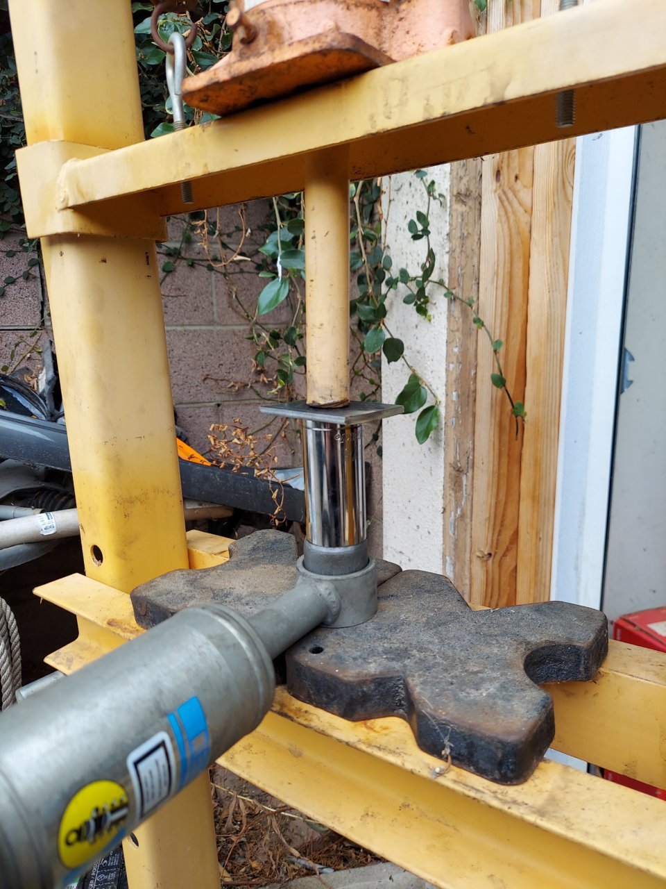

    In case you guys get a clicking /clunking noise coming from your 6112's. I corrected this recently for a customer. We replaced all the top hat bushings. Also replaced the lower shock bushing. Noise be gone.

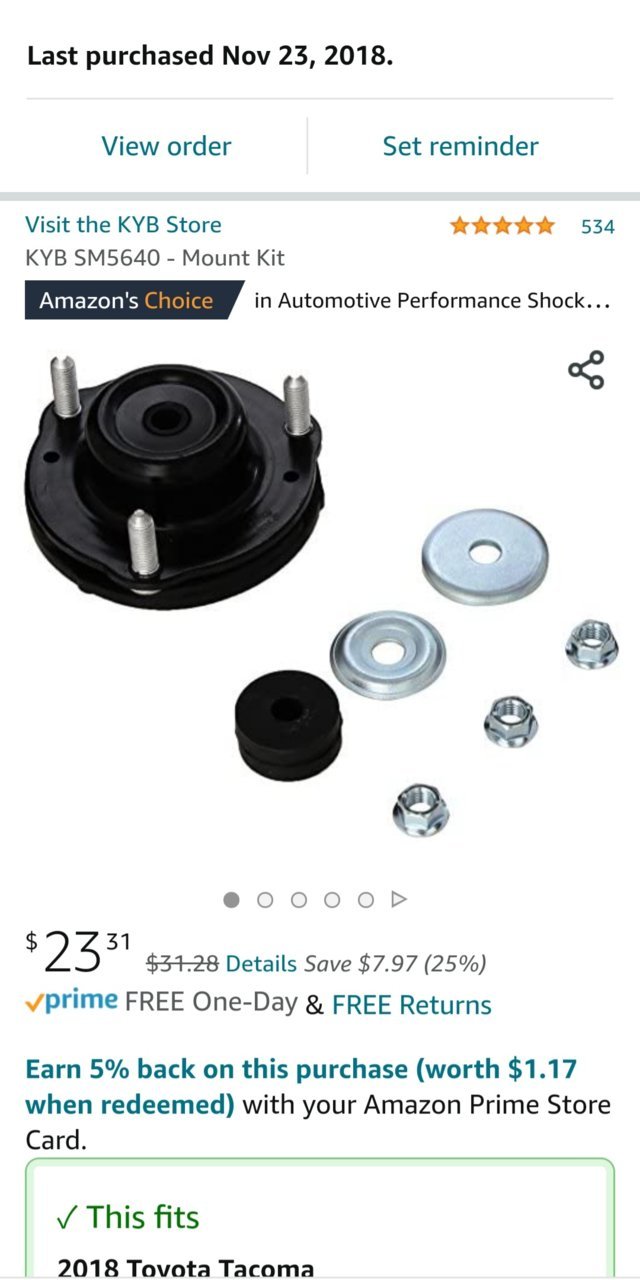

    I have the part numbers for the lower bushing but what part numbers are the top hat bushings?

    My favorite is the kyb kit. Has everything you need.

    I recommend KYB top hats to folks as well :thumbsup:
