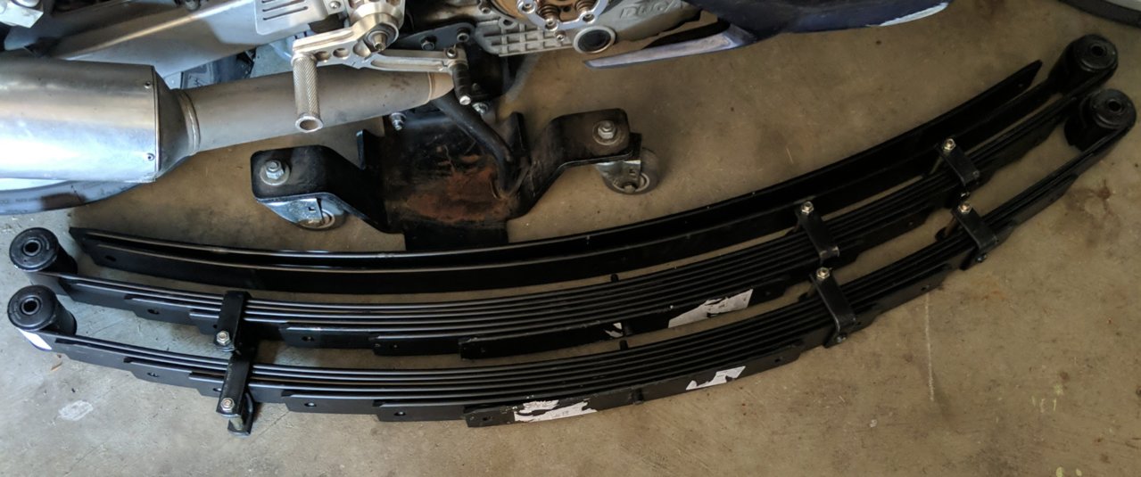

    I might have missed it, but how are you getting your rear lift currently? I am very positive on the RXT leafs, but there's no sense in replacing something if you already have somewhat of a solution back there. A couple hundred pounds is nothing major. You might be okay with a progressive mini-pack back there to get your lift.

    Okay so I don't want to just sell you something to sell you something, but it sounds like you could make use of a bit of an upgrade.
    My recommendation based on what you're talking about would be a set of RXT leafs on Option 1 replacing your OEM pack and AAL altogether. You'll get the progressive performance and a refresh there. As for the rear shocks I would look hard at how you use the truck. If you really need the additional heat dissipation that the reservoir offers then the 5160 is a great shock. If you don't, I would recommend a 5125 to at least get the additional travel of the Icon RXTs. 5125s are essentially a longer 5100.

    Sounds about exactly what I was thinking other than the aal getting the rxt.

    Am I going to need extended break lines if I do this to the rear? That’s been my biggest hold up tbh. I believe I’d rather do the AAL bc of cost at the moment. don’t really want to spend $600+ on leaf pack BUT it’d probably be worth it and makes me think I should save up a little more for that. I just paid premium price for nitto ridge grapplers on top of this suspension. Maybe I’ll get the shocks now and get leafs another time

    So if you just get an AAL atop your stock pack you won't need new lines. If you get a new leaf pack (Deaver or Icon) you would be right up against the limit of the OEM lines since they are longer springs than OEM. @tonered has RXTs and 5125s and I'm pretty sure he didn't replace his lines! And I know for sure he found the maximum limits of his travel.

    Exactly. The RXT Option 1 with the extended travel 5100s seems to be just perfect with the stock lines. Both mains and parking brakes. I checked max flex without the shock to be sure.
    There are some pics somewhere that show the standard 5100 rears are the same length as the stockers. I think they were mainly setup with the 2nd Gen in mind for +1.0in of travel?
    I've been flexed out on the trail a couple times since the full kit was in (go COVID!), and it works like a champ.
