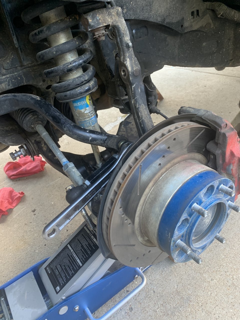

    26400C1C-5131-4F94-B586-0377CC6E5D2E.jpg 9A3ABA5C-0CC1-4A83-B9C0-8E31ABEF3B39.jpg Out with the 5100s in with the 6112s up front! Wow these make the 5100s look tiny. Need an alignment badly after install I screwed my alignment up bad. Got an appointment tomorrow morning at 11am. Also thinking I may have to get rid of the spider trax spacers bc I’ve now got a slight rub in reverse full turn but hoping it’s the alignment
