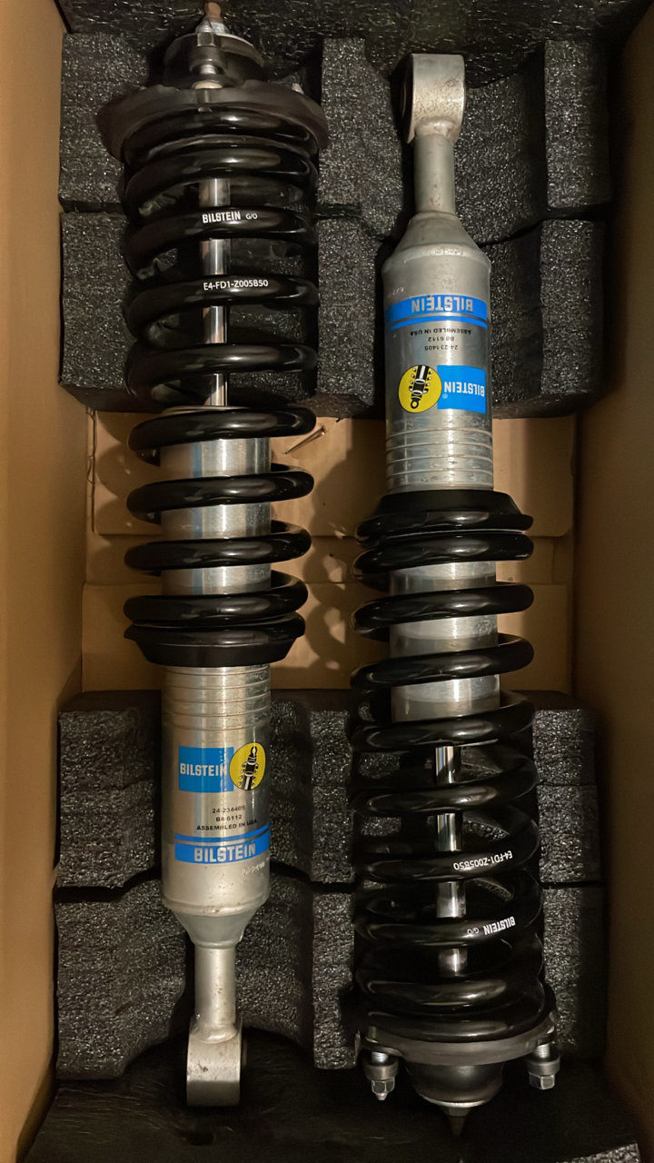

    To account for the taco lean, should I use a spacer on the driver’s side or lower the notch on the driver’s side? ie. 4/5 notch setting

    Lowering to the 4/5 settings is the correct way to do it. You want to lower the passenger side though. Driver side usually sits lower because of extra weight on that side.

    @Maxx is correct....you have a 3rd gen so having the shocks set at 4/5 (5 on the driverside and 4 on the passenger side) is the correct way to counter the taco lean. A 2nd gen 6112 only has 5 notches and a 1/4" top hat spacer can be used on the driverside to correct for the lean.
