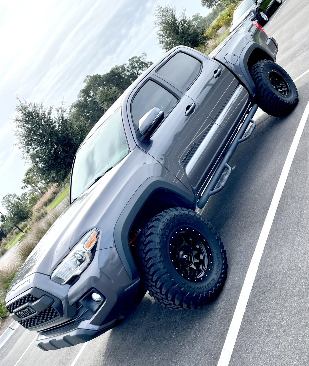

    A lot of help from this thread happy with how it turned out10BA0FC9-70B3-4B5F-A1B9-33BAB4B2BDBC.jpg

    are you at 5/6? any lean spacers? how much wacking/cutting did you have to do?

    Yes 5/6
    No spacers
    CMC and plastic trimming. Still rubbing a little, so back to cutting this weekend.

    I’m doing a set up very close. Looks great. Those are some beefy tires! Any issues runny?

    I’m thinking of going 265/75/18

    You'll be fine with that size
