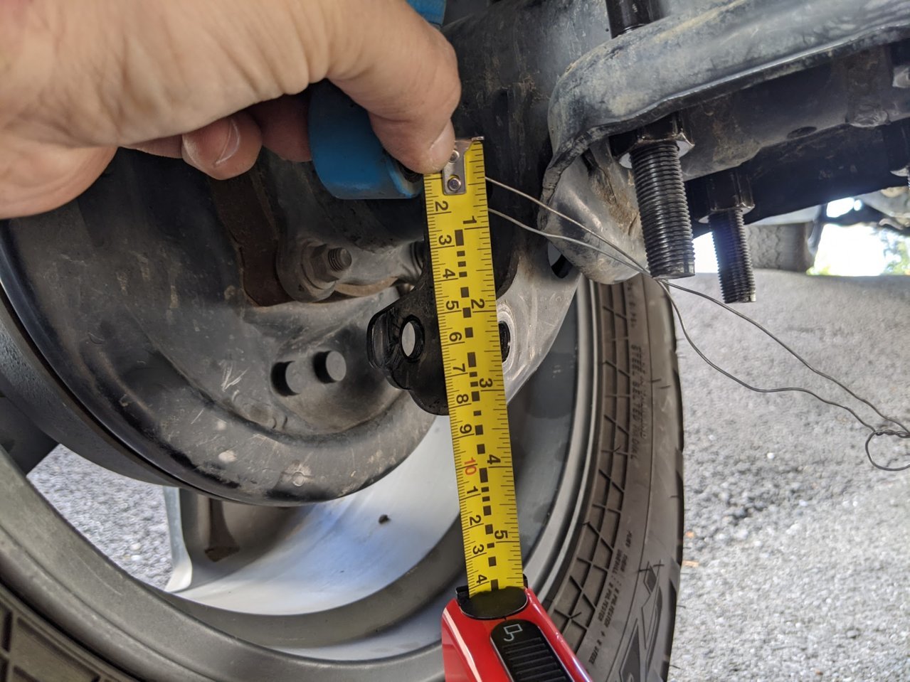

  20. Dec 7, 2021 at 6:55 AM
    #5240
    tonered
    tonered bartheloni
    Sep 25, 2017
    #231055
    31,281
    tony
    Lynnwood, WA
    Yes. The solution is the 5125s (Part Number 33-319070) in the rear. The only caution is that you want to test fit the lower sleeve first. They were too wide for my lower mounts. Instead of doing the right thing and grinding them down, I went Hulk Smash.
