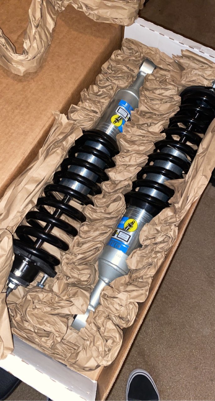

    Just arrived today with 5160’s for rear.

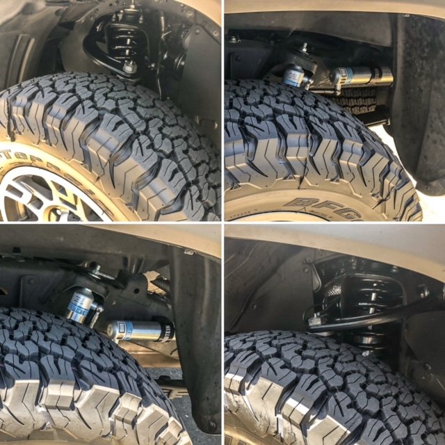

    Question on mounting 5160s-
    I purchased the 5160s and didn’t realize they come with the mounting bracket, so I also purchased the other type of mounting bracket that connects the two shocks like the ones linked below
    https://www.bilsteinlifts.com/shop/...hgKFhKC0yd1nTu3GSSvnen_b3sF2n0ZEaAhTQEALw_wcB
    Is one better than the other? The brackets that came with the kit attach to the frame, and the other brackets connect the two shock bodies. I’m trying to decide if I should just send the other set back, or if mounting them side by side is a better option.
    Any advice is appreciated!

    I prefer attaching to the frame. Have installed both ways. On the frame there is less chance of the reservoir rotating and hitting a leaf spring or Tire. Looks cool either way though!

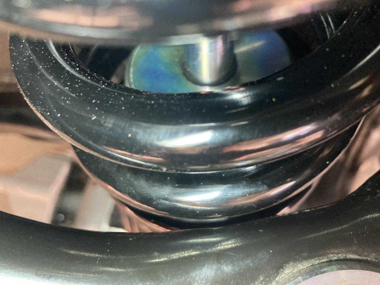

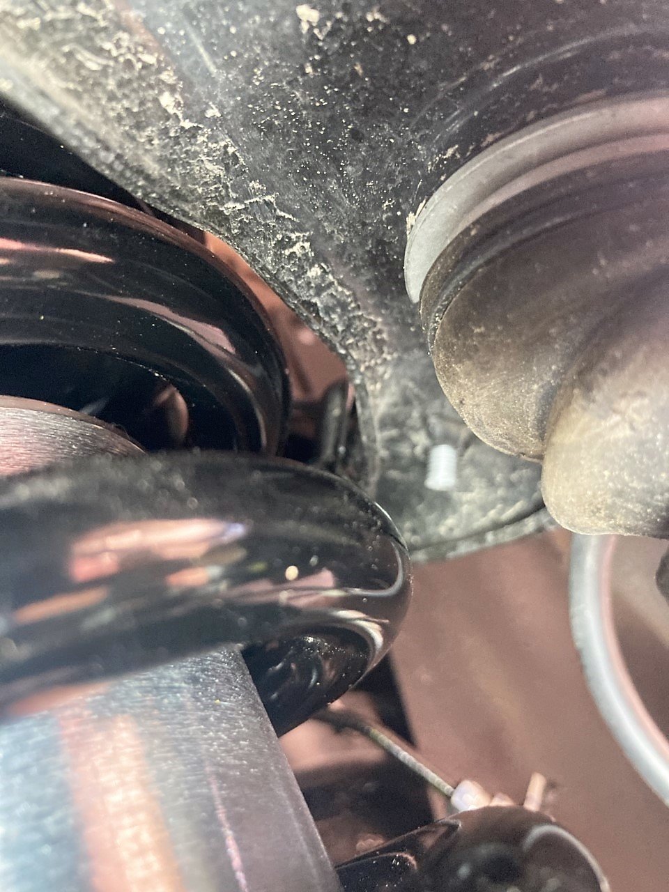

    The front suspension leverage ratio is 2:1
    If you add a 1/2" spacer you will gain 1" of lift.
    If you decide to add spacers above the top hats, make sure you lift the truck and get full front suspension droop and ensure there are no clearance issues with the coil spring and the upper A-arm. The suspension will droop more with a spacer and there is risk of coil spring/upper A-arm contact.
    This was my 3rd gen with clip 5/4 (recommended max by Bilstein) on a AC at full droop
    Edit.. as the lower shock mount drops down it moves slightly in since the lower control arm travels at an arc.. not just straight down. The springs are larger diameter on the 6112s and have more potential to contact the upper control arm when this happens.
