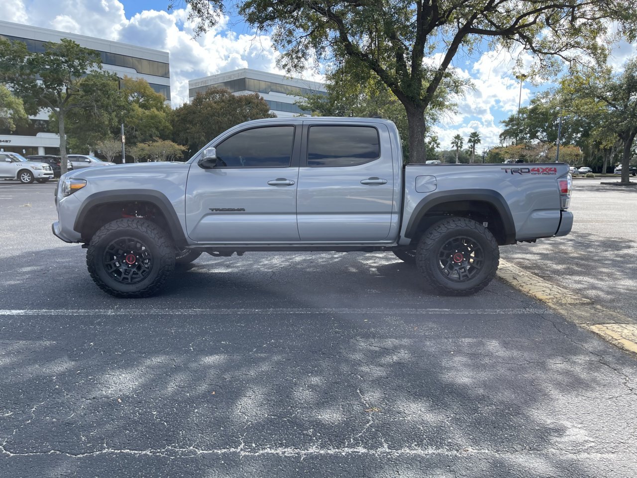

    Maybe someone here can help me out. I currently have 5100s with ome 887 springs in the front and 5100s in the rear with a deaver single aal on my 3rd gen DCSB 4x4. I originally wanted 6112/5160 but they were oos for a while and I ended up just getting the 5100s. Anyways the ride on the 887s imo was a little too soft and I have a ton of brake dive, and to my surprise they sagged pretty bad. I didnt know that was an issue until I researched it after the fact. I want to get 6112s in the front now to replace the 5100/ome, but I want to run the 6112s at 6/5. I saw the 650lb spring offers an additional .5 of lift, but would running the 650lb spring at 6/5 be extremely stiff? I definitely want a more stiff ride. I want the truck to be as level as possible after it settles. I personally dont like rear rake. My question is will the 6112s set at 6/5 with the stock 600lb springs be enough or should I get the 650lb springs set at 6/5? I want as much lift as I can. I also have aftermarket UCAs.

    If you don’t have additional weight up front I would do the 600lb coil. Extra weight with skids/bumpers probably want to do the 650s. I have no extra weight with the 600lb coils set on the 3/4 settings and definitely not a “squishy” ride. I’m sure it only firms up as you go up in the settings

    thanks for the response. i have a bit of ptsd from my current set up. i just really dont want them to sag a bunch and be super bouncy. everytime i brake even at low speeds i have massive nose dive too. i thik after countless hours of research i will just pickup the 600lb springs on 6/5

    5100 rear is meh compared to 5160. You might be mad at yourself for staying with 5100, IMO.
    6112/5160 with 600lb springs set at 6/5 +3AAL (or a full leaf pack) is the way to go with this setup if you want highest lift yet great drivability. Almost zero dive.
