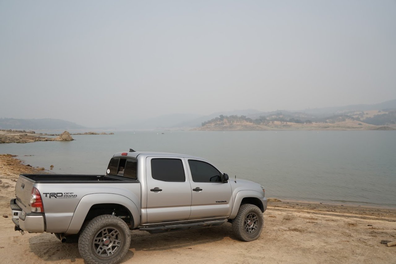

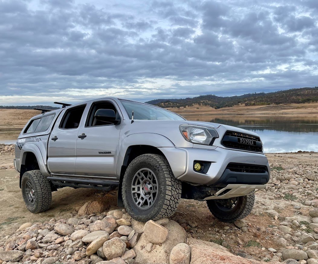

    like previous people said, make sure to get the proper spring rate.
    i had my 6112 on the top clip with 1/4" spacer on drivers side for about 25k miles so far. they are holding up great. only issue i had is the bushing that is on the bottom of the front shocks, the one that the bolt goes thru, it started cracking and tearing a little on my set up.
    what life expectancy do you guys these shocks will go for? i understand its all about how you treat them. but just for the average joe?
    they are great but i just want to go to fox or kings for the different valving. these are a little too stiff for me on washboard roads and the beach. where i spend most of my time off roading.

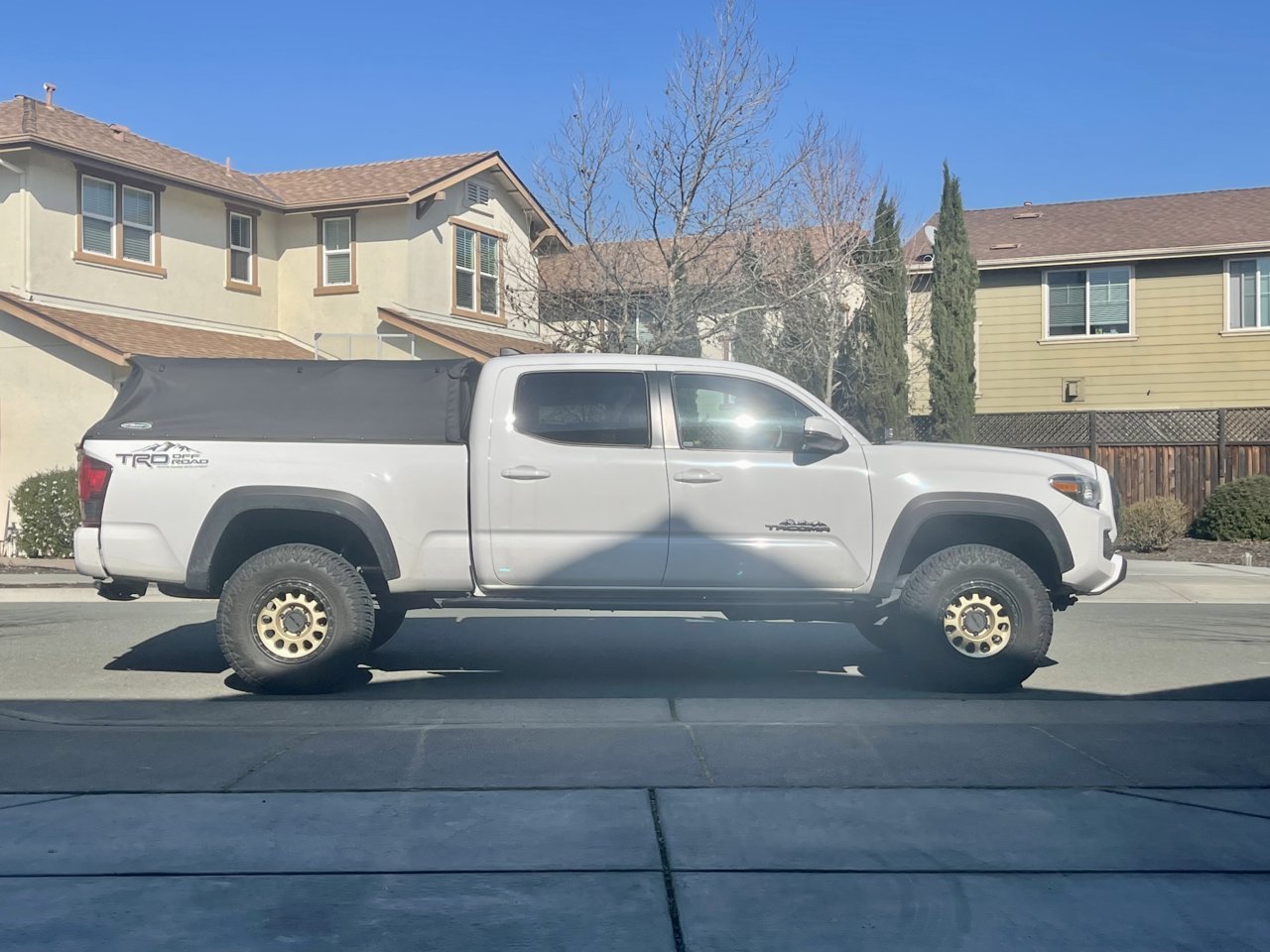

    For me I’m at 6/6 1/4” spacer driver side with full skids and sliders my measurements are ground to fender in level concrete floor shop 37 1/4” front give or take and rear about 38 3/8” Definitely lost close to 1/2” of lift. It drives very nice. Kinda hesitated about upgrading to 650 coils or do I need to? . Currently waiting on leaf pack.

    Bilstein 6112/5160, Icon RXT, BAMF Sliders, Skids, & Hybrid Front Bumper, Warfab Phantom Rear Bumper, & Hitch Skid
    Your truck looks good. Do you have center of hub to fender measurements in the front, or could you tell me your tire size. I am at 21.5" center hub to fender. With the 265/75R16 Duratrac I am at 36.5" ground to fender. This is at 5/4 with 600 lb springs, BAMF sliders with fill plates and full steel skids. About 380 lbs for all the armor. I am considering the 650 lb springs and will definitely need them when I add a front bumper and winch this year.

    I'm at 4/5 with 650 springs and I'm sitting at 22 even hub to fender with sliders and an ifs skid

    Thank you bro appreciate it. I have same thoughts as you. I did order 650 springs the other day. Waiting on rear bumper from RCI and icon rxt leaf pack. My hub to fender front is 22.25” also running 265/75/16. I also plan on front bumper of course LOL Never stops
