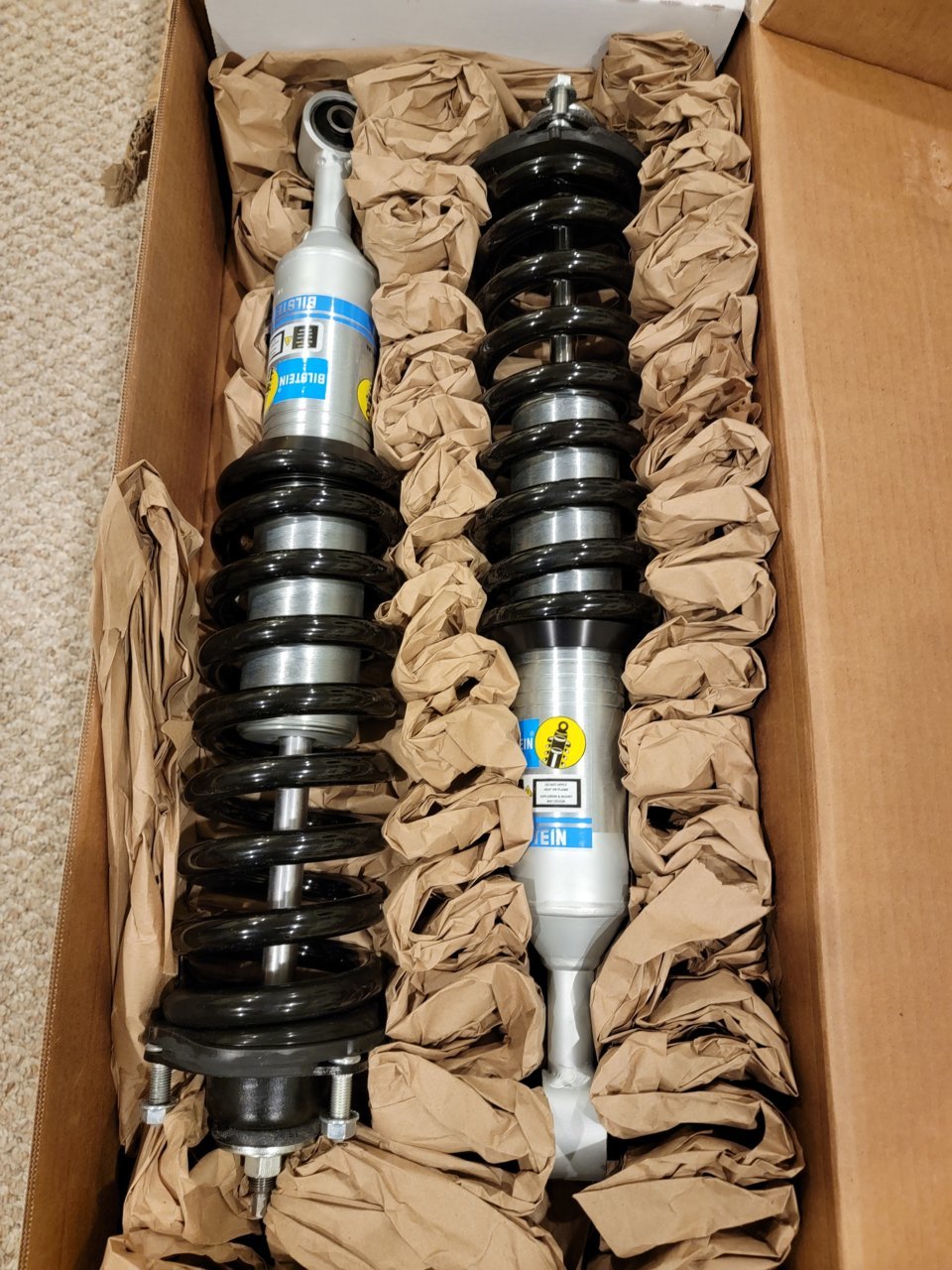

    Getting excited, this came is yesterday.6112.jpg already installed 5160's in the rear. I already have Icon AAL ready for install.
    During install, I am thinking of doing U-Bolt flip. Anything else recommended? This will be my first "lift" 2020 TRD Sport

    Stupid question but from the looks of it, is your spring clips offset for the lean? It looks, in the picture, like you have the one on the left set on the fifth (or so) clip and the one on the right set on the sixth clip. Am I correct in seeing that? If so, obviously remember that the one on the sixth clip will go on the driver side. Other than that, you may want to think about aftermarket upper control arms due to the settings that you currently have on your truck springs. It will bring you very close to the limit of the lift for your factory upper control arms and also give you more articulation as well as more adjustability to put on larger tires with more castor for the alignment. They are not 100% necessary, but highly recommended. Some people go with JBA, some go with SPC, some go with Dirt King with the Delta Joints. Pretty much anyone of those three will work good for you. I personally have the JBA and have never had an issue in the past 3 1/2 years. Doing the U-Bolt Flip kit is very nice to have but not necessarily 100% needed but it also depends upon what you are going to be doing with the truck especially if you are going to be wheeling with it fairly aggressively or if it is just a daily driver with some mild "fire trails." I highly recommend, if you do go with the flip kit, the ones from Archive garage (@ARCHIVE )are absolutely top-notch and it comes with everything that you need. they are extremely comfortable while also maintaining significant support. Do you have the ECGS front driver side bushing to replace your needle bearing? Did you also get the carrier bearing drop from ARB (Not the front diff drop, you will not need that) to help out with possible driveline vibrations?

    Good info, thank you. It is set to 5/4 clips. I did not get the ECGS or carrier bearing drop. I am going for 2" lift. I will look into that. Great info!
    The reason for the U-Bolt flip thinking is, I will be there anyway doing the AAL.
    Hoping this isn't going to be too complicated.

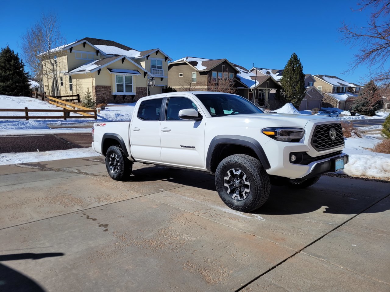

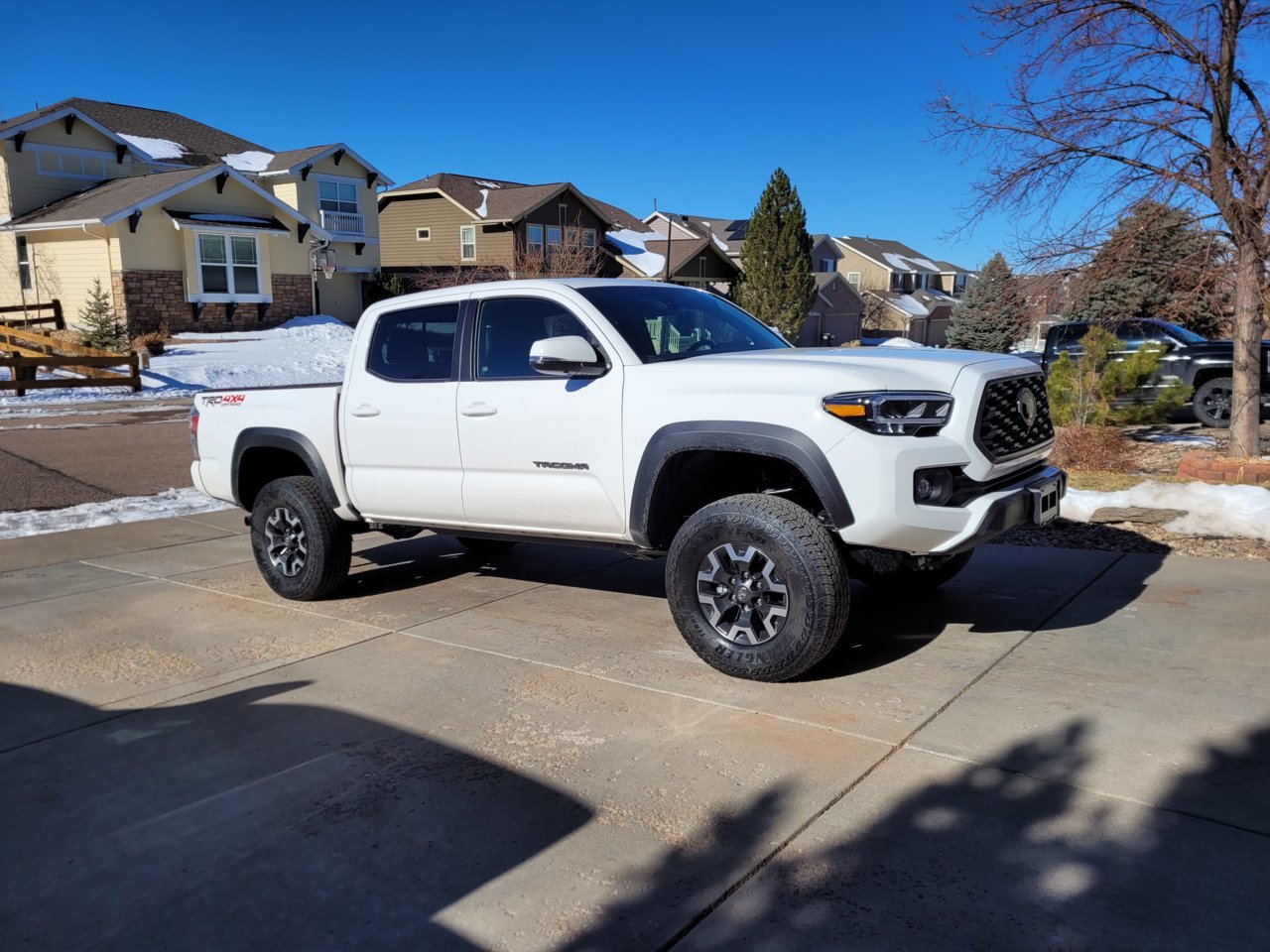

    Hey Guys - Just got done installing 6112/5100 combo yesterday, I did 4/5 setting with a 3/8 spacer front and 1.5 inch single AAL and a 1/2 inch block on rear. Before and after hub to flare measurements below:
    DF 20.5 to 22.75
    PF 21 to 23
    DR 21.5 to 23.5
    PR 22 to 23.75

    Looks really good. How's your ride?

    Not bad but haven't driven much just around for 5 min last night after I got done, the alignment is off pretty good so not going to drive it much. Wheels come in today then will have them installed with 285/70/17's tomorrow with alighnment and will report back ride after that.
    33yrsoftoys[QUOTED] likes this.
